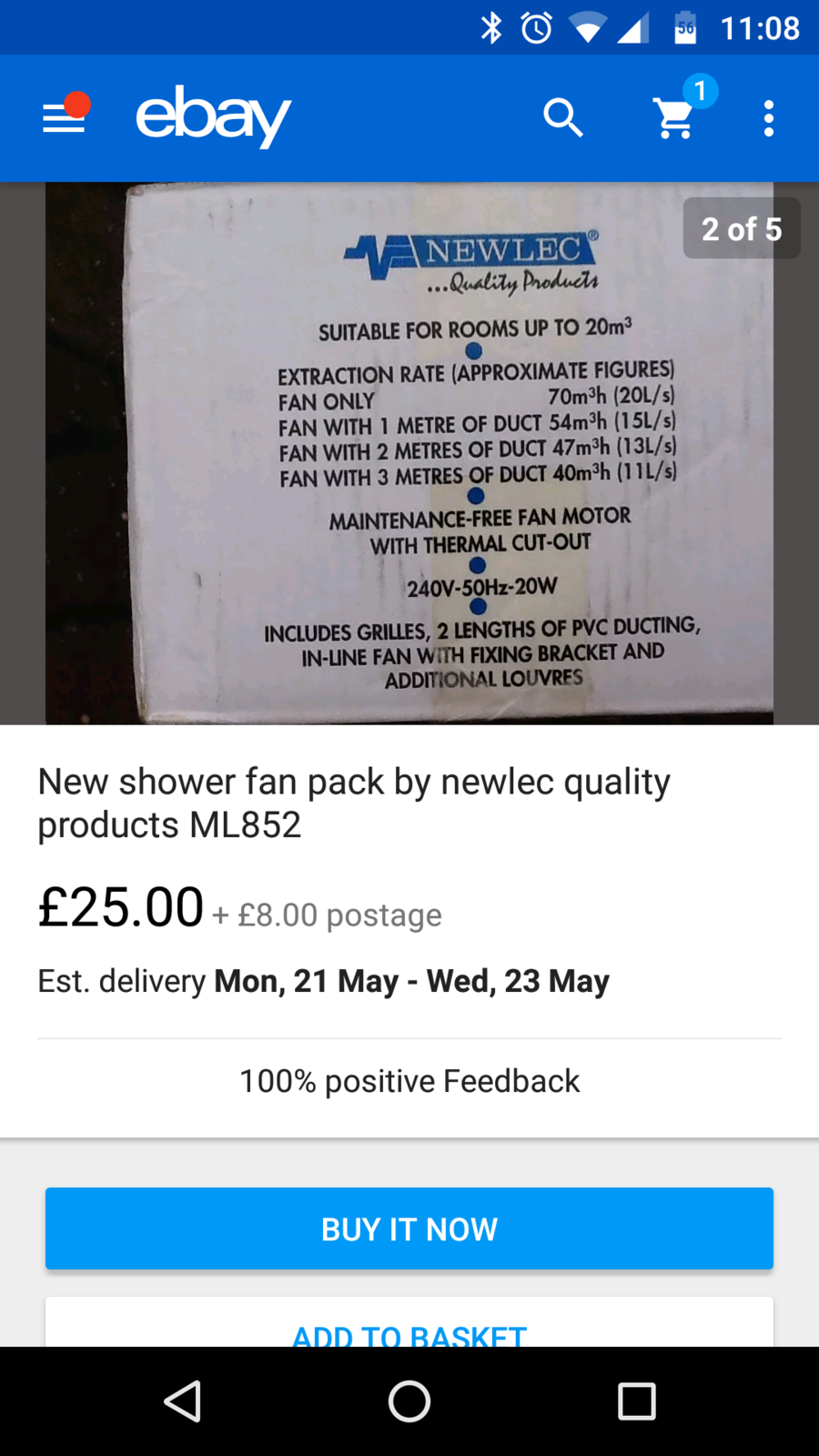

Thanks, I'm on a tight budget and fan will be up in loft so noise not an issue. I found this while browsing on eBay and thought it was quite simple and informative for others who are interested in the affect of ducting length:
Looks like each metre of (flexible) ducting reduces the extraction rate by 2 l/second so with my proposed set up it ain't going to suck much out! I'm now thinking to try just terminating in the (well ventilated) loft which is 3m up (it's just dry ''toilet" air rather than heavy moist shower air).
