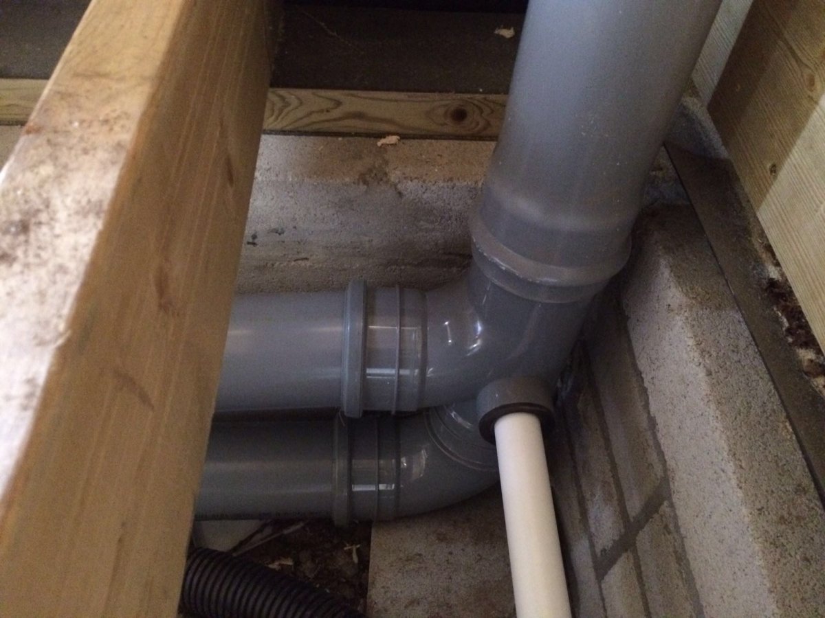

Yep all sorted on that front thank you. Just another quickie - is it ok to mount a 110mm swept tee upside down? Why would I do this you ask - please see pic. The plan is to come off for the air vent pipe and also the toilet soil pipe.

Not ideal! You'll get build up, over time, on the sharp lip of the upside down T. You could use m&f 135's to get the drop!
