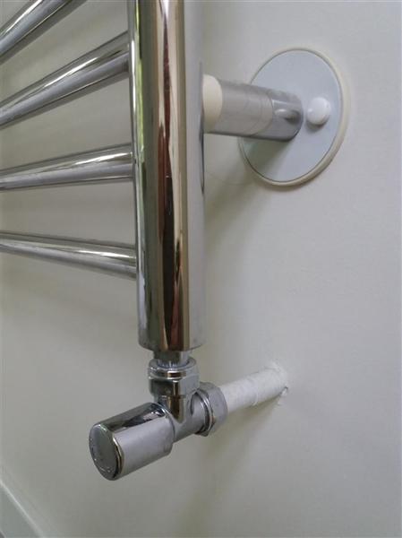

When I built the house, I installed a towel rail in the en-suite bathroom, heated by water via the UFH system. It works well in the winter months, but in summer, it is or course off, and the towels remain damp.
The solution is to install an electric dual fuel element which I would run via a timer.

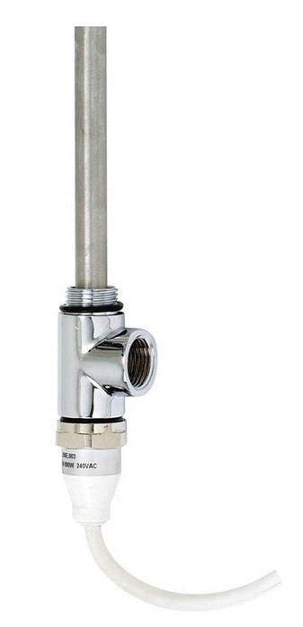

But I am confused; all elements I see on the internet have a three way angle fitting, and the photos show the water flow off-set from the towel rail. My flow (and return) is from the bottom of the rail (see photo) and I cannot see how an element can be fitted without realigning the entire towel rail fitting on the wall.
Is it possible to fit an element into my towel rail without having to refit it and/or re-plumb anything? Basically, I cannot see how this element (as a typical example) will fit my existing rail.
Second question; as the photo, there is a lock-shield valve at each end but those will not stop water within the rail flowing out. As the UFH is below the valve, are these necessary?

My confusing arises because my current rail has a compression fitting to the 15mm pipe and presumably just a washer compressing onto the fitting to the towel rail. But the element photo has no facility for a 15mm compression.

You need to use one of these
th
Take the compression nut off the fitting, fit the non compression end into the element tapping with some tape and then the other end will fit the compression nut and olive that's already on the pipe, if there's play on the pipe to move into the wall, that'll help with any length offset.
Or if there's no play then take the old nut and olive off, cut the pipe to suit and then fit the new one.

Probably not, you would be removing the tail from the rad as well as removing the valve. Only issue of course is you wouldn't have a means of isolation but that can be worked around if ever having to remove the rad, say isolate via that loop on the manifold.
You may be correct, but....
If you look a the photo of the existing rail, there is a short, screw-in tail coming out of the rail that fits the valve. Looking at the example image of the element. if the element is screwed directly into the bottom of the rail, I don't think the centre for the 15mmm will align.
The other little issue is that when it was installed, thee was insufficient 15mm protruding from the wall. I had to solder a slightly longer section on with a joiner; you can just see it in the photo. With my luck, I will have to reduce the length of the protruding 15mm and due to the joiner, will not be able to fit your suggested part. But I may be wrong.

You couldn't screw the element into the valve tail that is fitted into the bottom of the rail. That needs to come out as in @denso13 's pic. You could get a small 3/4" male to female coupler that would fit in it's place and then the element can fit into that to allow the side tapping to drop to the level of the pipe from the wall.
