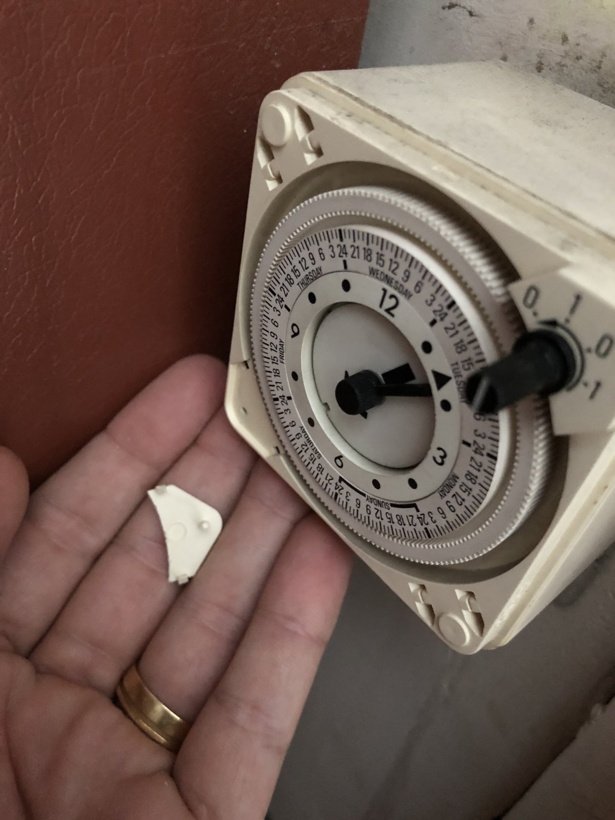

I just moved in to a flat that has a TRAC T 45 installed that controls the boiler. I already looked online on how to configure it, but couldn't find anything.
Can anyone here help me? I am attaching some pictures that I took from it.
Many thanks in advance.
I haven't seen one of those for some time. I think you seem to be missing the operating pins. They clip onto the serrated outer rim to select the on / off times for each day and as they pass under the black wheel, there is a cog that they catch on and click it between '0' and '1' to switch the heating on and off. Is the little triangle bottom left a storage compartment for them.
Hi stem, thanks for your reply.
Yeah, I thought about that little triangle being something of interest, but it is just a plastic piece that covers more plastic:
I also tried to move the outer ring with a Philips screwdriver, but to no avail.
OK, sorry I thought you might strike lucky.
The outer ring is fixed, probably moulded as a single part with the casing. The pegs fit over it and are held in place by the slots.......or they would be if you had them.
A new timer will probably be in order. You don't say if you have bought the property or are renting it. If the latter, then it will be a job for the landlord.
