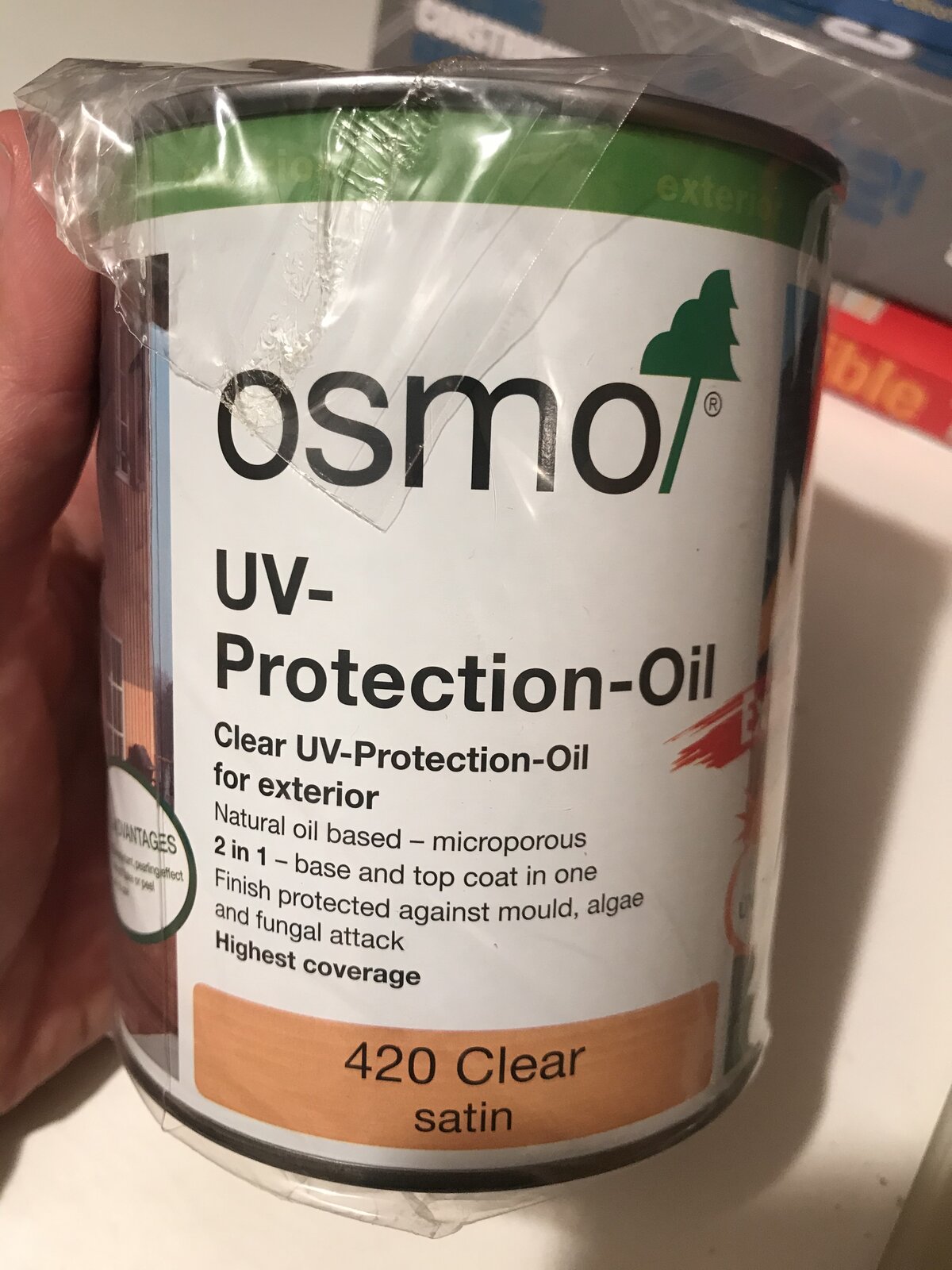

I may have asked this before but her goes.
I am just about to install some Siberian Larch Cladding on a workshop in my garden.
To prevent the wood from silvering over time I would like to treat it if at all possible with a clear UV protection.
What products could / should I use?
Many thanks

I use boiled Linseed oil on my shiplap cladding. Seems fine.
Osma oil is probably the best out there. Use the "extra" version for the longest UV protection between coats - 3-5 years
Cheers for the replies, Coincidentally I had already purchased the Osmo extra after being recommended elsewhere.
Woody at one point did you apply yours? Pre- installation or post, if it was after installation, what kind of timescale between installation and coating?
cheers again

Any clear coating, osma, danish oil etc will not provide much protection.
Coatings without any pigment will get broken down by UV quickly. So any sides that get much sunshine will get the coating burnt off in prob 6 months. If left the sunlight will kill off the lignin and the wood will start to go grey.
Siberian Larch is naturally very durable, it has high tannin and resin levels and it has the density of oak. It will last many years without any surface treatment, however it will go patchy visually, areas in the shade will retain their original colour but exposed areas will go grey and get water stained.
If you want to keep the original colour as long as possible I would simply treat with a clear wood preservative that has water repellant in it. Barratine coatings are good and I think do a clear, they are available in toolstation.
cheers again
I treated mine the recommended coats front and back before installation. Much easier, plus I could make sure the end grains were property sealed.
Once dry ( a couple of days) I fitted them.
almost certainly massively increased lifespan and reduced movement.
It makes me cringe when I see site chippies putting up softwood fascias, bargeboards etc totally unfinished, then left in the rain for a few weeks until the painters turn up.
Ok.... So say for instance, the cladding was installed before being coated, and left untreated for say 6 weeks, what would then be the best plan of attack, to treat and try a retain the look before slivering occurs, asking for a friend!
Get a coating of your choice of protection on now.
Autumn is the best time for coating and before the damp weather comes. But you'll need a period of dry days and dry timber.
Then check it next spring to see if it has any exposed edges after a little shrinkage.
