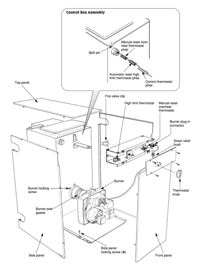

The only water temperature control I know about is a knob on the front of the boiler, which is not calibrated in degrees. I will try to upload a diagram with this post.
At this point I'm having difficulty formulating a precise question for you. My aim is to safely stop the boiler from delivering any heat to the tank and just sending it round the rads. So rather than repairing the tank sensor, I would rather set the system so that the boiler thinks that the water is up to temperature and it just feeds its energy to the radiators.

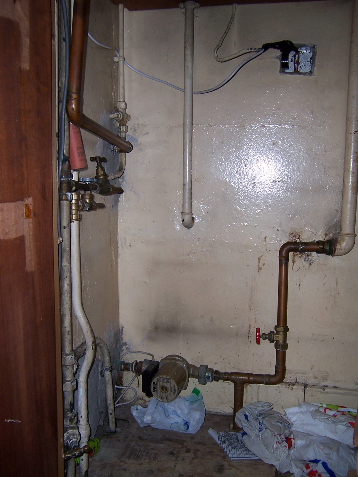

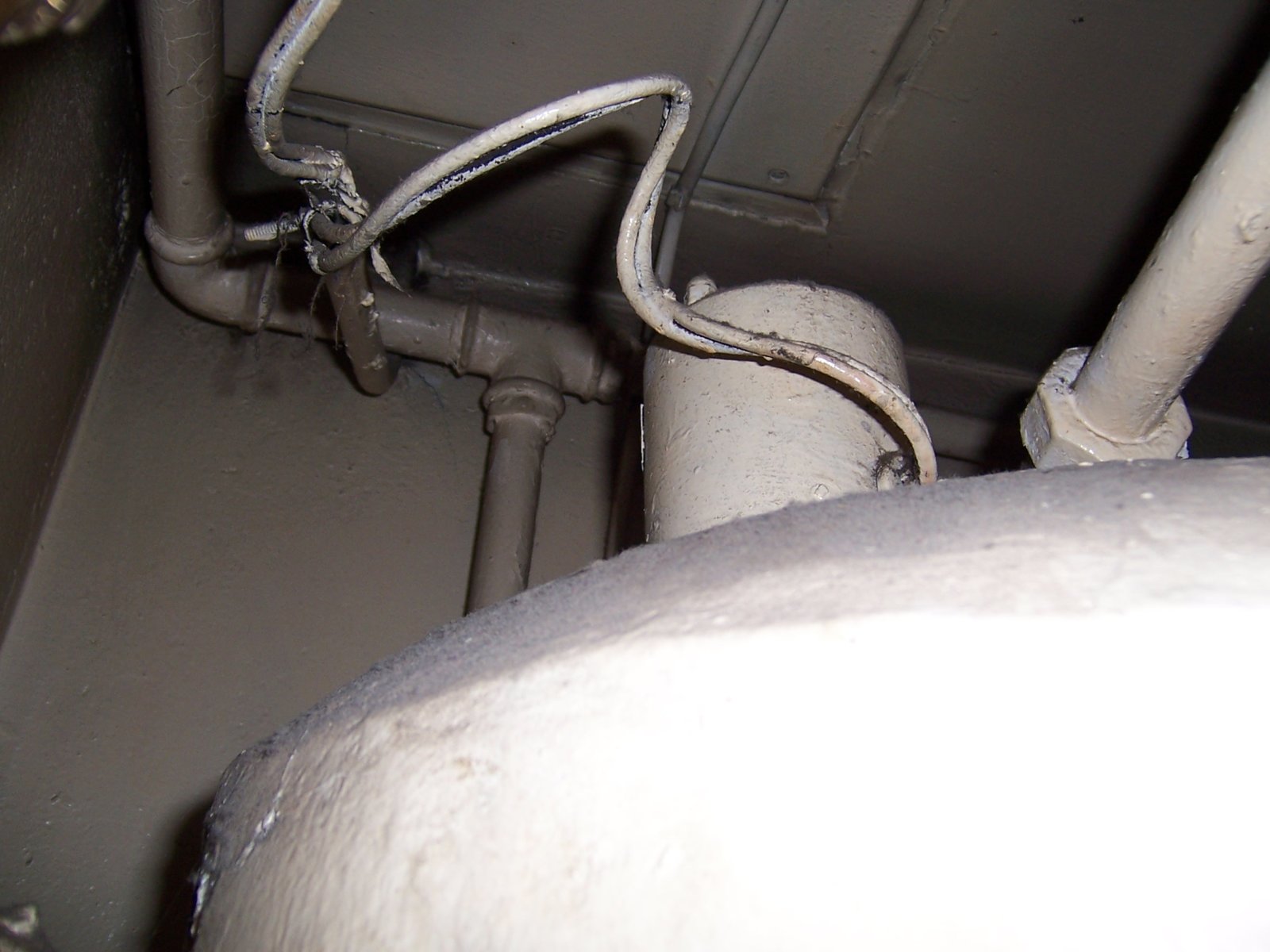

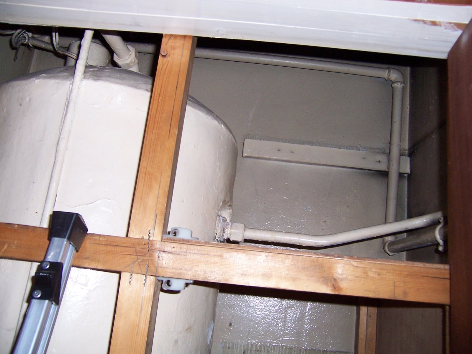

If the system is from the 70s it might be gravity feed on the hot water side (ie whenever the boiler runs the hot water cylinder gets heat). Might be seen as a nuisance but it has some benefits (no pump noise cos thermionic syphon, no need for expensive complex bypass valves to maintain flow rate in the system).
If you haven't found a cylinder stat (and there is no sign of any wiring for one) then that would explain why the tapwater is spanking hot- whenever the timeswitch is set to hot water the boiler runs until it hits its internal thermostat limit (prob 80 or 85 degrees C)
That diagram isn't very useful- what would be more helpful are pictures of the timeclock and of any plumbing arrangements near the boiler and hot water cylinder (3 port valves, zone valves, any sort of stuff like that)
The thermostat on the front of the boiler sets the maximum temperature that the boiler achieves- an elderly oilburner like that won't be modulating the burn so if the heat demand is small (ie only a couple of radiators) it will achieve its internal temperature quite quickly and shut down (despite the timeclock/room stat being active) until circulation through the system cools it to below that setpoint when it will fire up again.
If that thermostat is set too low then the boiler will be prone to cycling on and off while it brings the house up to temperature- this is inefficient, you may get a better result from setting that thermostat higher. There are internal thermal fuses to prevent dangerous temperatures being achieved

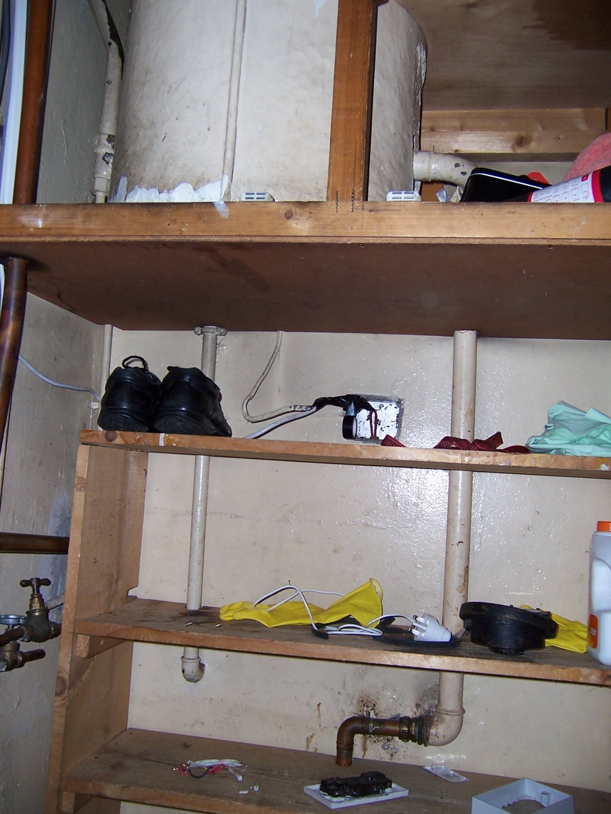

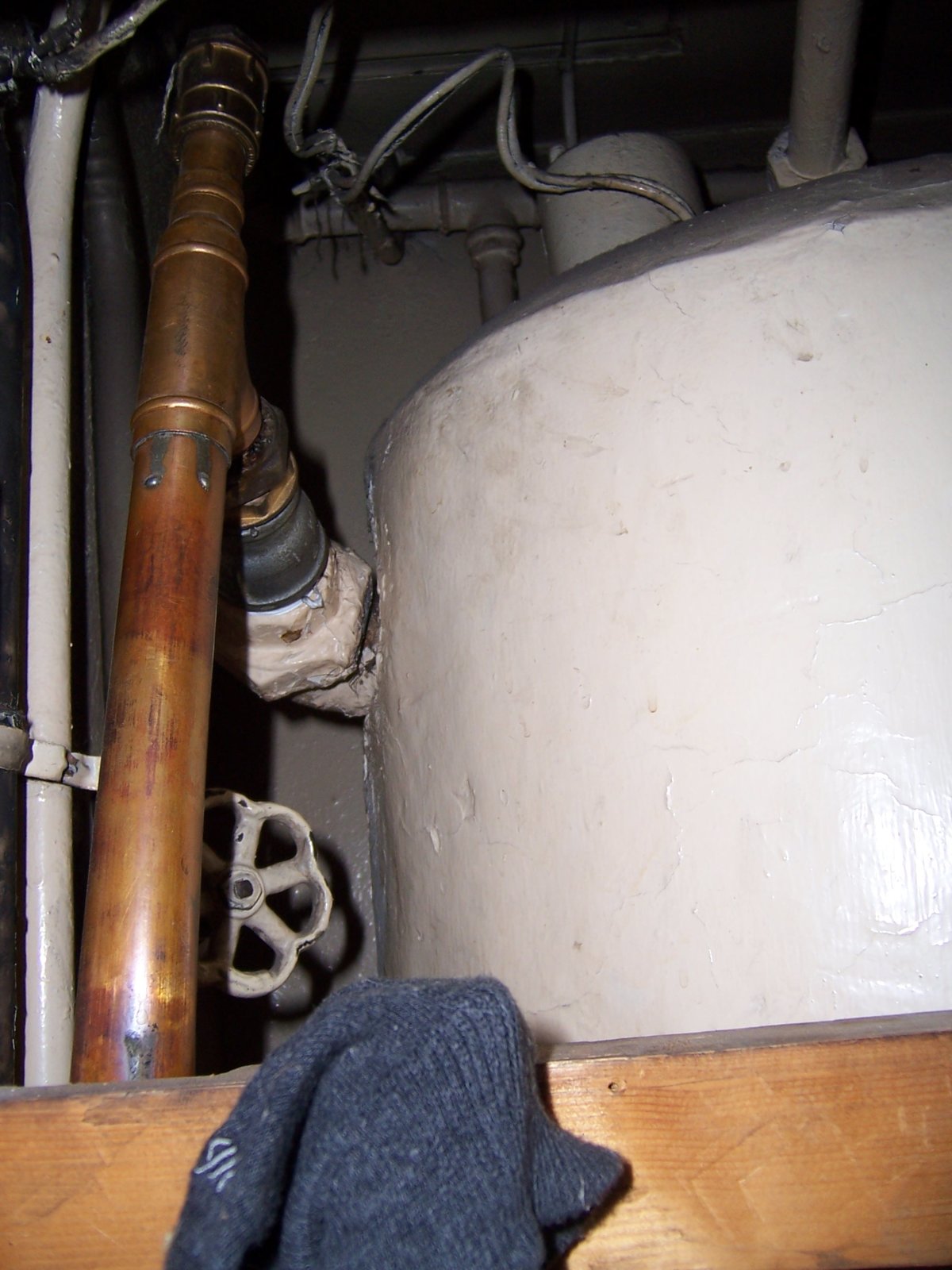

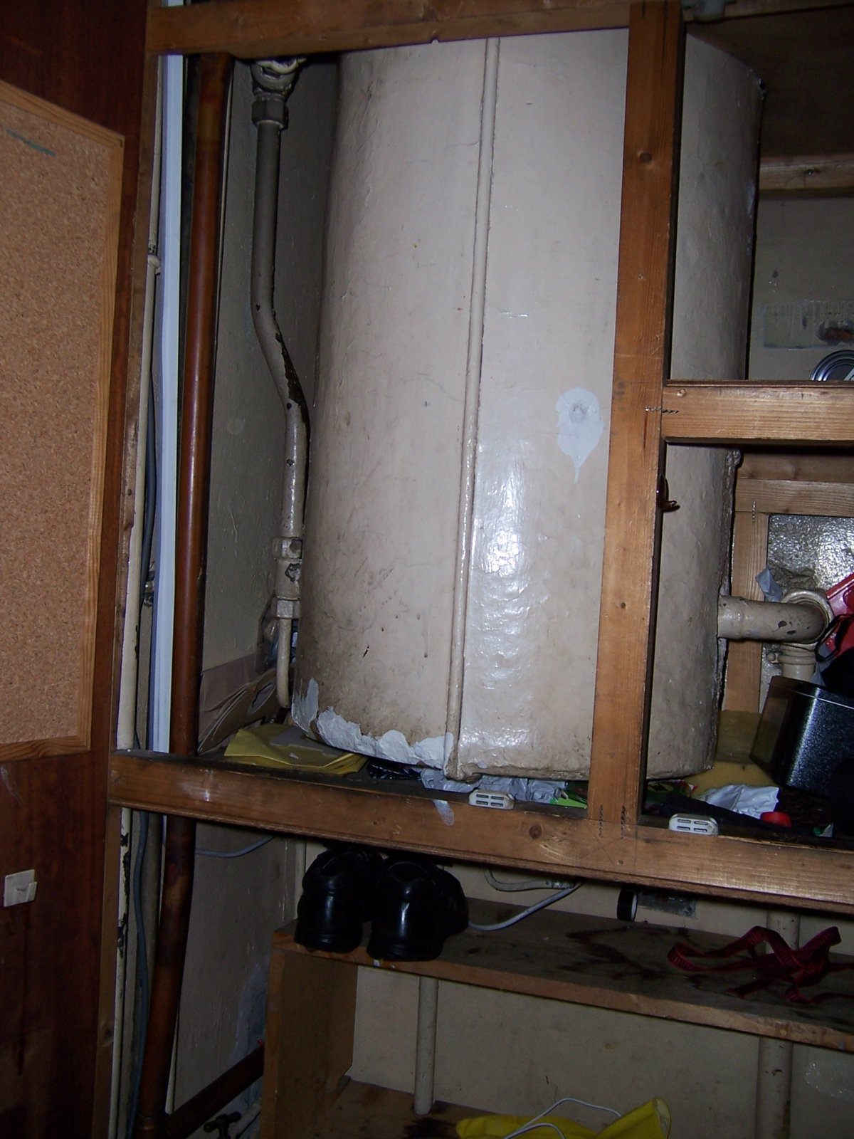

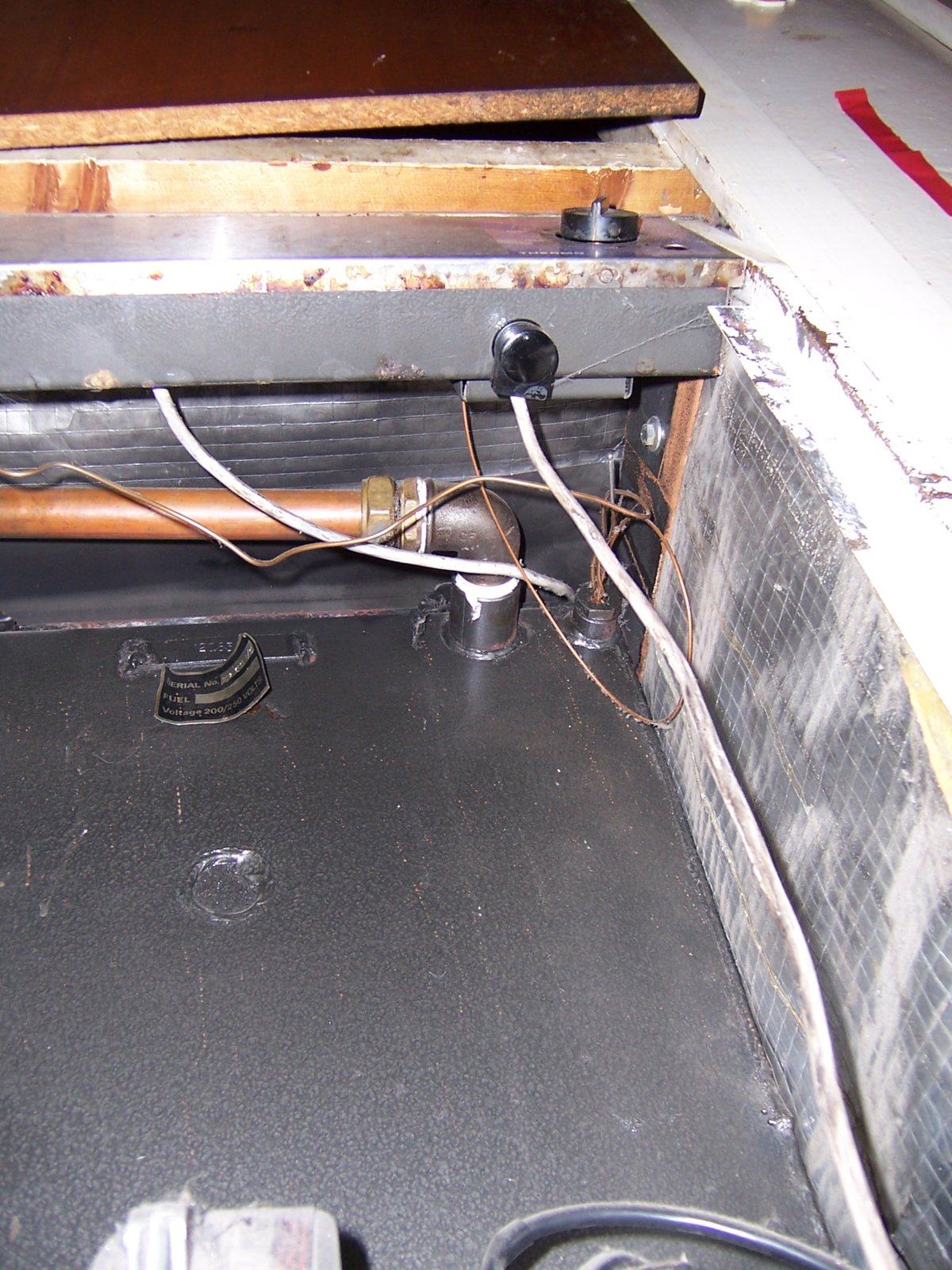

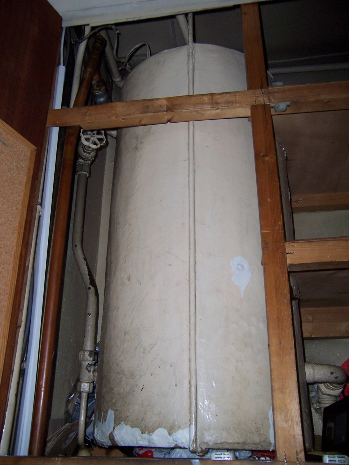

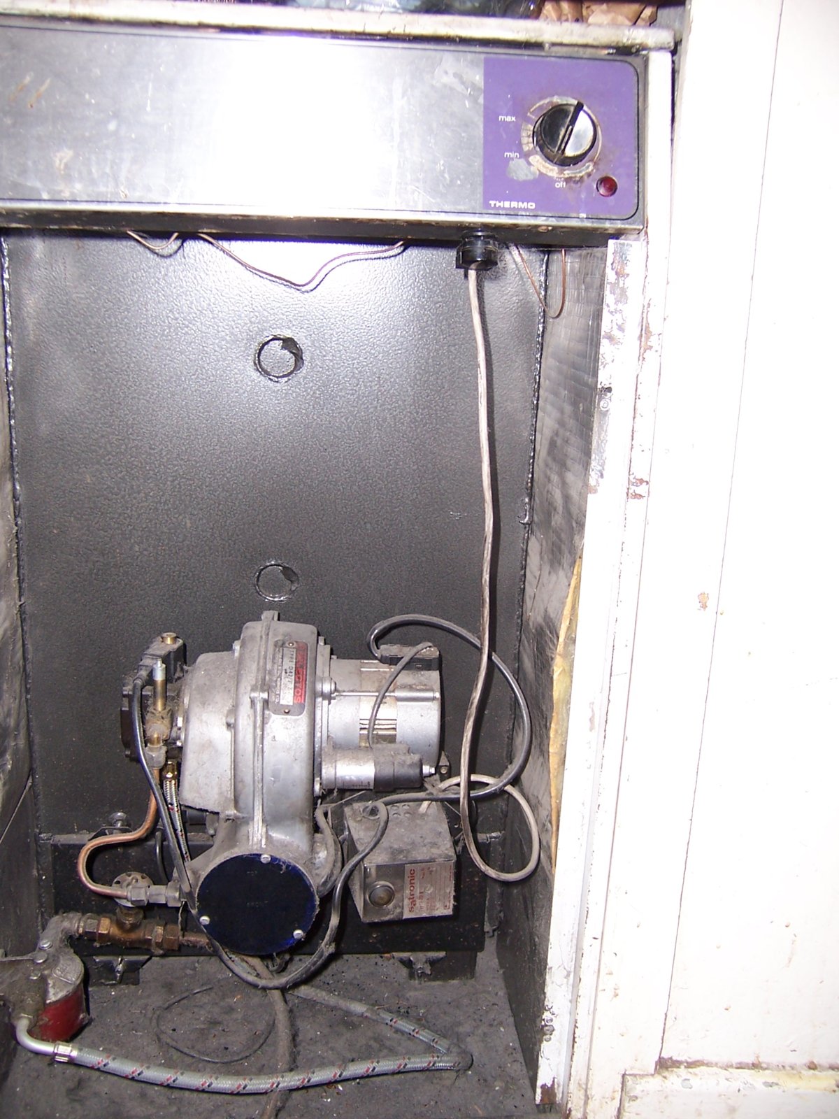

Gasbanni, I think you are exactly right. But I've got the bit between my teeth now and I want to understand this old system better. I have photos: a real feast for those that like a puzzle. Please don't comment on the exposed wiring, I know all about it. Anyway, the original question was how do I set the system to heat the rads without heating the tank. The system is a mystery to me. For example I don't see a motorised valve anywhere and the pump runs constantly, even when the room thermostat for the heating has cut out and the boiler is not firing (ie the hot water must be up to temp.). Also, the cylinder has 2 pipes on the bottom and 3 on the top. If anyone can talk me through the functionality of all the pipes I would be most grateful.
