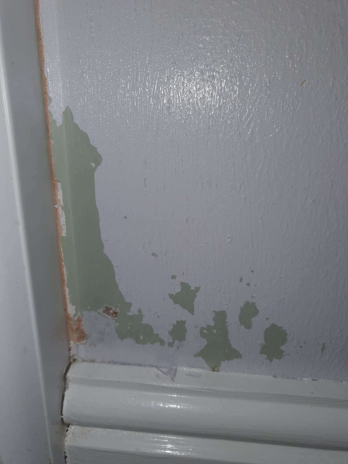

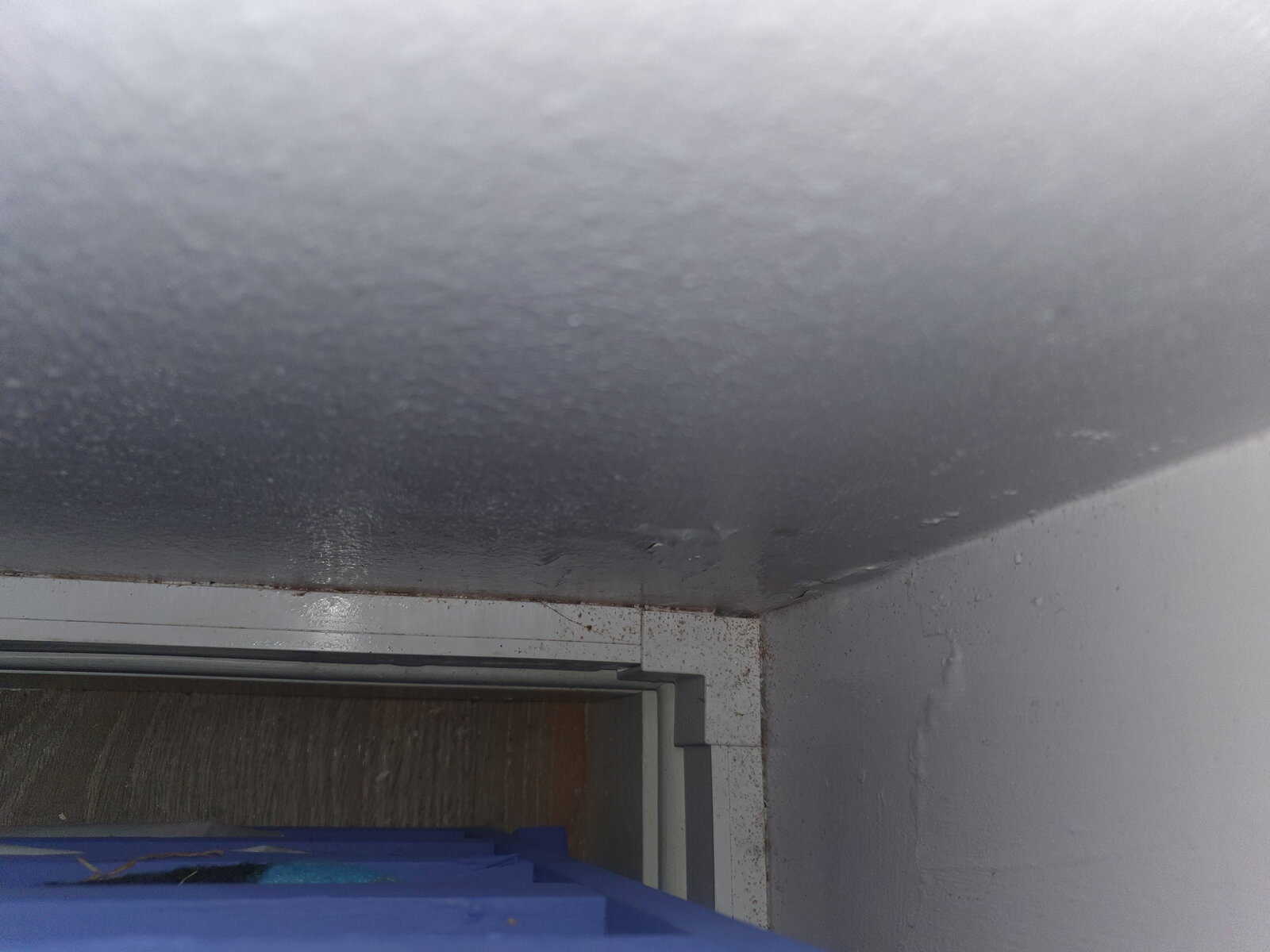

Our utility room is polycarb roof, single skin brick, foam backed plasterboard. Like polystyrene stuff. Anyway at the bottom of the wall especially on the north facing side we are getting bubbling paint. Its condensation. If I open the back door it drys out no problem
So we are having our back door replaced. I was wondering is a trickle vent worth it and would it make much difference or would I be better off getting a dehumidifier for the winter months. I'm more bothered about noise intrusion and heat loss. Plus we want a composite and we cant get a trickle vent in composite. I know most window companies arent keen on trickle vents. It's only a problem like from November to february

There are no windows. It's a polycarb roof and the door. The roof let's all the light in. And its condensation on the walls at the bottom above the skirts causing paint to bubble. When I've left the back door open slightly the damp and cold walls have dried out so its definitely condensation. I'm wondering what a decent solution would be during the winter months. It's either dehumidifier or would an extract fan that comes on when lights are on be the answer?
No, it probably isn't.
Water vapour is lighter than air so it tends to rise to the highest parts of the room.
Condensation lies on the surface of the wall, it does not emerge behind the paint and push it off.
To check, tape a piece of clear plastic tightly to the wall. If water appears behind the plastic, on the wall side, the water is coming from the wall. If it forms on the room side it's condensation.
After you have confirmed that you have a wet wall, consider where the water is coming from. Typically if the floor is concrete, it will be coming from below, often a plumbing or drain leak. It might be from water on the outside of the wall, such as a drain leak, spilling gutter or bridged DPC.
Photos of the wet wall, inside and out, will be informative.
BTW, cold outdoor air holds less water than warm indoor air, so it does not cause condensation inside a house.

I have mini trunking running around the bottom and it's damp on top of that. Behind I couldn't tell you. Is the paint bubbling because condensation is forming on top. Over time forming cracks then its getting underneath it. I scraped the bubbling paint off. It also was bone dry behind the paint once it had come off. It felt very cold to the touch but wasnt damp in any way
