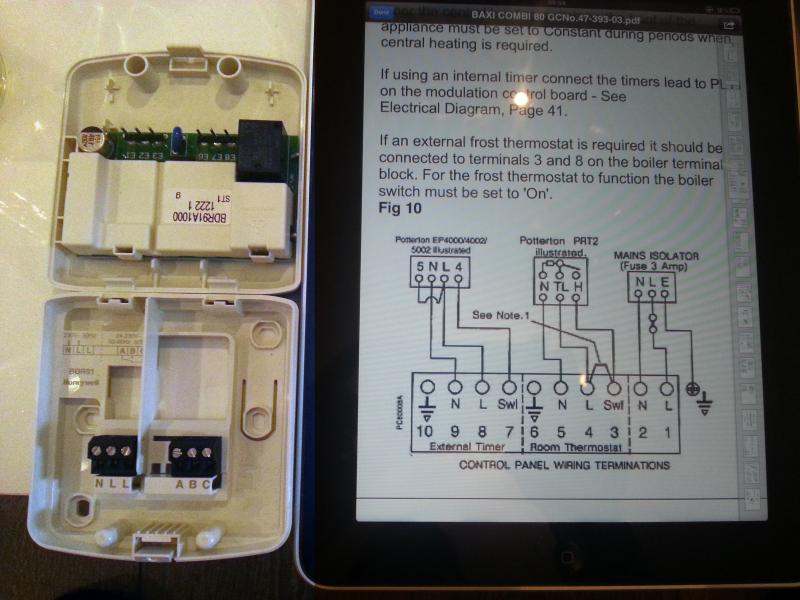

If the OP is thinking of a programmable stat, it's not quite as simple as that for the OP's boiler. ;)
The internal time-switch must be disconnected from PL11 on the control board and the prog stat connected to 7 and 8 on the terminal block.
The existing stat will be connected to 3 and 4 on the terminal block. This must be disconnected and a link inserted in its place.
These changes are required to allow the internal frost stat to work.

Ok, so I got the stat and i have the boiler 'face' off.. I can see the main board where I need to install/attach the stat to but Im getting a little confused. I have attached an image with the board layout and stat opened up.
Im reading the manual and just getting confused, added with the info in the above posts. Im just not sure so I wanted to get some advice from you guys.
Could someone draw some lines for me for what bit on the board attaches to what bit on the stat?
see http://imgur.com/qheFp or
