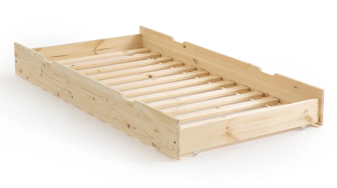

Trundle bed: Buy or Diy?

At about £112 it's not bad value, but I don't like the casters, they look like they'll give up early. Looks a very simple build though. I haven't priced the timber yet.
Figure the cost of materials, plus time. Probably cheaper to buy it unless you have a decent set of tools to speed cutting.
Buy that one and add vertical 2" x 2" blocks into the corners, (and maybe one each side at the centre for extra stability), and fit your own selection of castor. The ones fitted look like single direction fittings. You could fit swivel ones to help with manoeuvring.
Here's a budget version:

Two possible configurations for slats I've seen on other beds in our house:
90mm x 20mm cross section, 900mm length, 10 off
45mm x 18mm cross section, 900mm length, 18 off
Looking again at Wickes, the 18mm x 44mm x 1.8m
would yield the right lengths for a single bed with 900mm mattress width
So this would be the biggest cost: 9 of these two make 18 x 900mm lengths,
Total: £30.60
I tried to find the larger size (90 x 20mm) but that was resulting in more wastage and even needing fewer it worked out at least a tenner more.
Grand total £44.83
That would give something very minimal. But the reason for doing this in the first place is satisfied, namely to get the mattress we keep for visitors off the ground (to air it) and on wheels so it can roll under something else. It might be nice to add a front to cover any made-up bedding when it's put away, could perhaps get away with sanded, painted ply at a pinch.
Interested in opinions about this. Using studs may sound a little crude, but having tested studs on their end over their full span and jumping up and down on them they don't seem to deflect much.
EDIT: Yes, I do have reasonable tools, including a chop-saw, plunge saw just need to wait for good weather as no space inside.

63mm means you will have around 10mm lip above the slats and 10mm below the supporting baton underneath do you not require any sides at all??
also you would need extra castors/support mid length or at least 89cls
also 94mm slats are far stronger than twice as many 44mm
also the head or the sides off the frame must be at least 76mm longer to form an external but jointed frame or both 76mm longer iff a mitred frame
although if the frame is under the slats you remove the need for batons and the frame can be narrower by perhaps 3 or 4 inches each side
That's a good point. Chat GPT says 1900mm C16 63cls with 80Kg UDL will deflect 8mm and with 89 cls, it'll deflect 5mm. That's worst case assuming someone rolls to an edge, mostly they'll sleep in the middle. But all I have to do is move those casters 10cm towards the middle and the 63cls deflection drops to 3mm with the 63cls, so that would mitigate somewhat.

No, I didn't ask for a timber floor, I was only interested in single beam deflection. I also tried 100Kg point load. I've worked with 63cls for a long time and know what it can do. If you managed to snap one jumping up and down on it how much do you weigh? I watched a plasterer using a couple flat, almost full length as a platform support and I admit I was a little apprehensive about it but even that didn't break. For this application (temporary bed) they'll be fine.

general comments if you supply support to the floor half side length you can reduce side timbers by perhaps 60-70% as the unsupported span is half
