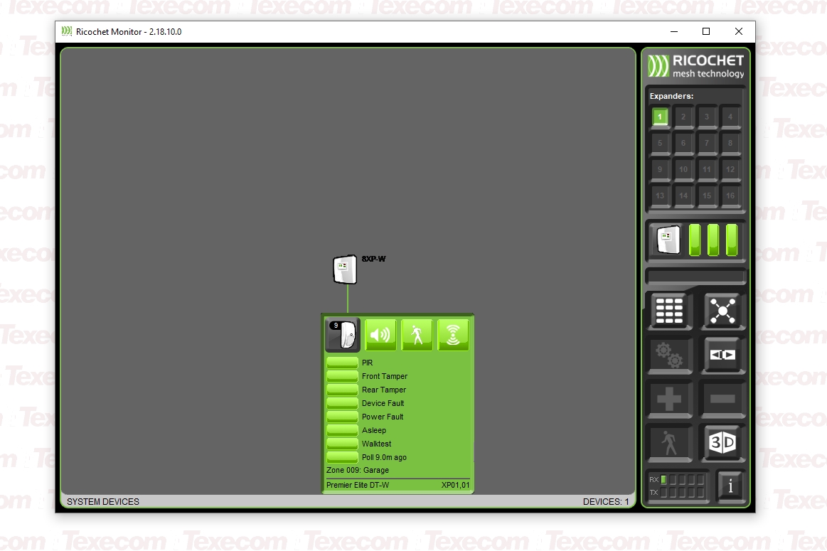

@secureiam yes there are 4 out of 5 bars of signal when moved to the garage and 5 out of 5 when inside the house.
See screenshot. I'll redo the mesh, and tamper the device in the Garage as suggested, take off the mesh and report back.
Also is it normal not to have the "walk test", "settings" and "+ & -" icons in Ricochet Monitor working ? They are all greyed out as you can see in the screenshot.

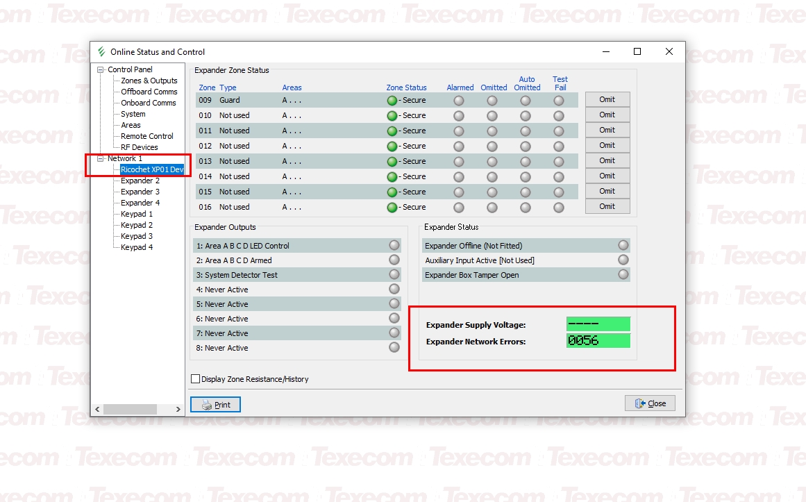

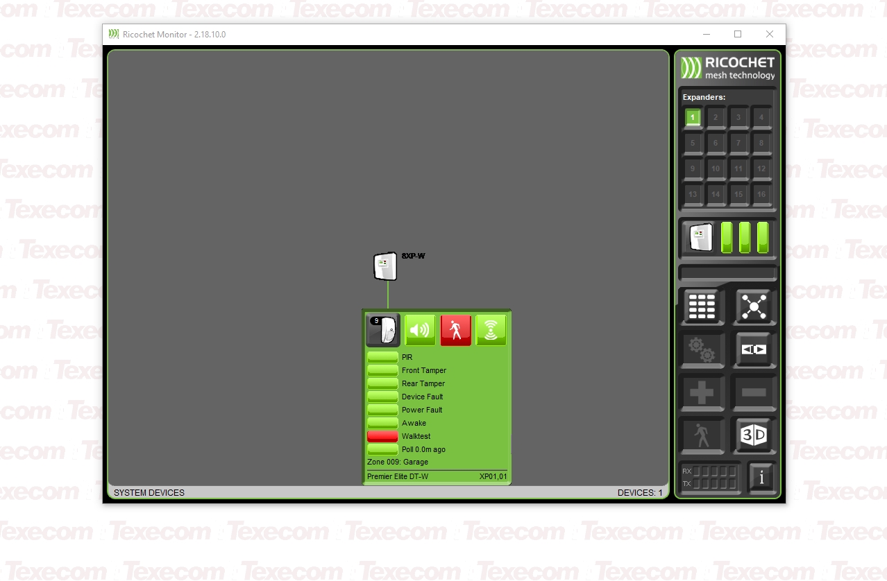

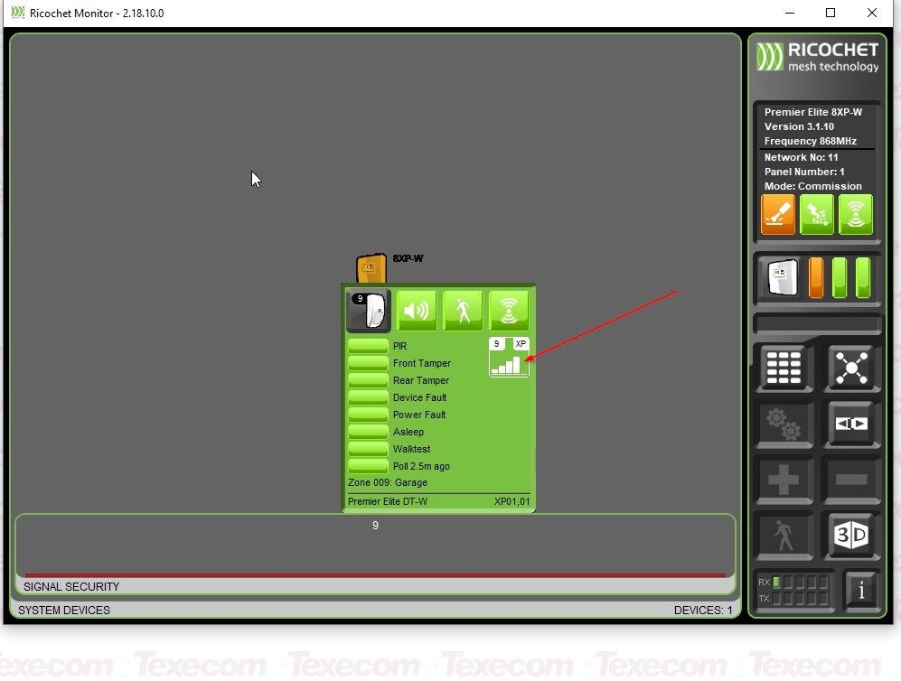

A few things I noticed (see screenshots attached):
1. It looks like the signal is only displayed when the 8XP-W is in commission mode.
2. Although ricochet monitor indicates the PIR has detected a walk test in progress, there is nothing registered aginst zone but all opther wired PIRs register the walk test.
3. Expander has no "supply voltage" reading in Ricochet Monitor but N"etwork Errors" shows 0056

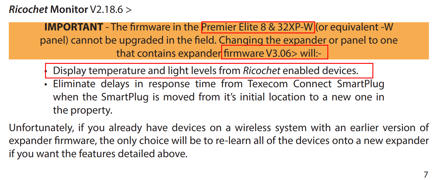

I must mention, this is only aplicable to Texe 8XP-W and 32XP-W Expanders with firmware V3.06 and above.
Seee screenshot below:
