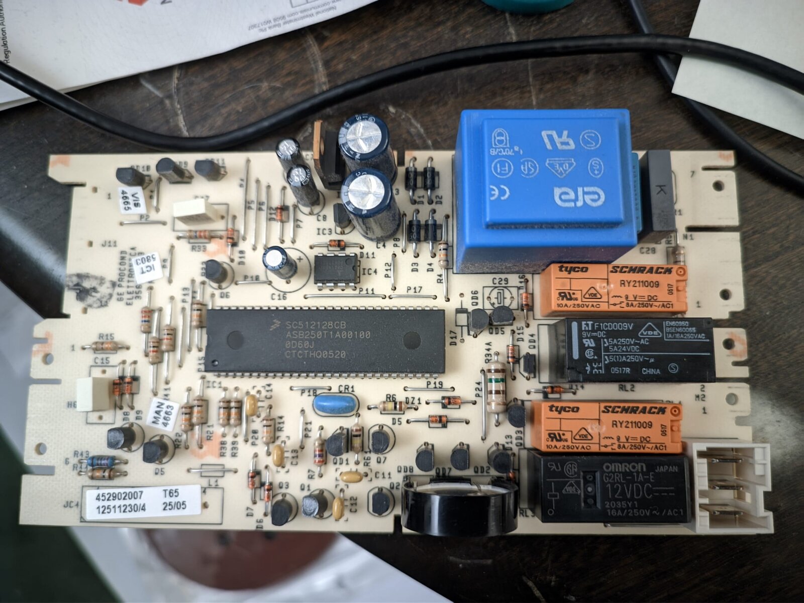

From the attached diagram, it looks like live goes via the main switch and the door switch, then to the motor, and then to the heater. Neutal goes to P-2 on the main controller board, then the two elements in the heater are controlled from there by completing the circuit via P-1 and P-3. There are some pretty big components on the board and I expect power is being controlled by a relay (I hear clicks sometimes).
I assume relays are not something you can take apart and check/clean?

that all depends upon the relay itself, most are sealed and cannot be taken apart, although they are usually inexpensive and easy to change with a soldering iron. Talking of, check all the connections/joints on the pcb as a dry or cracked joint can work then not work erratically.

Thanks. I desoldered the main power relay and tested it, seems fine, nice loud click, switched poles show continuity when energised, <1 ohn resistance.
The board looks ok, I can't see any dry joints. There are other relays though, including one that looks like it switches on the secondary heater.

Next step is to hook up a multimeter to the element and see if its getting power when you think it should be...
