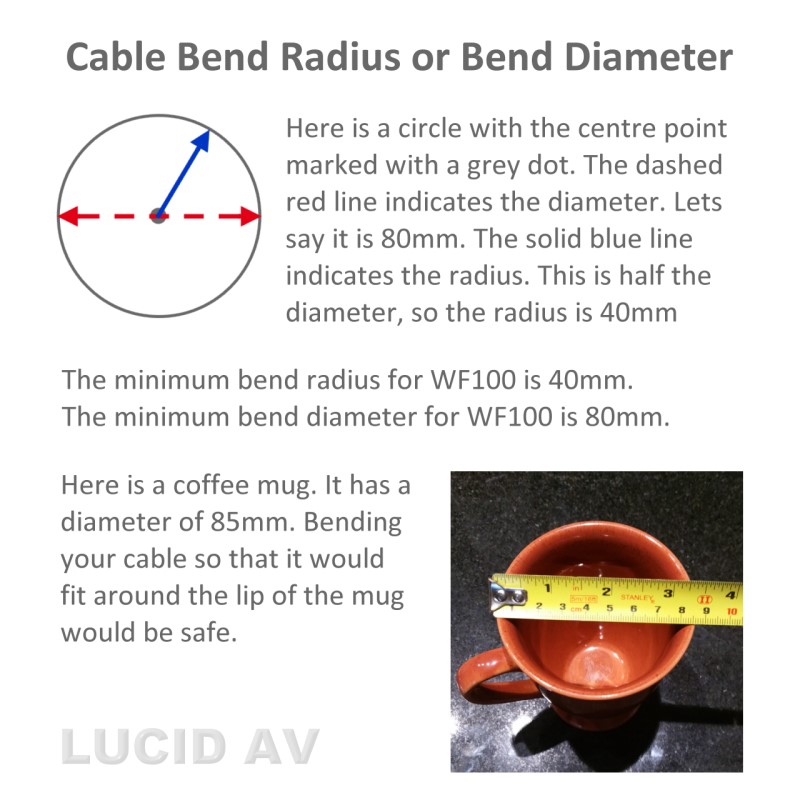

As a rough rule of thumb for TV and satellite coax, I tend to work with the cable diameter and then multiply by 12 to get the minimum bend diameter. WF100 is 6.8mm diameter (thickness), so that multiplied by 12 gives me 81.6mm, which is near enough to the official 80mm bend diameter as makes no difference.
The thinner coax you often see used for Sky installs is about 4.8mm diameter. 4.8 x 12 = 57.6mm bend diameter. The official bend diameter for CT63 or WF65 4mm coax is 50mm. Again, the rough rule of thumb gets close enough to make no real difference.
