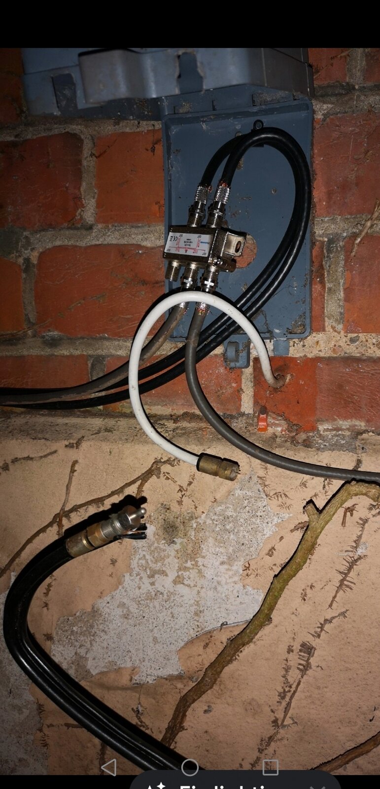

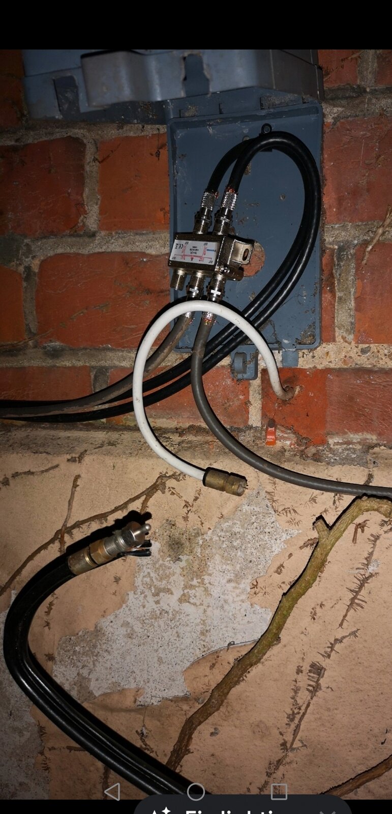

We had an existing continuous cable (brown in photo) from the roof aerial to the aerial socket in our front lounge.
We wanted two new aerial sockets - in our rear lounge and in our kitchen (we had previously been using internal "set top" aerials for these TVs).
The quote for the work stated he would "add external splitter/booster from front lounge TV connection".

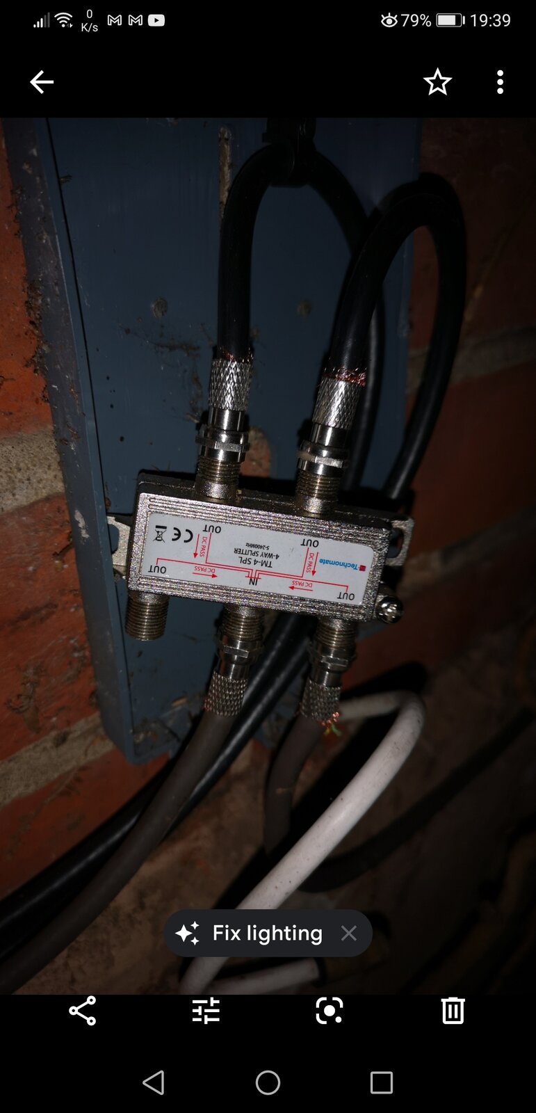

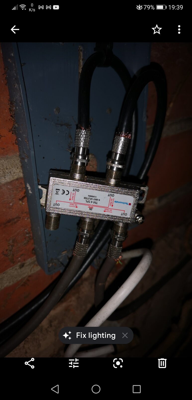

There was a grey box housing an old and not used cable TV cable which he has cut/dismantled and used the box to house the new splitter - the box does not now close properly. (see photo)
There is no sign of a "booster".
We are now getting poor or no reception on several channels on our kitchen TV - this is the TV furthest from the splitter.
He has suggested putting a booster internally in the kitchen next to the new aerial socket.
Any thoughts welcome.
Thanks in advance.

What has been installed is a splitter, for internal use only, so out side it will soon fill with water. It is just a signal splitter, not a booster/amp.
I would wonder if the guy has ever installed TV antennas before.

Difficult to be sure, much depends on your received signal strength at the antenna, but either...
1. A water tight mast head amp, powered via the coax, then an indoor splitter mounted indoors
or
2. A combined water tight amp and splitter.
It might well be that your original signal strength from the antenna was adequate to supply one TV set, but he has divided that to a fraction of the signal strength it was, with that splitter. Further more, than bit of signal will soon deteriorate even more, once the rain water gets into those cables.
Very poor job indeed, he was so antenna installer.
Thoughts?: The guy is a complete cowboy.
If he quoted you for a booster (better term is amplified splitter) then that's what he should have installed. Running a passive splitter is fine if - and only if - there's sufficient signal strength from the aerial to support the losses in signal level across all the muxes due the the splitter, the connections and the cable. All of this is easy to work out if the installer uses a professional meter and measures the signal level for each mux.

Passive splitting does have the benefit of maintaining signal-to-noise ratio, which is partly a measure of signal quality. This means that if the signal is strong enough across the board, and will remain so by the time it reaches the set back of the most distant TV, then passive splitting is perfectly valid. However, the fact that you have marginal reception of some muxes suggests that the guy(?) just took a bit of a flyer on doing a cheap-parts-cost job so he could make a bit more profit.
Amplifying at the set backs is a bodger's trick. It's bad form. The fact that he has suggested it means, IMO at least, that the guy isn't taking responsibility for his earlier short cuts biting him in the bum.

Yes, the guy came back yesterday evening. He replaced the internal splitter with a Technomate TM-4 masthead amplifier placed at the split cable, with power supply from one of our TVs. The set-up may not be not the best, but we are getting good reception on all the channels we need.

Technomate TM-4 masthead amp: If this is the one you've got TM-4 MAST - Technomate then the gain figure is 12-25dB. Two things from that: First, that's a heck of a lot of gain. Second, it's adjustable. [As a sidebar note, there's no proper spec for this splitter on the official Technomate web site. It looks like someone has done a copy and paste job and not bothered to change the specs from the TV recorder that was originally detailed.]
Regarding the size of gain; too much can cause signal loss just the same as too little. Digital TV can be odd like that; there's a minimum but also a maximum level. Going beyond either can create the same picture blocking and freezing issues. Your TV furthest away might be just fine but keep an eye on the TV on the shortest run. It's also getting a minimum of a 12dB boost.
If you start to see issues on that one then first check the masthead amp's gain control hasn't shifted. It should be on the lowest setting. Don't be tempted to add even more amplification. It's likely that the signal is already too strong on the strongest muxes. The level may need to be reduced on that specific feed from the splitter. That's done with an in-line attenuator.
