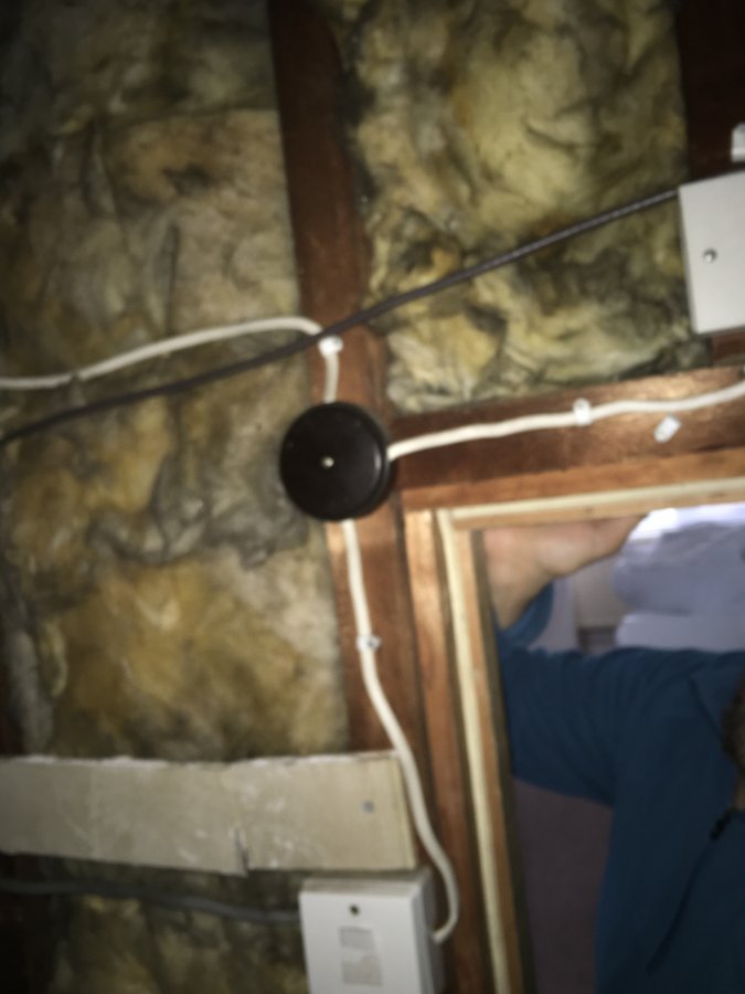

In my loft space someone has previously run a 5 amp fused spur from a double socket for a light. I need a twin socket in there as well. Am I right in thinking I swap the 5amp fuse for 13a, swap the cable for something suitable for 13amp then run a socket and another 5amp fused spur for the light?

This is what's currently there. Fused spur at the bottom coming from a double socket, up to a distribibution box that goes off to the switch and the light.

first things first How is this double socket supplied? I'E. is it on a ring, a radial or spur ?
What's the socket for? If it's just TV amplifier and similar you could leave the fusing as 5 amp. Label the socket as 5 amp load max.

For a powerline and a wifi hotspot. So not drawing much at all. 5a would be plenty, even for both sockets. But if I'm going to do it I'd rather just get it right (and legal).
If you are taking an unfused spur direct from the ring, your are only really allowed one outlet to be connected.
So ideally you would need a fused connection unit (FCU) downstream of the ring final socket being used for the feed. Then you can have as much as you want afterwards but will be restricted to a max 13A load.
Obviously cable ratings will need to be factored into this, a minimum of 1.5mm T&E is required for a socket outlet downstream of a FCU.
Plus if you are adding socket outlets, BS7671 will require the provisions of RCD protection to be considered/assessed.

Ok. This is what I believed so...
Double socket --> 13a FCU --> Junction box --> double socket
--> 3a FCU --> switch --> lighting socket
The 3a fcu is coming from the junction box there, not another spur from the second double socket!
Ended up doing it with a junction box after the 13a fcu. One to the socket, one to a 3a fcu for the light. Is that not correct?
Either way, your idea in your first post was correct.
Socket downstairs on ring > 2.5 mm2 t+e cable > 13 amp fused spur switched or unswitched > 2.5 t+e > socket > 2.5 t+e > 3 or 5 amp fused spur > 1.0 t+e > lighting
The junction box after the 13 amp fused spur is acceptable too.
