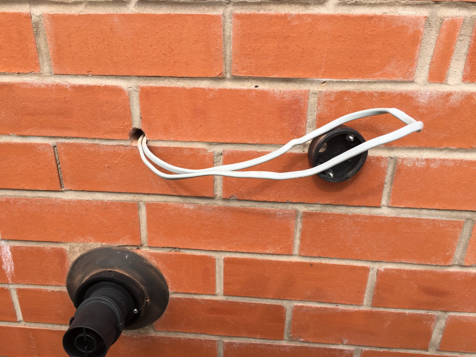

Hi Flameport,
Thanks for getting back to me, I have had another look at the looped cable and I'm 99% sure it is looped. I can't pull either side out of the wall and the hole is quite big, so no cement etc. to be seen. Is this unusual?
I have also attached 3 picks.
One of the internal light switch
One of the loop and one of the single twin and earth.
The loop is on the left hand side of the door on the same side as the internal switch and the single cable is on the right hand side of my door.
On the switch pic, you can see my main kitchen light wires (3 core and earth) on the left and then the two twin and earth on the right.

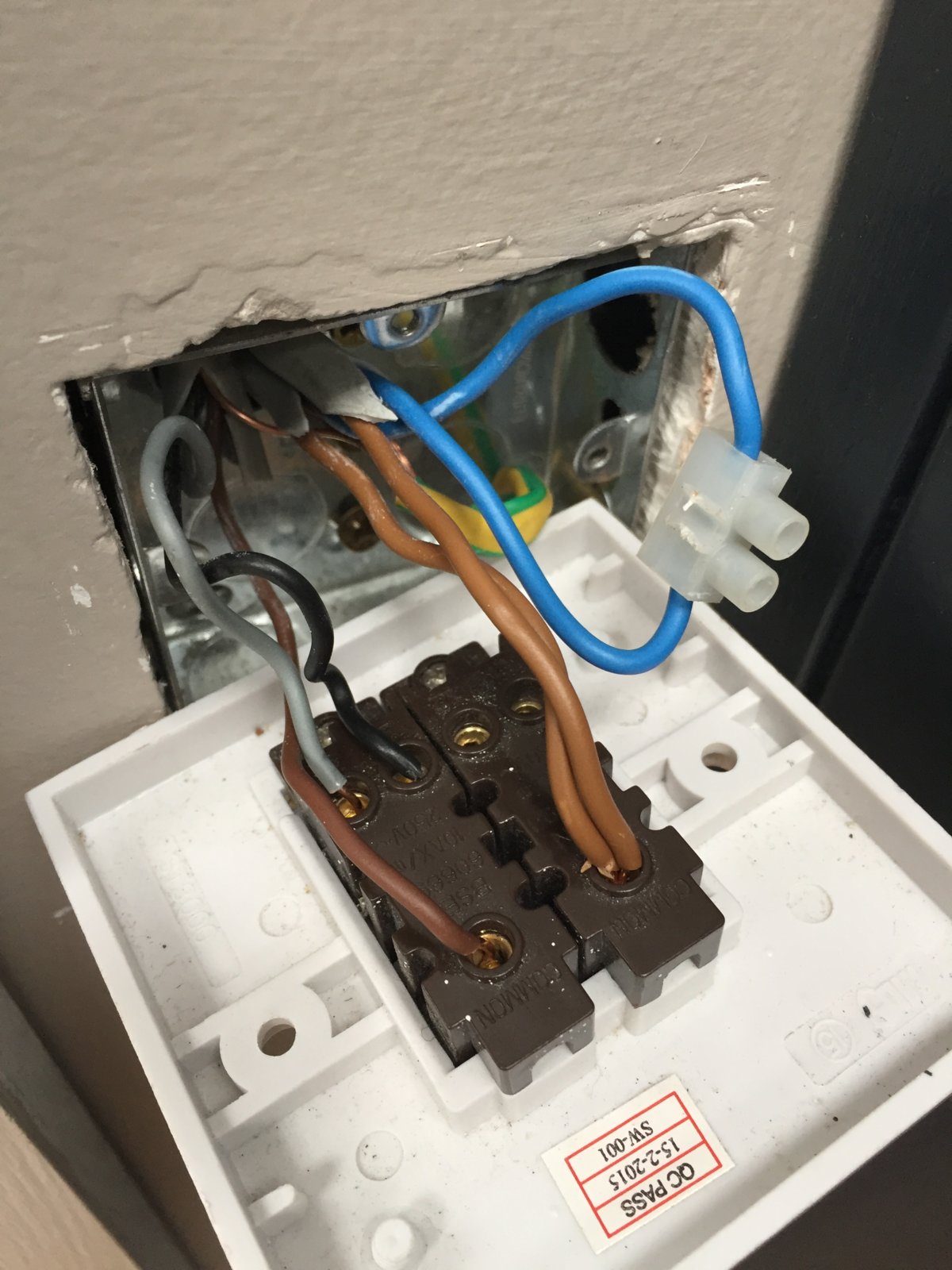

Hi Rsgaz,
So, if I have understood you correctly I have attached a pic with how I have wired up my switch.
I have put the two live wires (brown) into L at the top of my switch. Put both neutrals (blue) into a terminal block and then put my two earths into the earth terminal of my swithch. The new wiring is on the right of the pic and the untouched original main light wiring is on the left.
Thanks for your help with this.
No, only put one brown into the 'common' that they are in now, and the other brown into L1 at the bottom. Doesn't matter which brown is which, it is the switch that joins them together when it is on.

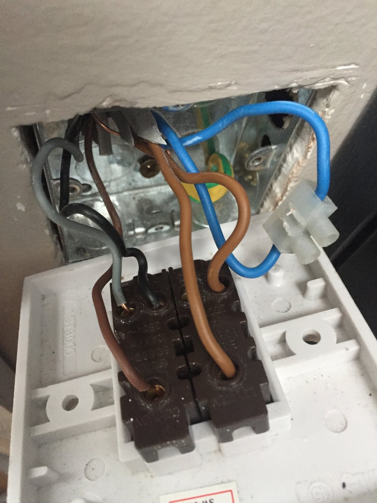

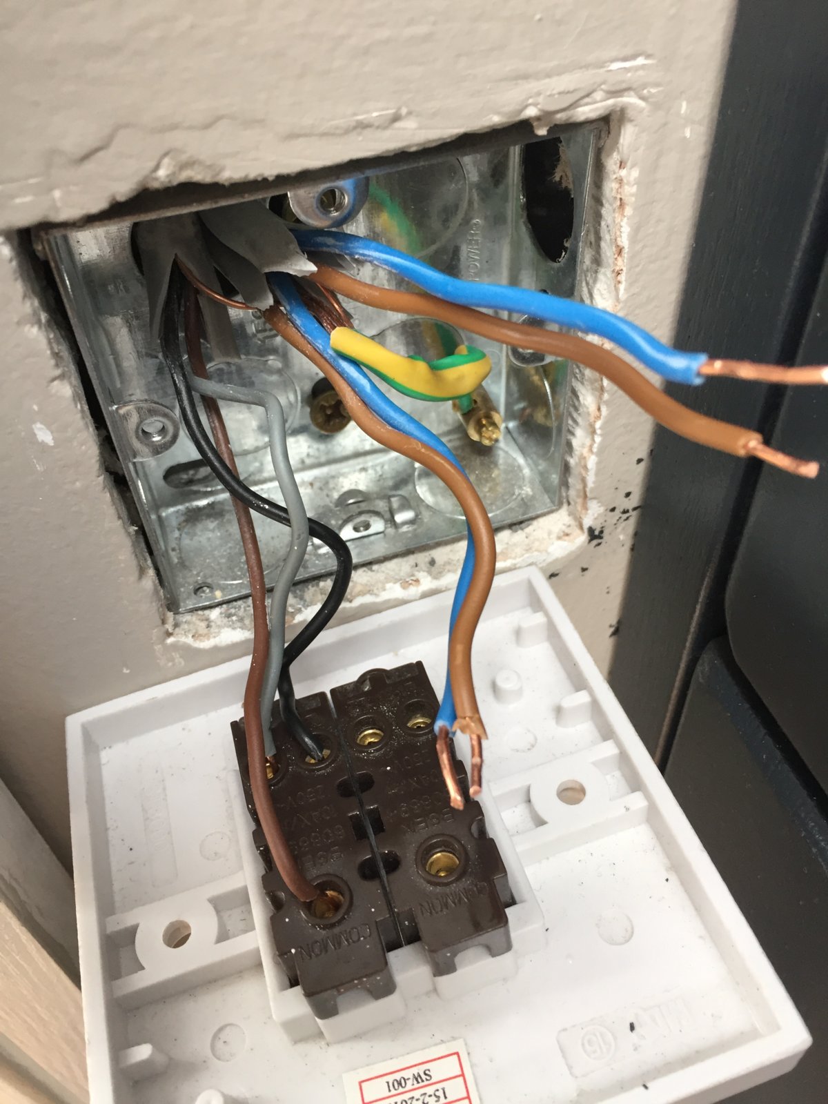

Hi Rsgaz,
Sorry, my bad.
I have now moved one of my brown wires into L1 (Pic attached). Still not working, and now I have put the power back I have lost my main kitchen light. This is the one on the left of the pic. Nothing tripped and all my fuses are fine, I have not touched this, so something strange is going on. I will replace the swictch tomorrow and post back.
Thanks for your help.
That is odd.
Time to get out the multimeter and find out exactly what's going on with all your cables behind that switch. You need to find out where the 'supply T&E' is fed from. This could be a nearby ceiling rose, but then again, could be a hidden junction box somewhere above the ceiling, there are many possibilities. Even direct to the consumer unit is possible.
Or, get the electrician back and pay him to sort it for you.

Hello Kevin ,a few things... The two t/e cables that were behind the switch ,and before you made any connections , how where they terminated by the builder/ spark ? If your main kitchen light does not now work , check the original connections on the switch ,you may have loosened or broken one of the conductors. As mentioned earlier ,you are guessing what the cables / conductors are , which isnt wise . put things back to the way they were and call in a spark.

Were the two cables connected to anything else before you did anything? Such as connector(s) on the ends of them, or joined together in some way?

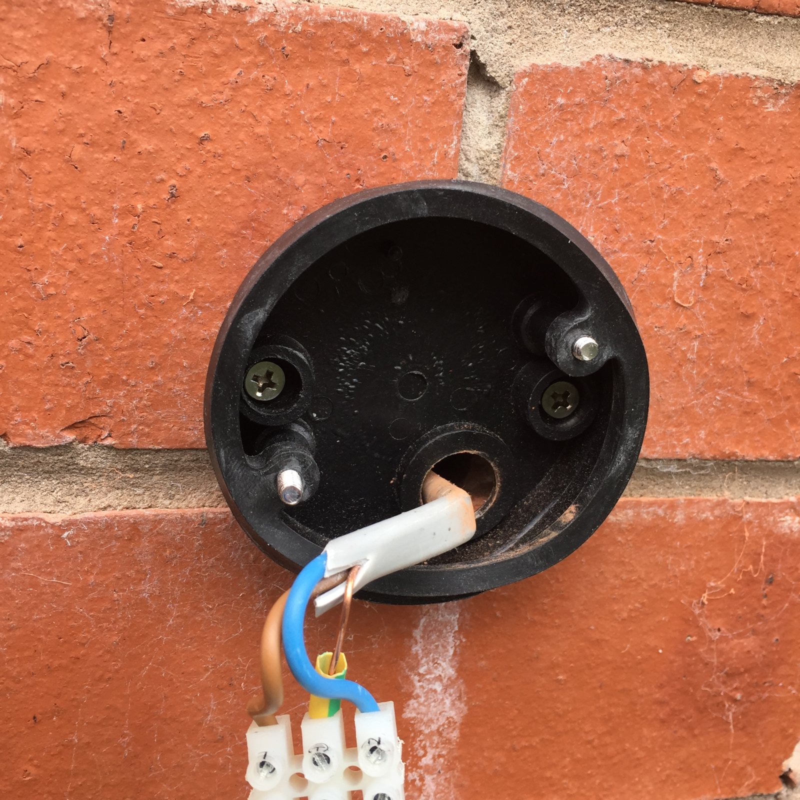

What have you done with the outside cables?
Its not possible to have 3 cable ends, or 5 now you have cut it, disconnect all relevant cables, if you have a multimeter, then check continuity from left outside end to right outside end, that will confirm your thoughts that the cable runs between each outside point.
Then with the remaining outside end, check continuity from there to the wires behind the switch and hopefully is one of them, as for the other wire behind the switch dont know.
Its possible that he planned to put the outside lights on a seperate circuit and not with the kitchen lights and the missing end is back at the fusebox
Also shouldn't the base plates be fitted so the fixing studs are horizontal so when you fix the light it is straight :)
