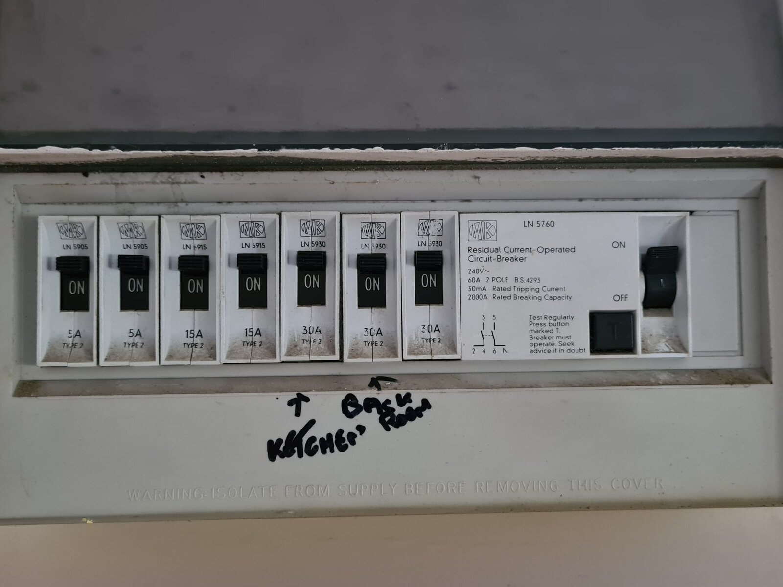

Before I call a sparky out, can anyone offer any advice?
So yesterday I got home and the kitchen circuit breaker had tripped. Partner and kids home but none of them even realised so were no help in identifying what might have caused it (ie any switches being turned on off etc).
This morning, I turned the dishwasher off at the fused switch on the wall, and the mains switch tripped so everything went off.
Reset it, and turned the dishwasher on and off at the wall and was absolutely fine.
Anyone with any ideas?

Is it an mcb that’s tripping or an rcd? If you’re unsure of the difference post a photo of consumer unit and indicate which one is tripping off.
So yesterday it was the kitchen MCB that tripped. Today was the mains one on the right (RCD?)
So given that, I’d be looking for an Earth or neutral fault, possibly on the dishwasher?
With 7 MCB's on one 30 mA RCD suprised the RCD does not this more. The MCB tripping is more of a concern, but depends what was running.

Sorry do you mind expanding? Do you mean the consumer unit needs upgrading?
Many items of equipment have a small amount of leakage current in normal use.
That RCD is rated 30mA, and the maximum allowed current in normal use is 9mA, which divided across 7 circuits is only just over 1mA per circuit.
Above 9mA random tripping is possible.
Having the entire installation on a single RCD was never valid.
The RCD you have got is obsolete - BS4293 was replaced by BS61008 in 1990, 4293 was eventually withdrawn in 2009.
A replacement consumer unit would have individual RCBOs, so any fault would disconnect a single circuit only.
The dishwasher may have a fault, or there may be one or more faults between N&E elsewhere on that circuit or other circuits which only shows up as a trip when a certain combination of loads is connected and switched on.
