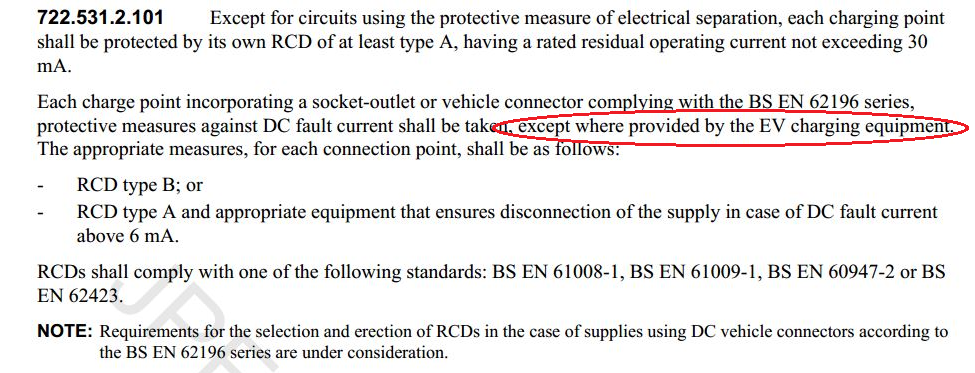

See 722.531.2.101 of 18th ed BS7671 DPC,

I don't know much about EV charging points but -
are you perhaps wondering unnecessarily?
I think also, after the part I have highlighted, there should be a comma and then a lower case t.
Whatever it is supposed to mean, it is very poorly written. There's a surprise.
C'mon, it's a big, big document. And although there are lots and lots of people working on it, they do have other things to worry about, like when their next buffet is coming along or whether they can catch a sneaky peek at their secretary's new dress. And then there's the distractions of the internet...
They can't possibly be expected to get it perfect.
Sorry. I forgot to add the keywords stuffy, old and farts.

Thanks, that pretty much means that for domestic charge points, the dc protection has to be built into the charger. Which for a Tesla means it has to be built into the car as they support charging from a standard 32A industrial outlet.
If that's how it is then there's no problem. I think I'll drop them a line to check.
I don't think so - at least for me, that would make it even less understandable (as well as grammatically rather odd {incorrect?}).
Kind Regards, John
Well, it depends what it's supposed to say:
Either what I said or some other correction.
"Each charge point ... ,protective measures against DC fault current shall be taken, except where provided by the EV charging equipment."
doesn't make sense.
Well, it depends what it's supposed to say: Either what I said or some other correction. .... "Each charge point ... ,protective measures against DC fault current shall be taken, except where provided by the EV charging equipment." .... doesn't make sense.
It doesn't. I would imagine that it's meant to say something like:
"For Eeach charge point ... ,protective measures against DC fault current shall be taken, except where provided by the EV charging equipment."
... which, I would suggest, does make sense.
Kind Regards, John
That may be one way but then neither comma is required.
If the comma before 'except' is used then it implies their would be more after the clause.
As it is the point of the sentence it would be better if it started with 'Except where ...' or
a new sentence started at 'Except where' and then as I suggested.
As the first sentence mandates the use of at least an A type RCD, it is just very badly written.
