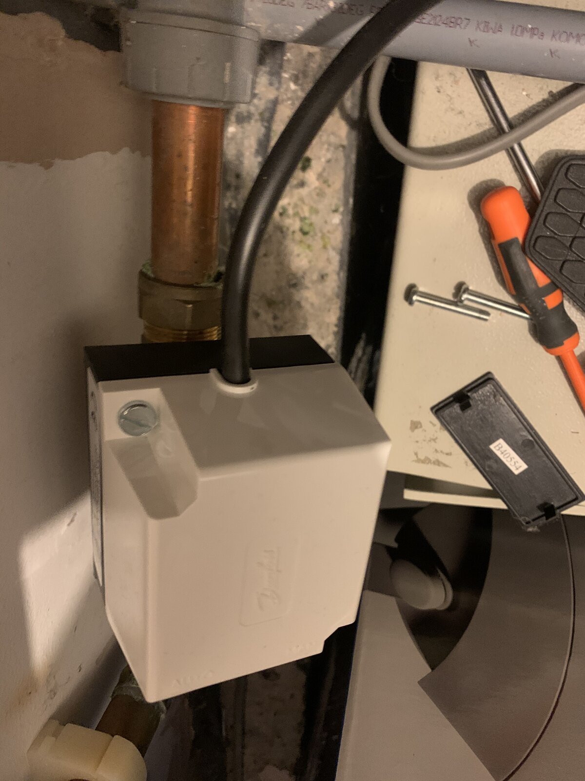

Hiya. Yes sorry I should have posted. My fault was with the valve. Although the valve was working intermittently the cable in to the valve was breaking contact. I replaced the valve and all is now working.

Yes sorry I should have posted. My fault is fixed. The issue was the valve which had a dodgy cable. If I wiggled the cable it would work. I replaced the valve which fixed the problem
