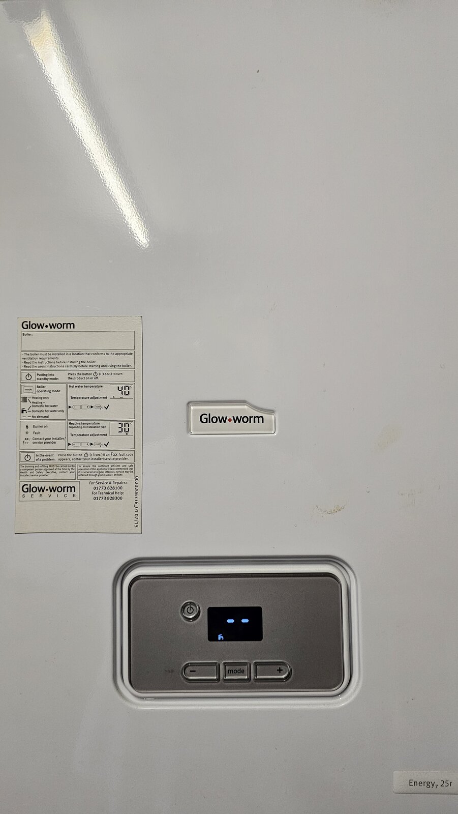

Hi,
Hope somebody can help. According to the manual for the boiler we have, glow worm easicom 25r, we should be able to set the how water temperature via the menu button. Once we cycle through and choose the tap symbol, we are supposed to use the + and - to set the temp.
However, the display just shows -- and will not move. (see attached instruction sheet)
The system, as far as my knowledge goes, is a closed system. We have a hot water cylinder and some kind of pressure vessel just above the pipes in the airing cupboard.
Thanks for any advice!

the boiler you have is a heat only boiler. unless you have glowworm smart controls fitted then the hot water function is not used. ( this control panel is used on the combi version boiler as well).
the boiler only uses the heating temp. it uses controls to decide whether it heats the hot water or the heating.
post a pic of your unvented HW Cylinder, it will have a thermostat, is the water too hot or too cold

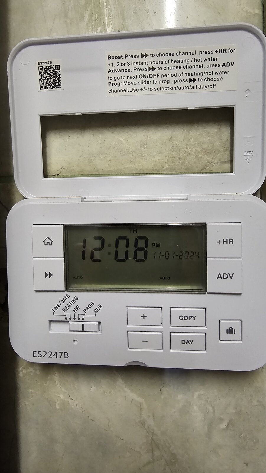

Better to start your own thread really, but same question to you as the OP - what controls do you have?
Hi Dirky, not sure if you'll get a notification about this and I know it's quite late, but were you ever able to fix this issue? I have the same model boiler and issue that you posted about. Can only adjust radiator temperatures and not the taps as there is the double minus on the interface that won't let me adjust temperatures. Please let me know if you were able to resolve this, thank you!
If you have a cylinder, the boiler will not know whether it is producing heat for the radiators, or the hot water cylinder, so normally there can only be one boiler setting for the flow temperature.
Thanks! I wasn't there when things were installed so not too familiar with all the boiler jargon like water cylinders and whatnot, but these images show what I'm working with.
