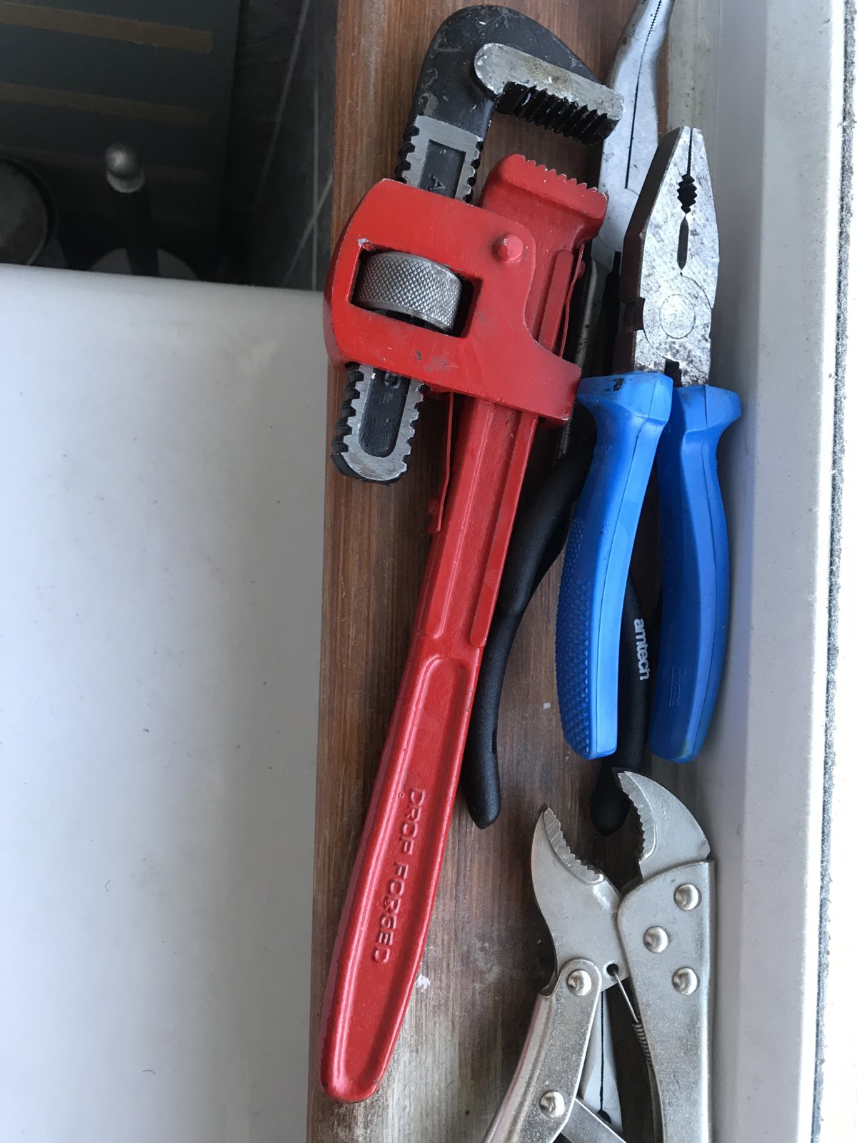

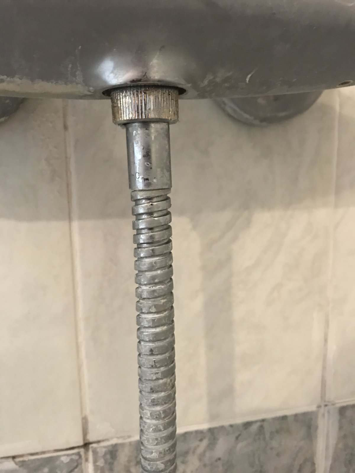

I’m trying to replace a shower hose from the underside of the mixer as it’s leaking. I’m unable to get a sufficiently tight grip on the thread despite trying to use an adjustable spanner, players and other devices. How is this type of problem overcome? I’ve tried spraying wd40 on the inside a cavity in the flawed hope that it will somehow go inside and lubricate the thread but no effect.
Here is an image of the tools and the nut im trying to unscrew.

Do you have any grips/water pump pliers? Adjustable spanner and mole grips no good for that nut. Pliers usually no good either, not enough leverage.
That's limescale for you.
If it won't budge with the vice grips then it'll probably shear the plastic inside before it goes.
Try some limescale cleaner on it though

I've just tired the opposite end of the hose, and to remove the shower head, I need to unscrew it clockwise. Because the end connected to the mixer valve doesn't turn (well actually it turned a few mm when I used the following tool which I also found in a drawer just now), I'm unsure which way to actually unscrew it as it doesn't give.
Can someone confirm if these connectors are all standard in the direction that they screw/unscrew?

Should be anticlockwise "around the hose" but there's so many brands there could always be one where they decided to do it different!
Run hottest water you can through the hose and then have a go with pump pliers or the mole grips (but don't lock them too tight).

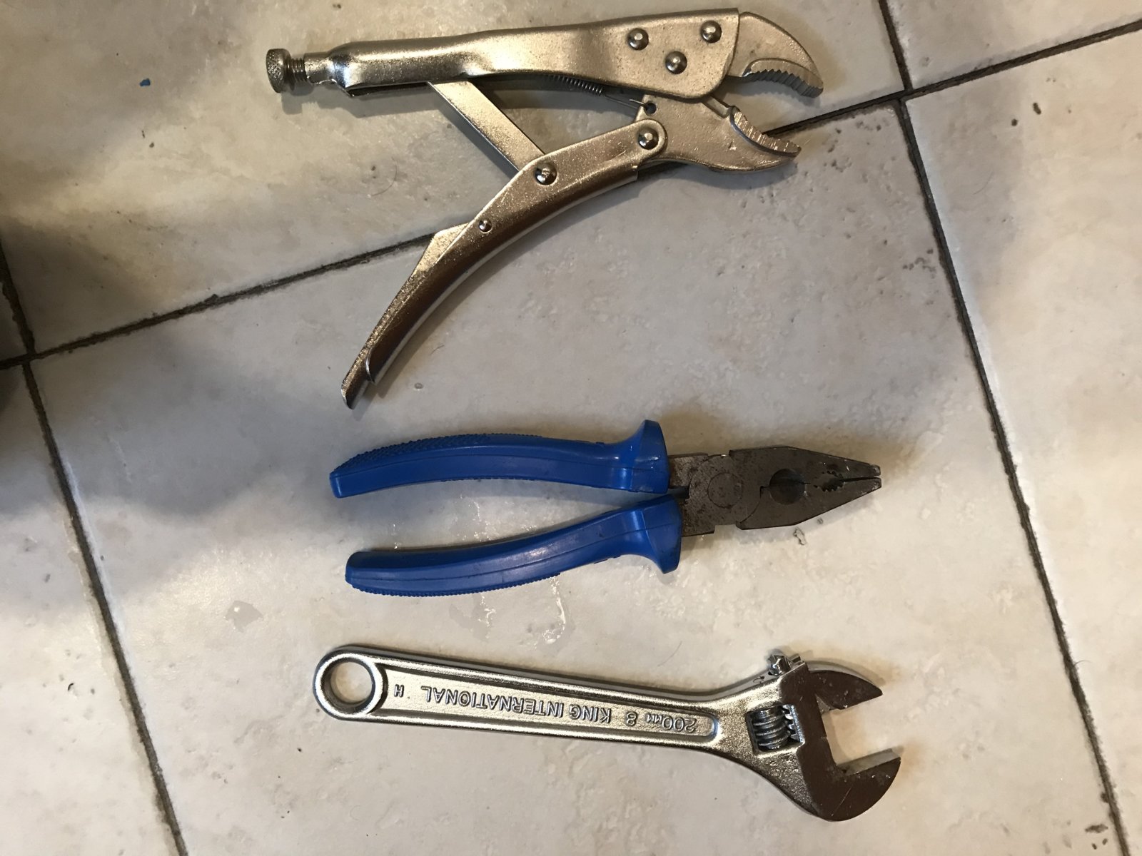

this was the other red tool I referred to. Not sure the names of all these things - another type of spanner? I cannot get it the tool to grip with the but though so it slips everytime I try to turn it.
Does a shower head normally unscrew the same way as the connector to the shower valve or are they usually opposite?

He meant...
If you're looking up at the valve from below, (bottom) then it's anticlockwise.
But...
If you're looking down at the valve from above (top) then it's clockwise.
The red tool you have shown are stilsons and are not what you'd usually use but with careful application they could work. If this is all you have then the silver "mole grips" would be the best to use. Clamp them on the grooved nut and then looking down onto them, you'll want to rotate them "clockwise"!
