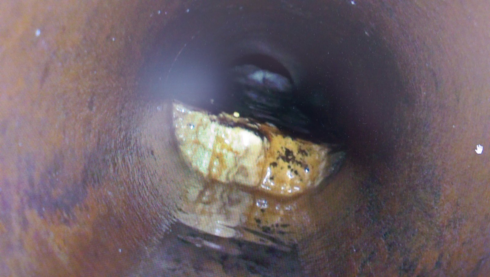

Drain keeps backing up between to manholes since we moved in, every 3 months or so ,when I rod it I feel no resistance and it clears I just put my head down furthest away manhole looking back I can see what looks like a large piece of concrete.
It must be tapered and the end I rod to feel no resistance but other end looks square edge.
Any ideals how to even open up the diameter of the pipe a bit more (acid ect) I can get a bar onto the concrete but it is solid and don't wont to hit to hard as the pipe is clay.
Or as I think have to dig it up.
Thank you
kevin

Thank you hertsdrainage for your reply ,it is solid I was hitting it hard with iron bar and hammer. I have emailed a local company waiting for reply just looks weird how's it a square edge and if concrete not tapered both ends
HI Andy I will try to get it jetted out . It does look a funny shape . I try and get my head down there again tomorrow, its just in my arms reach with a bar. Thank you
If you can shove a crow bar in between the pie and the blockage, it might just pop up and be able to be removed.
Andy
I bet that goes back a couple of meters like a big wedge.
If it’s not too deep you could dig it out and replace the section.
Cheers Ian yes looks like I have to dig it out ,not to deep just wanted to keep it flowing until I did it when warmer .
you get a connector hose for drain blasting for power cleaners, I have one, no where near as good as the professional ones but with patience can work, very much doubt that is concrete
Thanks for your reply's Ian I just arrange to borrow jet washer for weekend I give that a try first or if not join the home serve link you gave me . I hope its not concrete and jet wash moves it I keep you updated
Thank you
Kevin
Wear eye protection! A facefull of whatever it is will be nasty
Looks like fat or possibly scale to me. Scale will be pretty solid, but easy enough to remove with the right kit. I'd look for a local independent drain cleaning company, and ask them to quote. They can try jetting it first, but if that doesn't shift it there are other tools available to them that can remove even concrete from a drain without digging it up.
