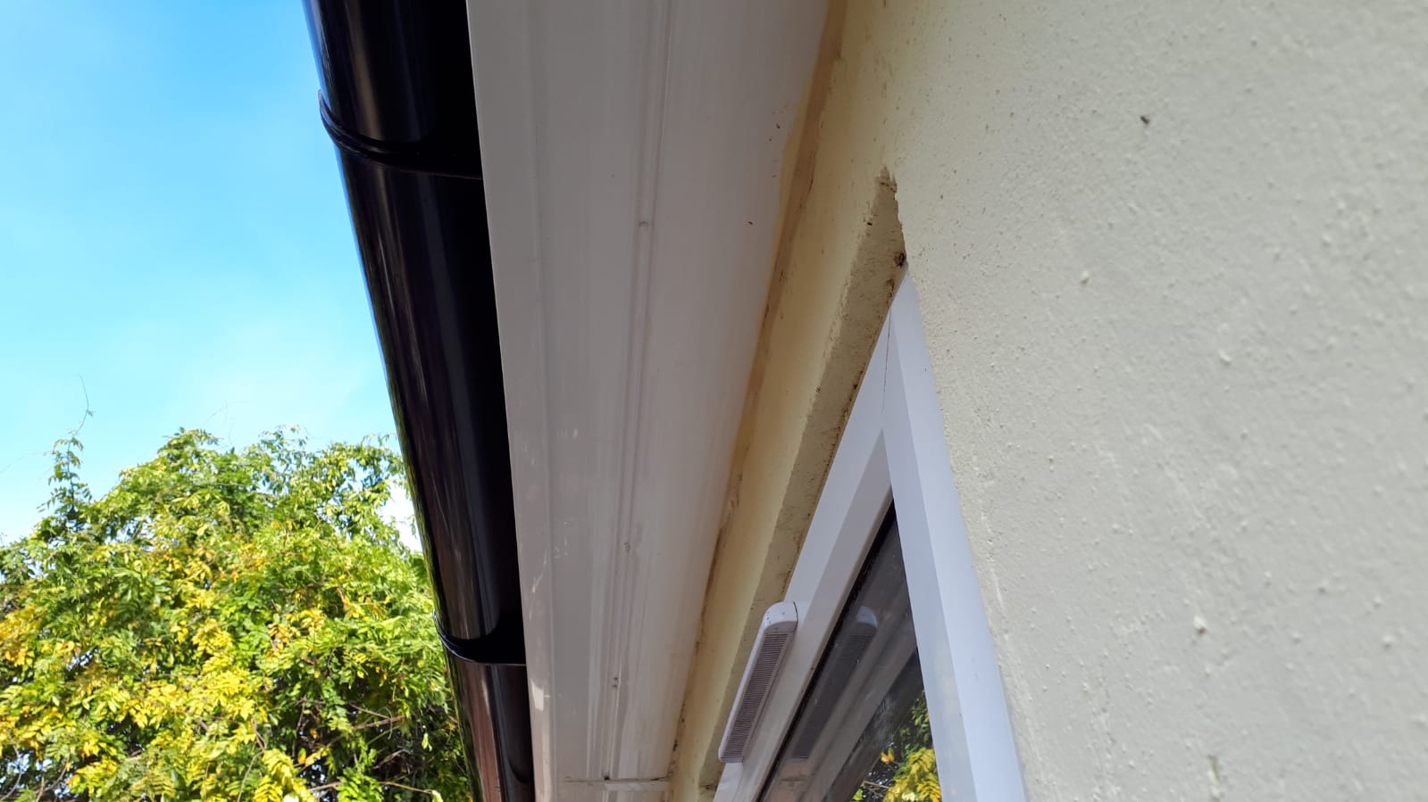

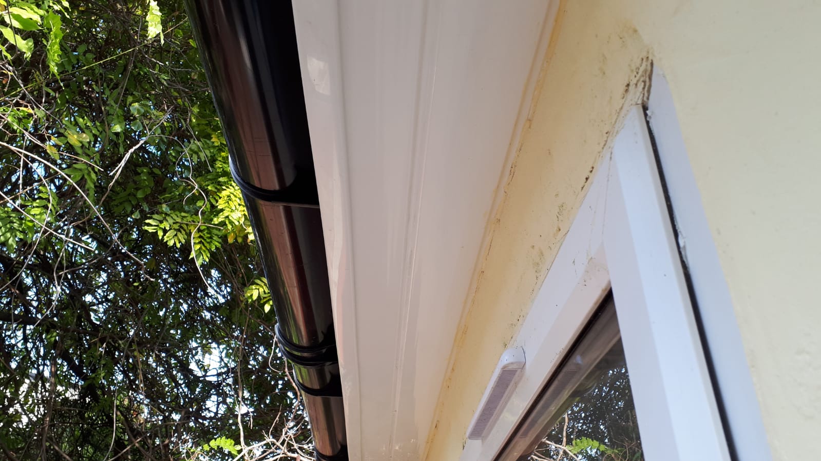

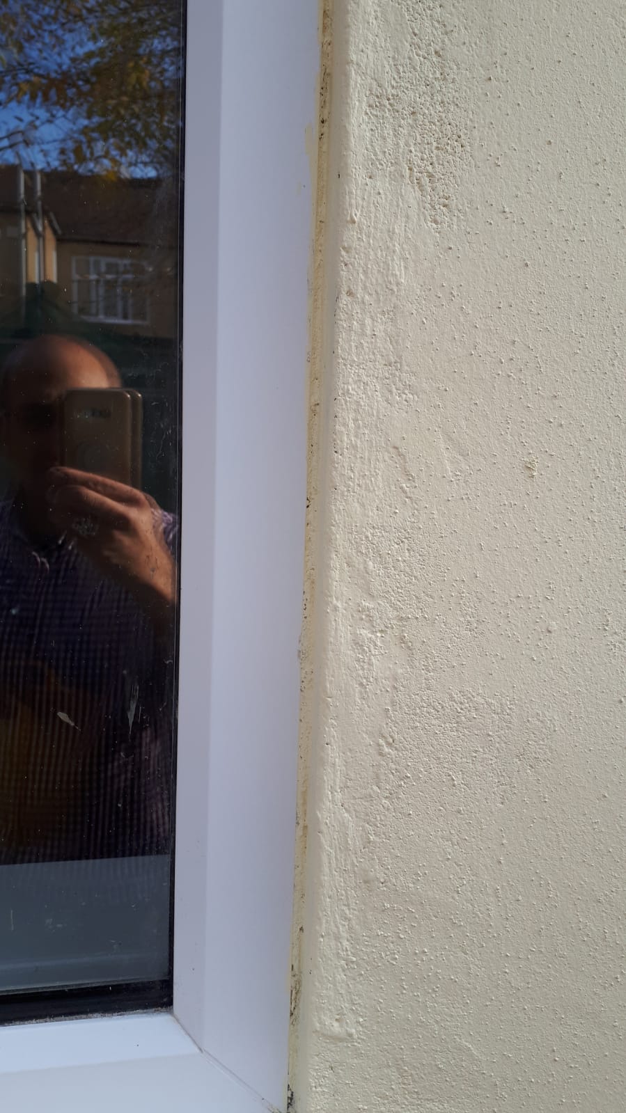

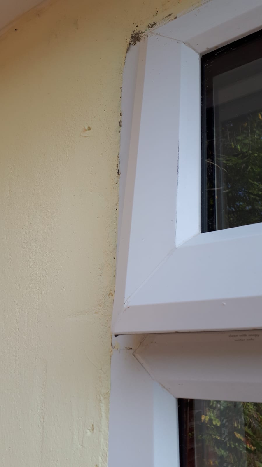

I attach pictures of what I am not happy with. Firstly the brick work and render around one of the windows which looks fine (I hope, I am relying on you guys to tell me), the second image is around the left window. Firstley, there does not seem to be a ledge like the other picture, and also the render has just been lapped on, bumpy and painted ina rush.
Give me your opinions please.
He tried to threaten me once with building control (I ddon't know why), and he will try to shut me up again I am sure, but I need to be firm and tell him that this work is unacceptable.

Just wanted some advice on my new outbuilding (few months old), I have attached images of rendering that has been done around one window, and rendering around another. You can see where there is no surrounding ledge around one window, and there is one around the other. My builder is very stubborn and I should ask him to re-render as I feel this is unacceptable. Would anyone agree?

Our internal plastering was done a bit better than that, but the architect commented that it wasn't really want good but not quite bad enough to ask them to redo it.
So I'd say you're in safe territory there asking to be done properly.
Did you specify or imply that the render needed to be to BS EN 13914-1:2016 or NHBC standards or suchlike? That will be your problem.
But on the bright side, there is a good chance it will come off nicely and easily with a light tap, if the builder wants to renew it. And some angle beads may be in order on Render v2.0, and tell him to use a float not an old tree stump.
Yes, the render is not good enough.
As Woody says -corner beads arent visible around window reveal.....did they use any?
What is the detailing near ground level, there should be a bell cast bead at DPC level.
Beads must be stainless steel or plastic, not galvanised beads which only internal plastering
