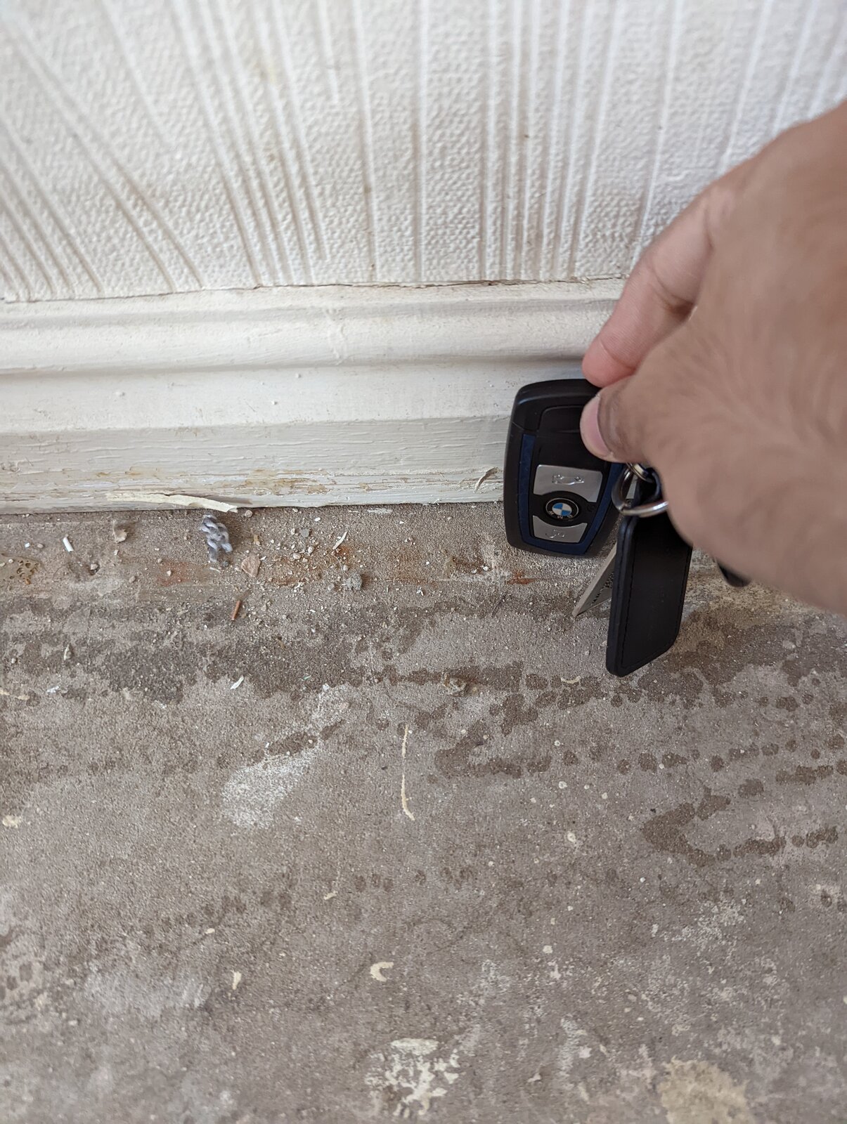

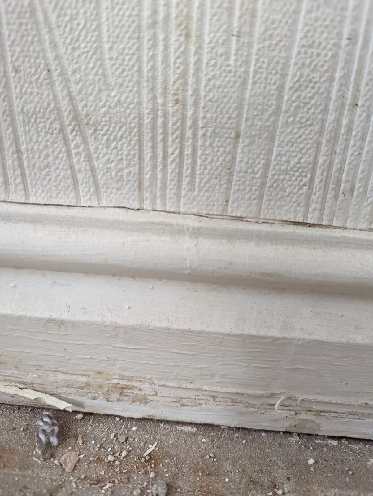

Hi all
I need to replace a long length of skirting board in my lounge but I'm struggling to find the correct type. It looks like Torus but nothing close to what is available.
Has anyone come across this type before?
Thanks all
It just looks like a modern torus (flat below the bulged bit) as opposed to a Victorian torus (radiused below the bulged bit). The only thing is it is very short, so either somebody has use architrave instead of skirting, or they have ripped torus skirting down to that width. I'd expect a traditional torus skirting to be anything from 5 to 9in (125 to 225mm) tall. Yours looks a lot less
