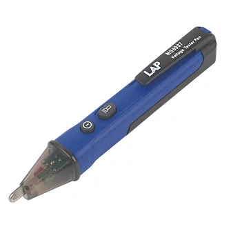

In late mothers house some months after a rewire the bedroom lights stopped working, traced to a loose wire in landing ceiling rose, I today use a non contact voltage tester seen here Testing for live.jpg testing if there is voltage to the Nest power supply, the 4 bars show how much voltage detected and using one of these saves opening up ceiling roses and switches to find point where power has been lost, cheaper versions 1699514759264.pngdon't show how much, and simply rubbing on a jumper can make them light, so not really accurate, or reliable, but far easier to removing covers to test. The tester I have also measures using leads or clamping around the wires, but it is the NCV option which is handy with a fault like yours.
