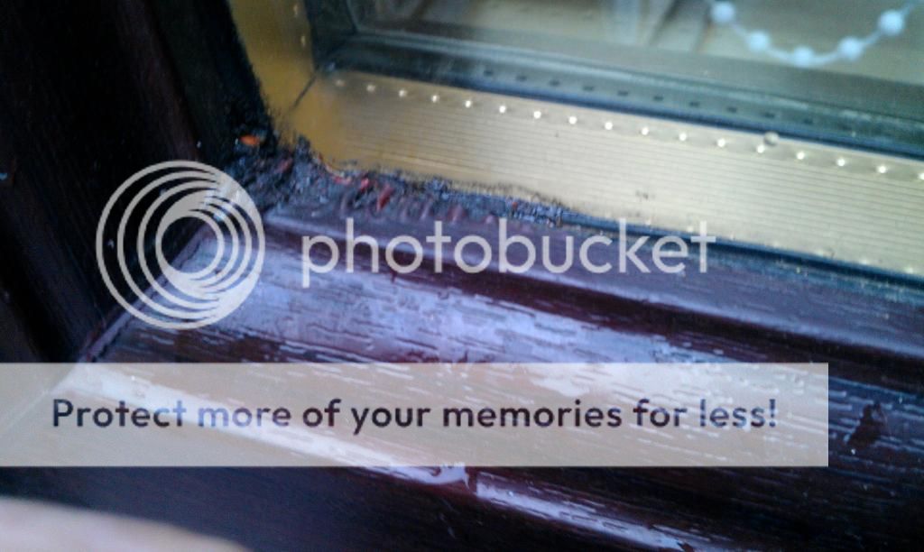

Foil is generally bulletproof but in some cases can fail, not because of a fault in the foil but other issues with the install itself, if i could work out how to post pictures here i'd show you 2 recent cases where the glue from the duct tape around the dgus has turned to goo in the heat and flowed down to the bottom eventually seeping out of the bead mitres and blowing the foil on the outside, the repair consisted of cutting the damaged tape off and reapplying new

Ouch that sounds like a pain of a job, Have never heard of it before but can see how it could happen. Would definitely like to see the pics.

Ive had glass slip where it has got hot but never seen that before. Recently my suppliers have been recommending toughened glass in all dark colored windows because of some overheating problem. Maybe this was what they ment.
First 2 are eurocell profile
This one is WHS Halo
I work for a PVCu systems company and over the past few years I have come across a number of installations with this problem. according to a contact in the glass IGU manufacturing industry he noticed the problem years ago after his sealant supplier changed the formula of their Polysulfide sealant. The changes to the formula being to reduce cost because of rising additive prices or certain compounds were being phased out ( banned ) because they were seen as harmful ( similar to removing heavy metal compounds from Paints. PVCu etc ). The resinous sticky liquid that leaches from the sealant is most likely to be plasticisers I have been told. These plasticisers have the effect of attacking the foil and adhesive. I have also heard that sealant manufacturers blame the use on silicone sealant ( used by some installers to secure glazing packers in place, ) and this causes the IGU sealant to break down , but I have not seen evidence of this on the installations I have seen. to date I have only seen this issue on IGU's with polysulfide sealant , I have not come across the problem with Butyl Hot melt or Polyurethane as yet which would seem to back up the compound change theory.
As goes silicone breaking down the seals , I have seen this first hand. If you use a non Low modulus silicone on Butyl sealants , it will turn the sealant to a sticky mess....not a pretty sight!
