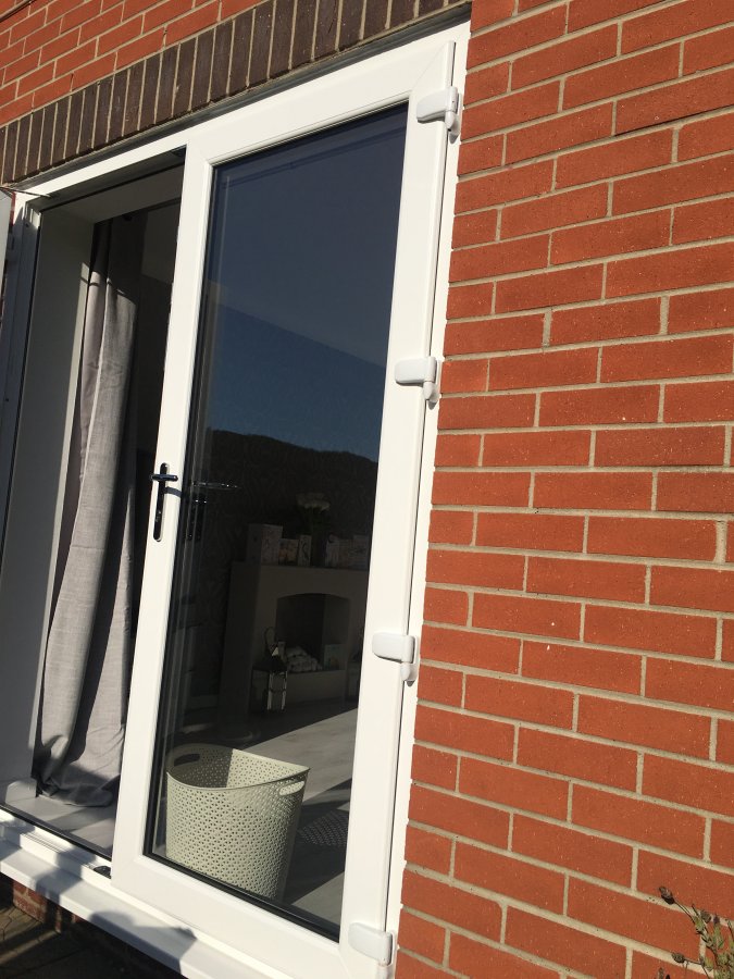

Hi, my French door is catching the other door
How to I potentially tilt the door as its catching at the top ?
I have been fiddling with it but made it a lot worse
we are going to need a pic of your door and hinges. There are a hundred or so different types and makes
They are rehau doors with 4 hinges with it being a 6ft opening
If anything it's the middle of the door that's catching the frame which continues to the top.

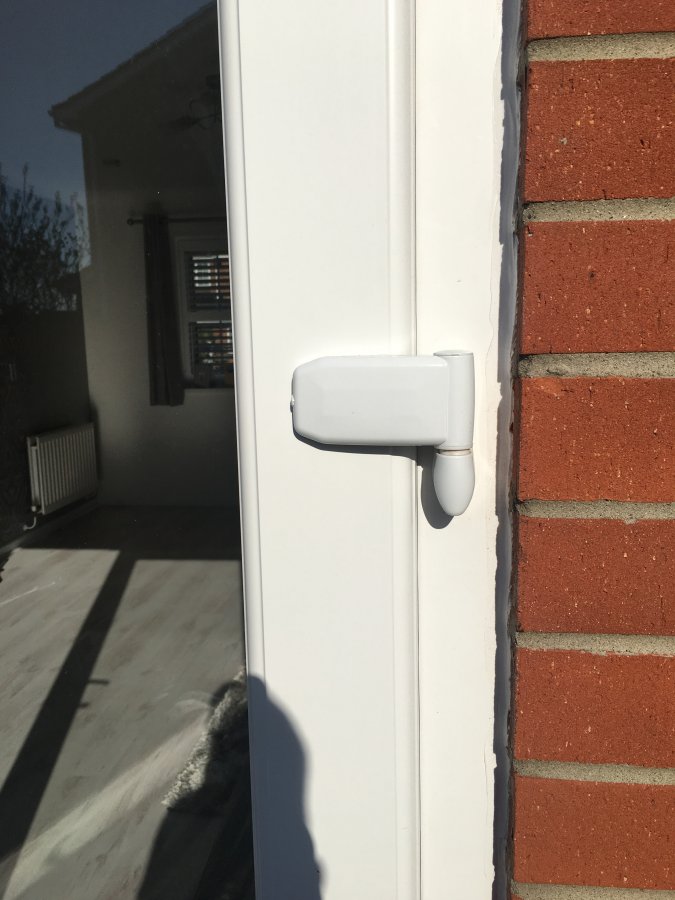

Yes I've had the caps off, underneath there is a Allen key hole to the side, and then a few screws keeping the hinge attached to the door
I wasn't 100% sure what way to turn the Allen key to pull the top of the door back over to the door jam in the brickwork
You have the little plastic caps on the edge (door side not the frame side) so you don't need to take it all apart.
Just take those caps off. You will most likely need a 5mm allen key.
Its always the opposite way than you would think it needs winding so anticlockwise to wind the doors away from each other.
Always a good idea to draw a pencil line around the edge of the flag hinge on the door. This way you can both see which way you are winding it and know where to put it back to if it makes things worse.
Cheers mate
One more thing though, do I need to loosen some of the screws in the hinge before turning the Allenkey head anti-clockwise ?
should I get someone to hold the weight of the door ?
Wish I had of just left them the way they were lol
The instructions do say to loosen the screws but 99 times out of 100 its not needed.
If you can see the pencil marks moving as you turn and your not having to really force it you will be fine.
No need for someone to hold the door as your only tweeking it. Just make sure your turning the correct one. Its the one under the tiny plastic cap that you can only see in your first photo
