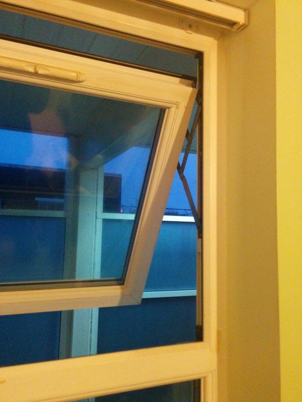

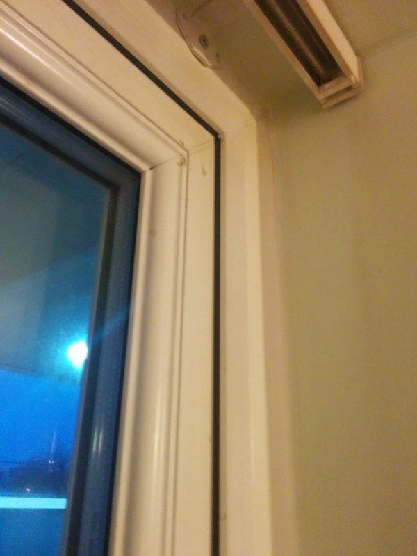

Window - there's gaps where the two frames meet. really confused as to what its called, gasket/weatherstrip/weatherseal? also, on the outside, i can push the top inward for a better close buts its only a small movement so not sure if its a new mechanism i need or just a new black strip thing.
1.
2.
3.

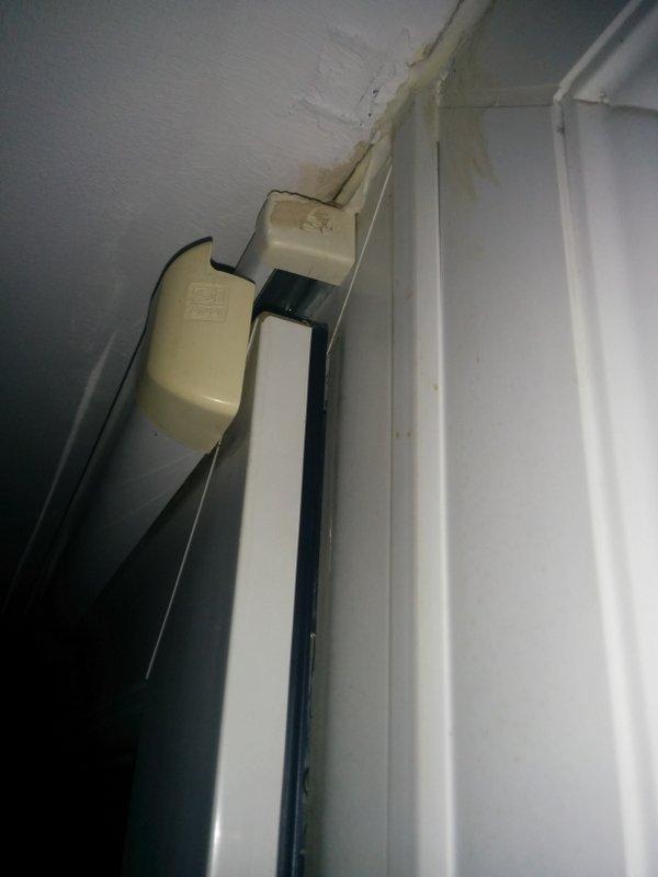

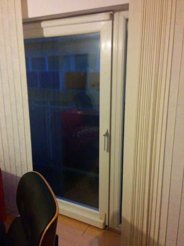

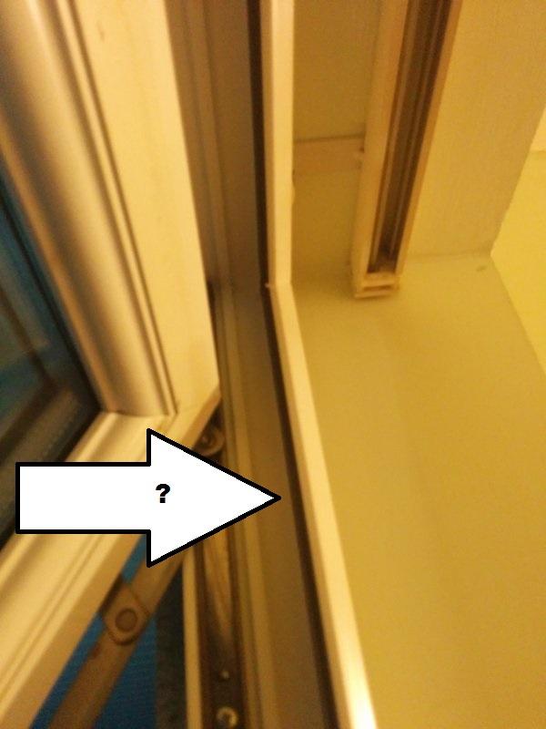

Door - this is a pull and slide door and same as the windows, there's a gap between the two frames. thinking new black strip thing again..?
4.
5.

The gaskets will have been co-extruded and they don't shrink.

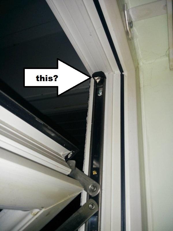

You will most likely find that the drafts are coming in from the top half's of the windows which means that the hinges are wearing in the top corners.
Try some grease/Vaseline in the top corners of the hinges (there will be a metal or plastic lug that guides the top of the hinge) then open and close it a few times to see if it sorts your problem.
If it dosent the hinges are too warn and will need to be replaced. Either way you should clean and lubricate moving parts once a year.

cheers Gazman16 for the quick reply. just wanted to double check. so the thing in picture 3 with the arrow on it is called a gasket and i assume co-extruded means can't be taken off? (am thinking about the draught excluder tape stuff for the pull and slide door) and the lug thing, is this it?
thank you :)
Yes thats the bit go ahead and grease it up a bit.
The pvc and gasket are molded together so there not really replaceable.
As for the door its not really secure like that so I would get it looked at by someone and adjusted/repaired properly.
Thank you :) i'll grease it up with proper stuff tomorrow, only got WD40 in the flat and i heard thats bad for uPVC. right?
as for the door, i'm on the 4th floor and there's no handle on the outside so security wise should be ok unless spidermans around but i'll get someone to adjust/repair it. any guestimate on pricing?
Vaseline is good if you have any.
WD40 attracts grit and dust so silicone spray is recommenced for the other moving parts.
For the door you could use the stick on stuff but to be that far out of adjustment I would guess its only going to get worse quickly.
Hard to say what it will cost to repair ask a few local window and door company's. Probably around a £30 callout then £20 per hour plus any parts needed.
