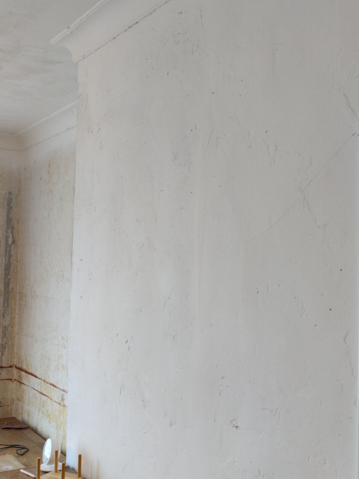

I've heard good things about these flexible plastering rules and thought maybe it's a good investment. I've noticed there seem to be two types, semi-flex and one that doesn't state what it is but I assume it's rigid. I have a couple of questions.
  • On which occasions would you use one and not the other?
  • How difficult are they to use for a newbie?
My intention is to use it to flatten a wall above my fireplace and then fill in the gaps in plasterboard tapered edge in my kitchen.

I don't know if you can make out the blemishes on the wall but it's pretty bad.

Bought an Ox Speedskim last year when I was plastering my daughter's house. Never used one before but found it pretty good. I usually spread and polish with a standard trowel to a decent standard, so the Ox didn't necessarily improve the finish but it did some of the effort out. I found laying on and initial flatten with trowel followed by a skim over with the Ox made the second coat much easier to lay on. Once firm a final skim over with the Ox and finish with the trowel as normal was producing a very nice finish.
PS. you've got to bear in mind that I'm not plastering every day. Very much an amateur, albiet with a fair bit of experience.

I have zero experience, mate. I just need something to make my life easier.
Do you know the difference between the two?
I've only used the blue plastic one, so can't comment on practical use of the steel blade. If I understand correctly, both can be used at any time in the process but the blue plastic blade is stiffer - so better for flattening - and the steel blade is better for final polish. The difference is that the steel blade will follow contours so the plaster needs to be pretty flat before you start using it.
I would think a blue plastic blade would be better for you but, quite honestly, if you have limited experience and won't be using the blade for general skimming you might be better off filling and sanding your uneven wall - using a taping/jointing knife.
