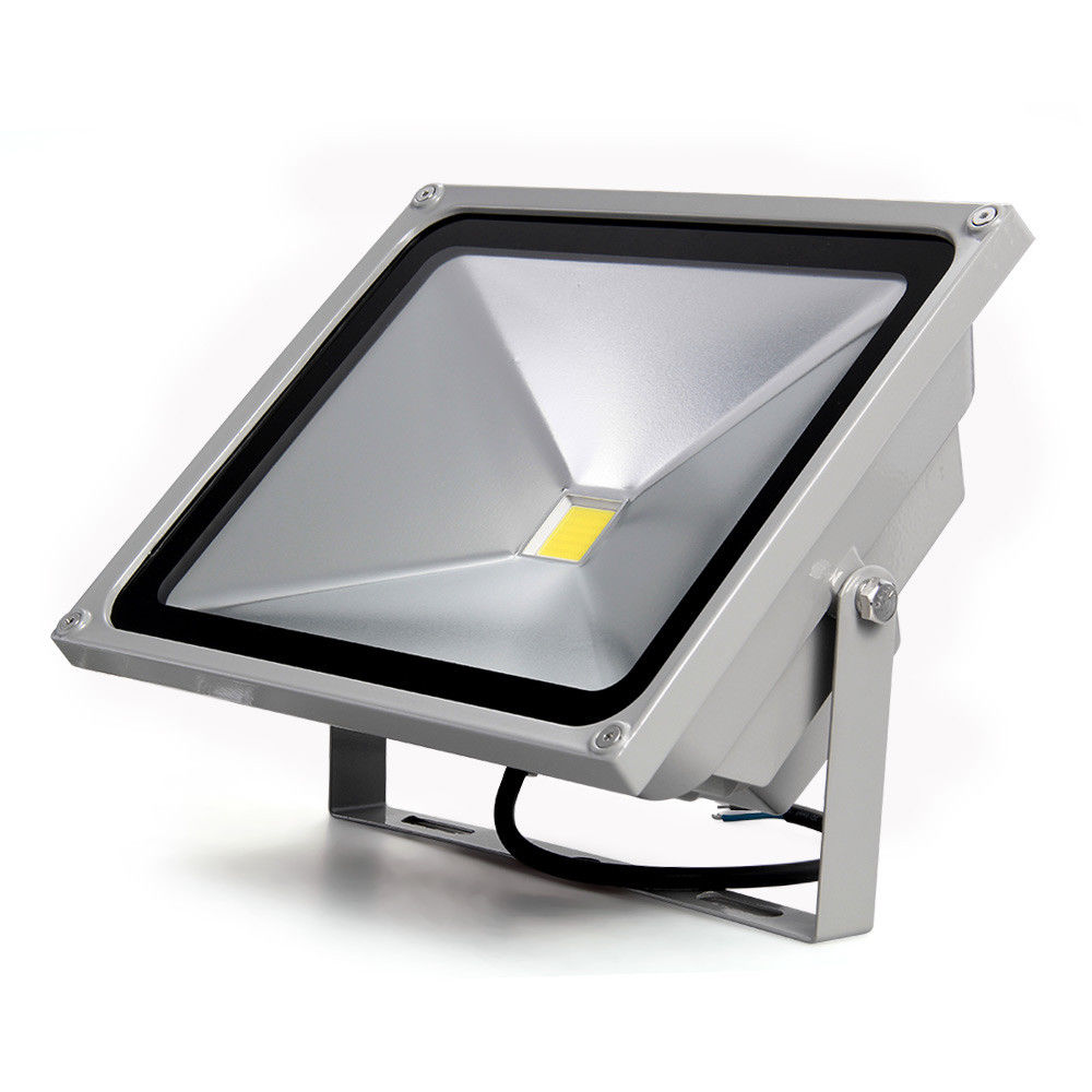

Hello,
I take part at trade shows and want to replace my existing halogen lighting with 50w led floodlights(as image) The lights will be positioned high up behind fascia boards shining down onto the tables set up around the front edge of my stand . Obviously although the lights have a very long life once in a while they will fail and I may need to replace one or two quickly to keep the stand and products well lit.
I am always on a corner and will have two floodlights on each side of the stand shining down and would like the lights in pairs to be connected to one long cable going to the socket(i.e two cable overall going to wall socket.
Firstly can I connect to 50w leds to one cable and secondly is it possible to have each one connected so that it can be quickly "unplugged " and another plugged in to replace it if it fails.Obviously I could just use a very long extension cable with three pin sockets but extensions of this sort are not allowed over 6 feet.
I.e are there male female connectors that are safe and would work in this situation. I hope that all makes sense !
Thanks.

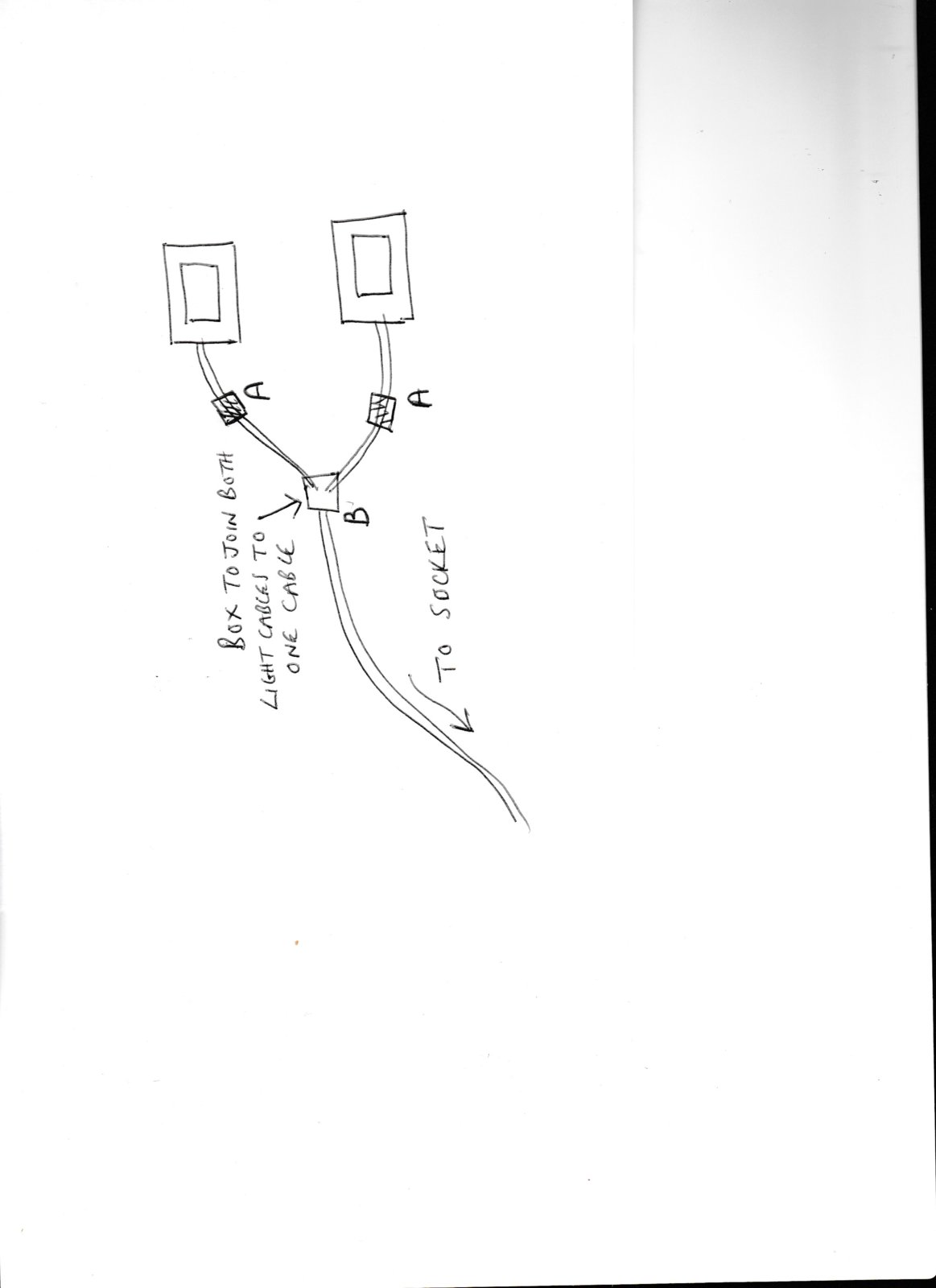

Thanks for your messages and advice. I would do the wiring and would have them pat tested before the show. As you say they are very tight on this. I actually own a few iec 60309 connectors but to be honest they are pretty big and cumbersome, are they not a bit overkill for two led floodlights that may have joint wattage of not over 100w? The connections would be behind the fascia board but is there not an inline joiner(male and female) that I could use that is much smaller. I would have one half of such a connector permanently connected to the spare light so that I can just swap for the failed one.
I have done a very basic drawing of the sort of thing I mean. As said I want to have both light cables joining into one cable that ends up going to the wall socket ,this saves having loads of cables trailing behind my stand. What would be a good connector for B? For the A connectors would the attached connector be sufficient?
Thanks again for your help.

i have some 2 way iec leads intended to power computers and monitors, in a Y shape
Most LED lights come with 6-12" of cable to which it's easy to add an iec.
otherwise, rewire longer cables. IEC/13A leads are so common, being free with every computer, yet never unwrapped.
people use the old ones.
You are over thinking the failure rate, LED lamps last 100's of hours and aren't delicate.
I worked on the shows for a bit, and a reasonably well established exhibition company just used these for their stand wiring.
You have two options, use a distro block and plug two male ends (to fittings) into it and one female (from mains).
The other option is to wire into the female, then out of the female into another female with a short piece of cable and into another female. So you esentially have a Y fitting but if it had been been handwritten lowercase.
The beauty of these is you can use as many leads of xM as you want and plug and play them all to the end with a plug on should you have a different stand. Wire them in white / grey flex though dependant on what shell scheme you generally get
Seems a bit dodgy.
I doubt they are robust enough for that, one end is not designed to restrain round flex, and ISTR there are no knockouts on the cover - if so then unless there are 3 cables there is access to live parts. And a tool is not needed to gain access to the insides.
Surely IEC 60320 C13/C14s are what's needed?
