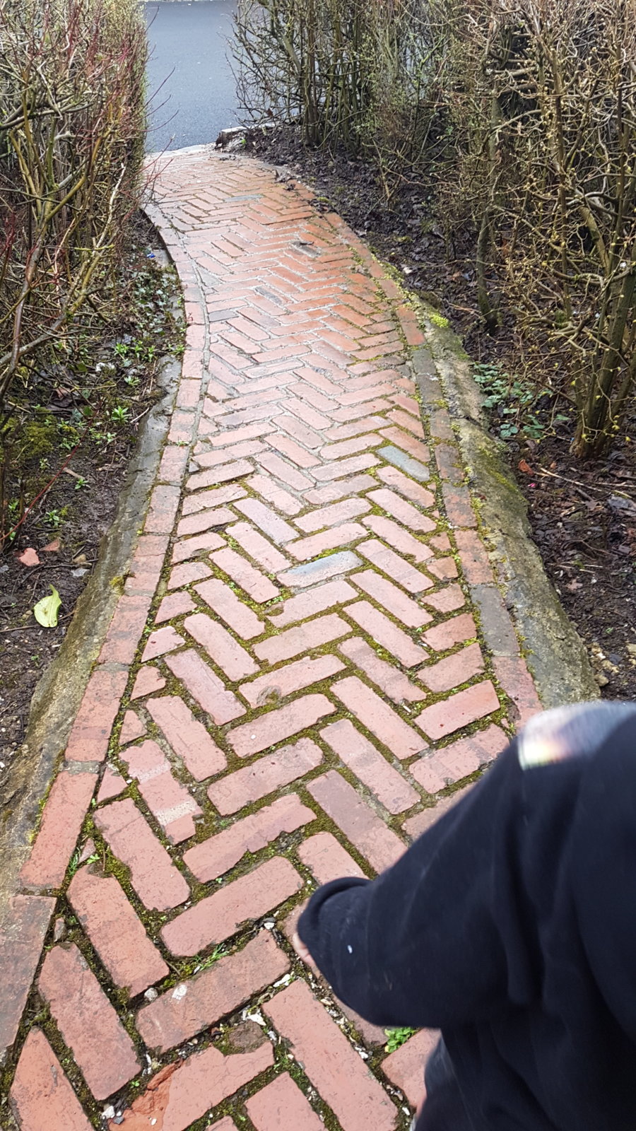

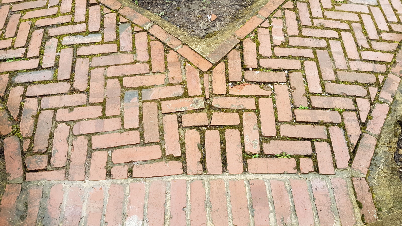

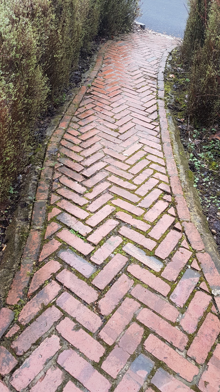

I am planning an extension that will involve removing some old outside walls. I would like to reuse the bricks to make a path and patio and also to build a dwarf wall.
Will the bricks be OK for the path and patio? This is the look I was wanting
