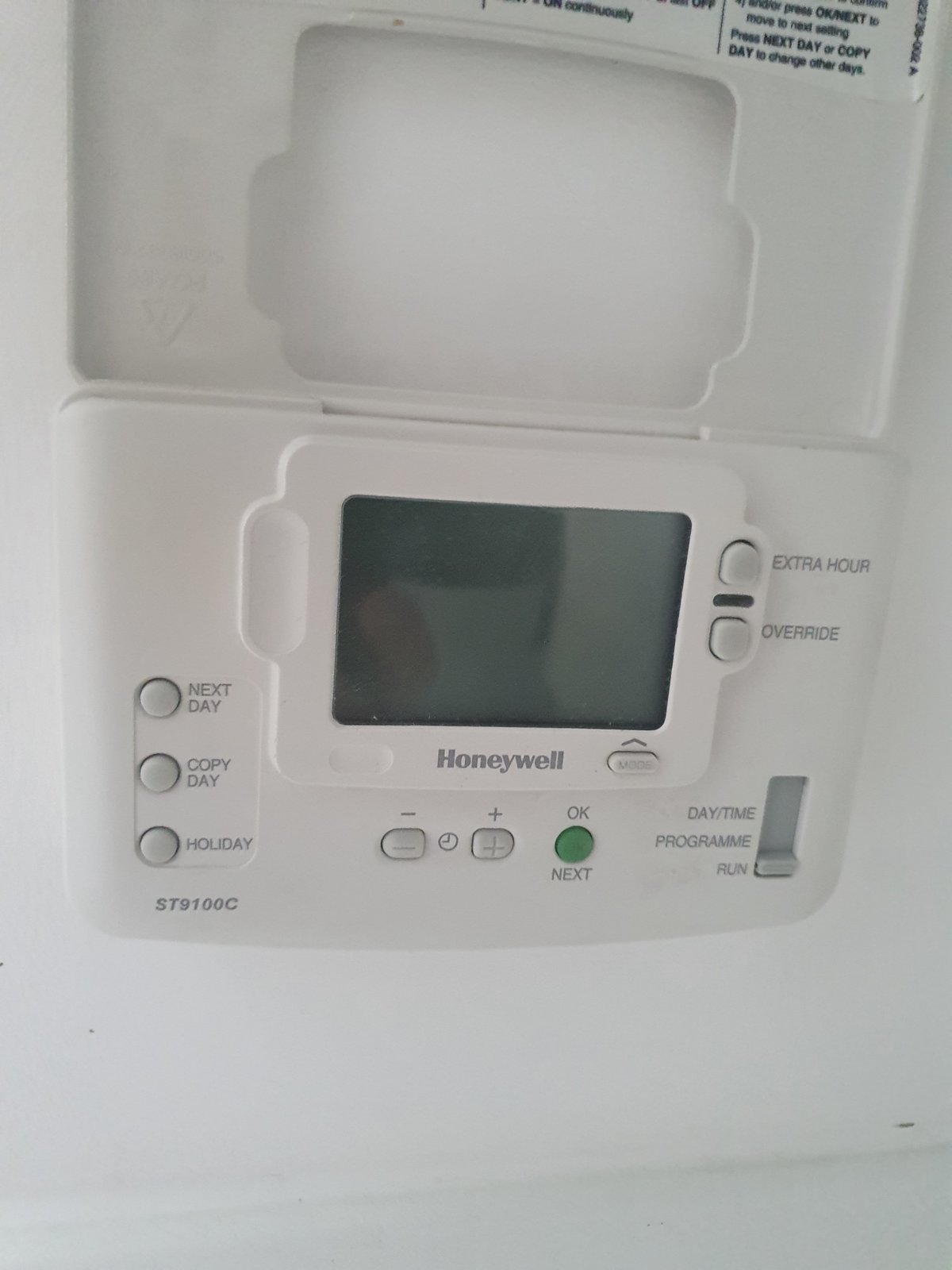

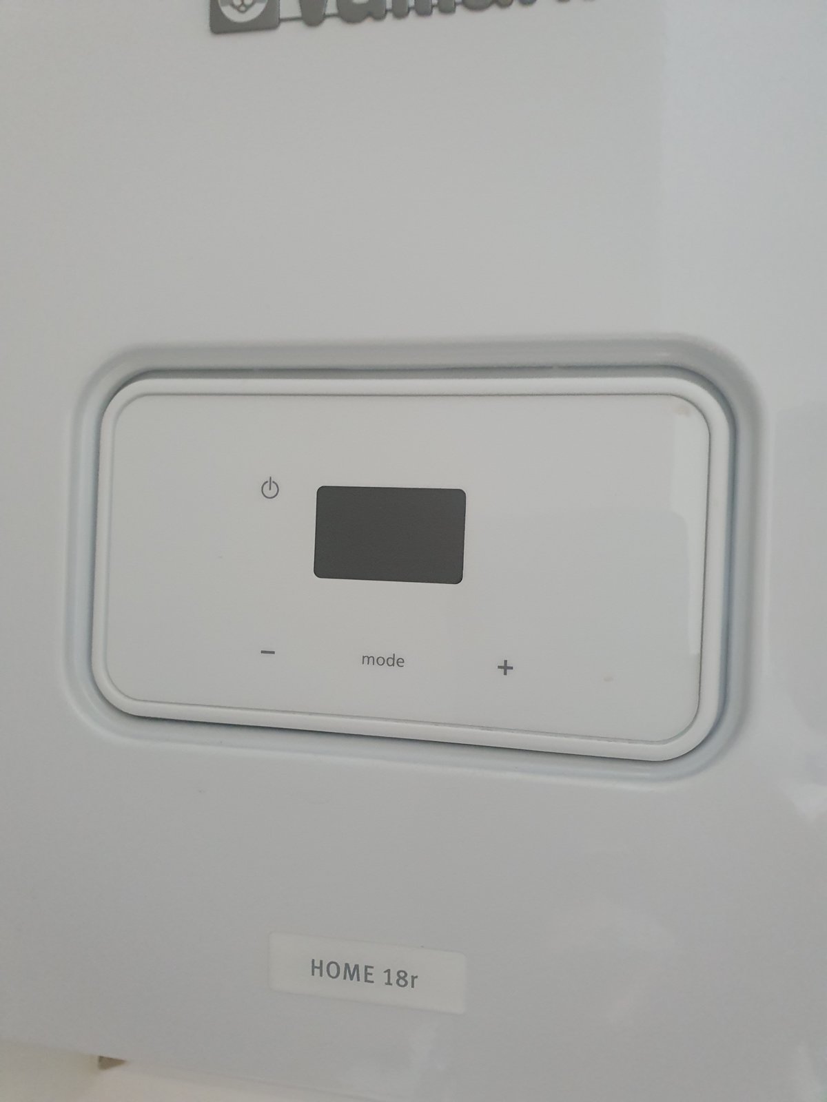

Hello folks,
Recently had installed a new combi boiler Valliant eco tec plus only 2.5 years ago.
Tonight what seems like power cut to the lights, the boiler switched off completely and without any display. After switching on the fuse box the lights came on but the boiler remained off. I turned on/off the main socket, but nothing happened.

Where does the boiler connect to electric supply ,is it plugged into a socket ,or wired into a fused connection unit ? Check their fuses.
I have tried looking for a but i can't seem to find it. I cant see any plugs either
Follow the cable from the boiler ,maybe. It has to be somewhere .
By the way,what tripped on your consumer unit , RCD, Mcb ,or other ?
I'm confused, you've said you've had a Vaillant ecotec plus combi installed, yet you've posted a photo of an entirely different boiler? A Vaillant Home 18r, which is neither an ecotec nor a combi? It's not even really a Vaillant, it's a cheap Glow-worm with a Vaillant badge on it.
I suggest that the fuse in the isolation switch has blown. It might be in your airing cupboard
