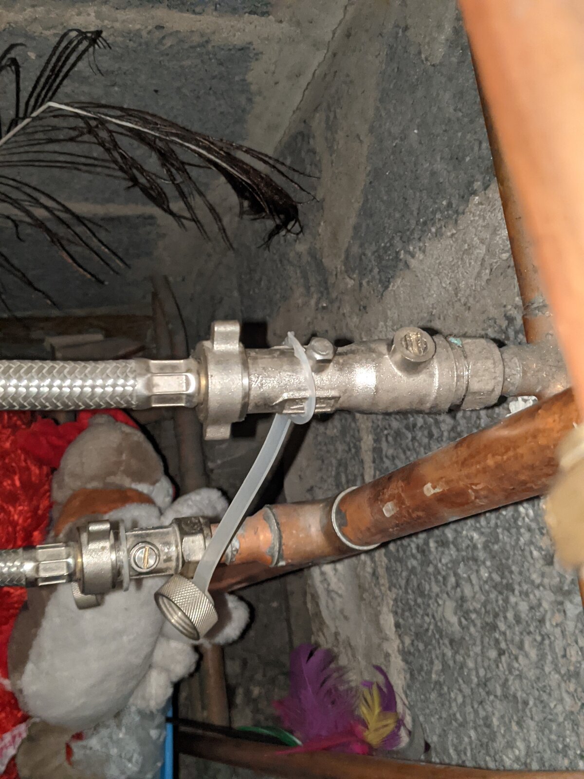

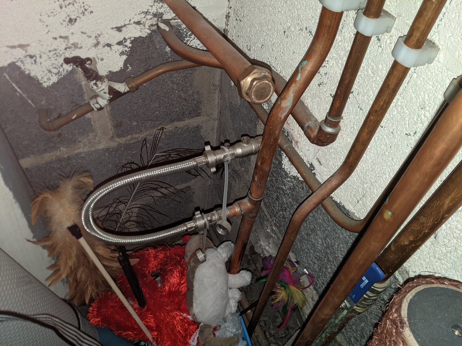

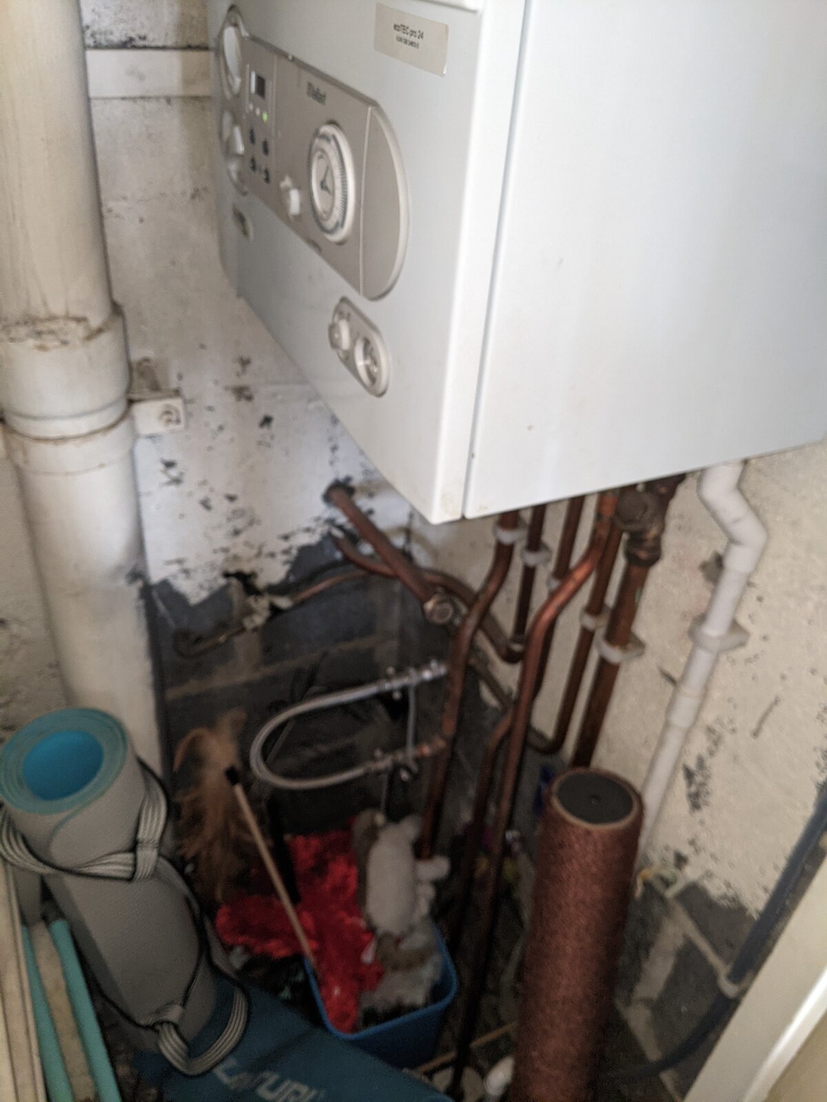

Hi, We need to presurise our Vaillant Ecotec 24, but for some reason there doesn't seem to be a handle on the valve? Any tips on how we can presurise? I've posted a picture for reference.
You need a flat bladed screwdriver....valve at each end by the look of it.
Post close ups to be sure.

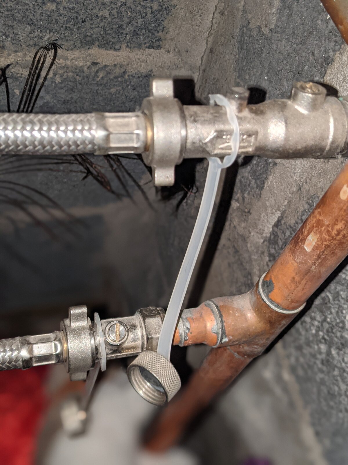

Ah that makes sense, thanks!. I tried a flathead and I could turn the bottom valve and nothing happened but I couldn't turn the top one. Possibly because the thread is a bit mangled. Here's some closer photos. Any tips on handling a slightly butchered valve, also welcome!
Both need to turn...make sure they are left Exactly at right angles to the pipe.
some one has been using a screwdiver with too small a blade tip, it has just chewed the cheap nasty valve
