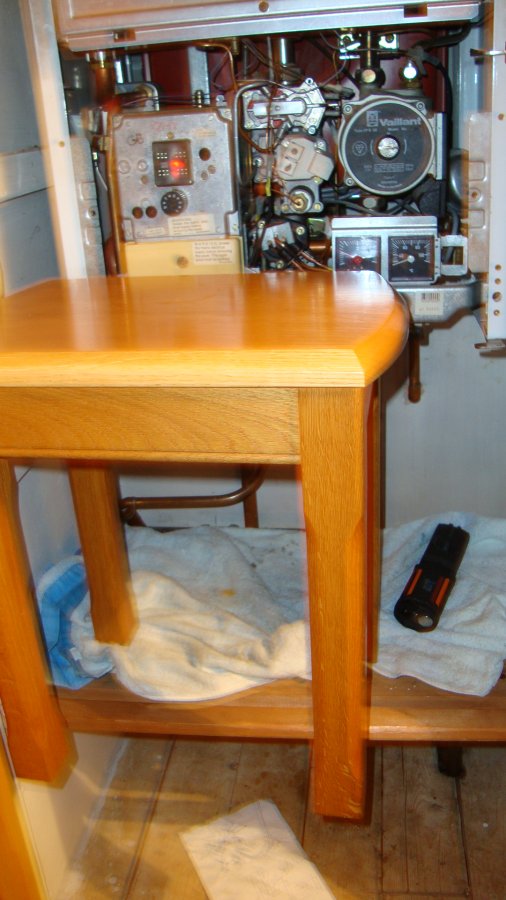

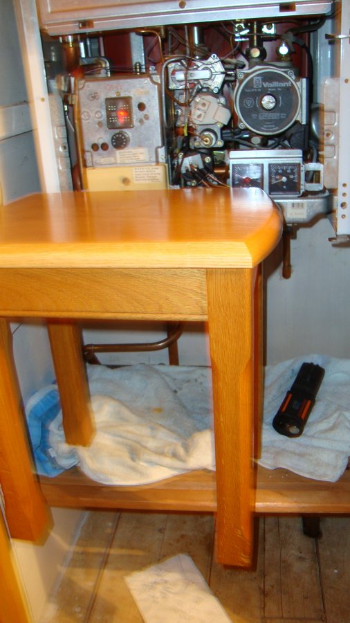

Thanks again to all who gave advice. Bunny if you ever need any help with woodwork related issues, or you need some timber etc , get in touch and i'll help you out, as I have a small joinery business in Wellingborough.
Nice little one like I made earlier !!

nice work ,he would be happy with that, wow i'll say thank you from the bunny , o my god not many generous people like you about (y):mrgreen:
