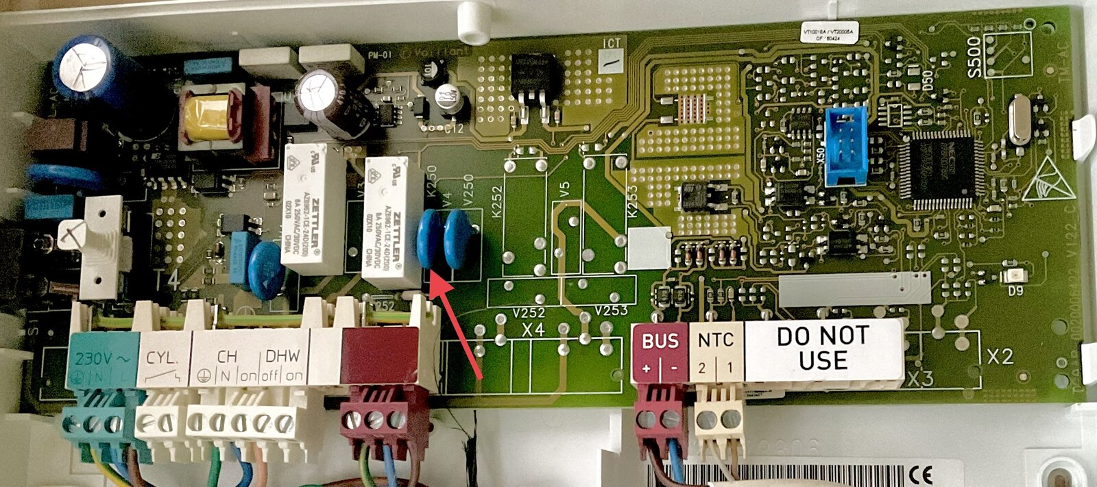

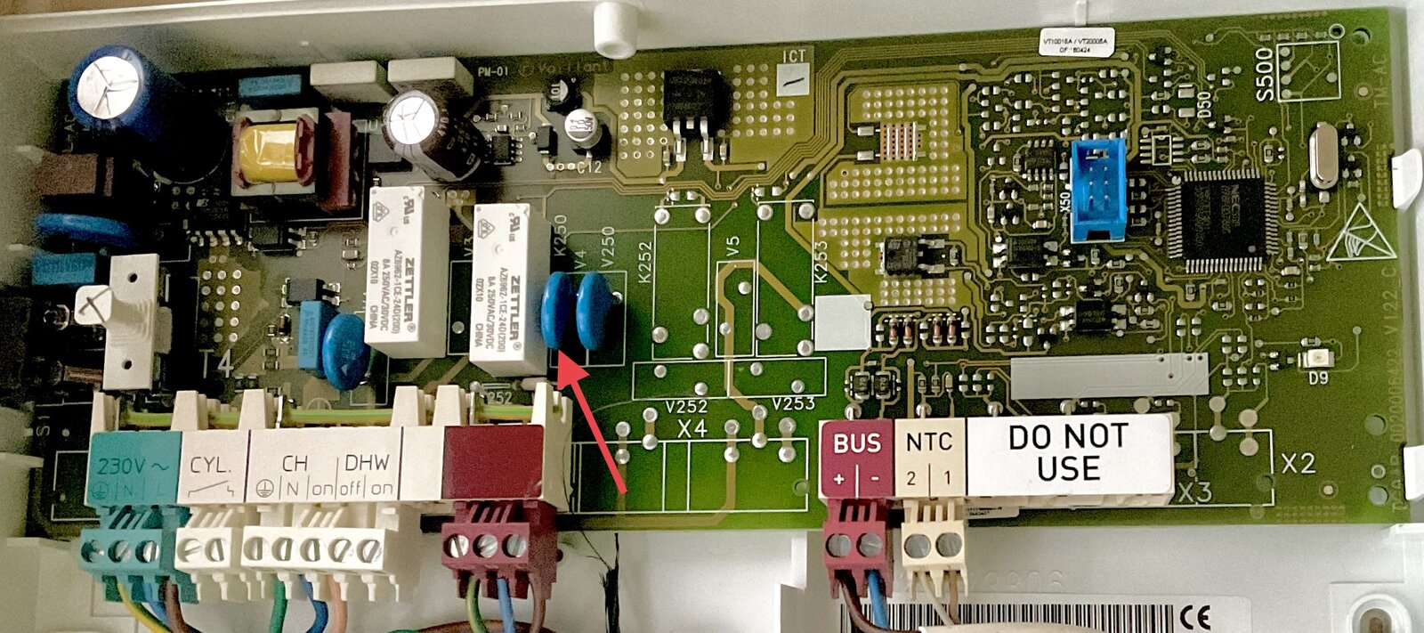

I originally had a VRT392 with the VR65, then a few years later swapped to the vSmart - I’ve attached a photo of the inside…. However, I have got a bit further with my diags and at the moment, seem to have fixed it.
How? I removed the PCB in the attached and was prodding all around with my multimeter, whilst doing so found the S14K275 varistor (see red arrow) appears to be faulty as there is zero resistance. Looking at the circuit (I’m no expert) I’m not sure that would cause the fault as it just loops a leg of the DHW relay back to live when not switched.
I suspect I may have disturbed/reattached something else whilst I was prodding around, or it may have been one of the plugs which I disconnected / reconnected, but at the moment, the CH relay doesn’t come on as it was doing before! not sure how long it’s going to last though but at least I seem to have traced it down to the VR65
