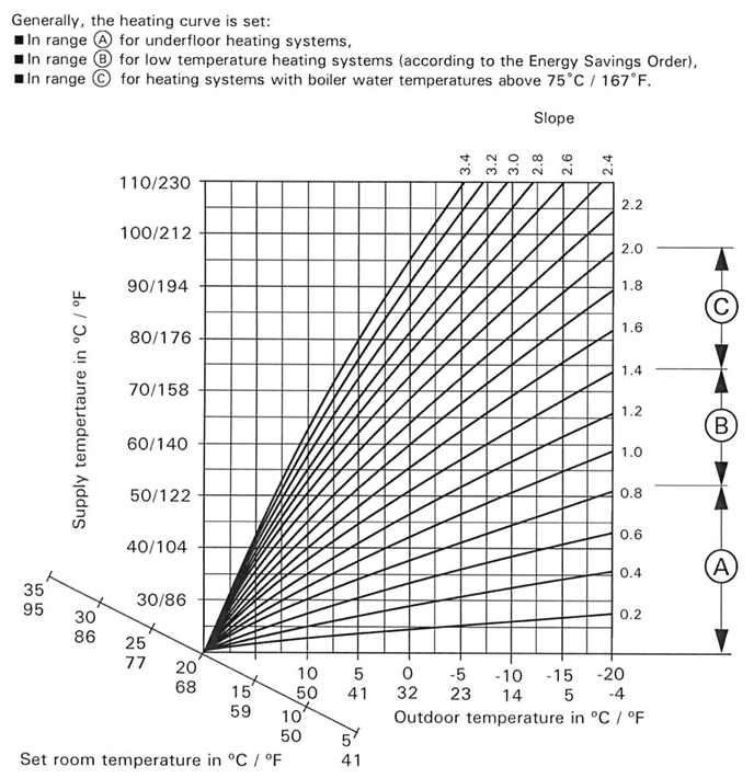

Are you able to set your location to you actual home but tweak the heating curve so that you get the desired effect?
Or have you already tried that?
Yes, yo can do that, of course. The only problem is if in a single moment the external T is above the internal T. Remember that the VSMAR read the external T from internet. In this case, it considers that there is no heat losses and the boiler does not work.

I'm still tuning the heating curve, but the point is to understand how does it work. I do believe that it is the problem where I live. This link was helpful for me:
http://www.hydroheatplumbing.com/resource-centre/what-is-weather-compensation/
I don't know if the attached figure belongs to a Vaillant system, but it is useful to understand how the WC works.
