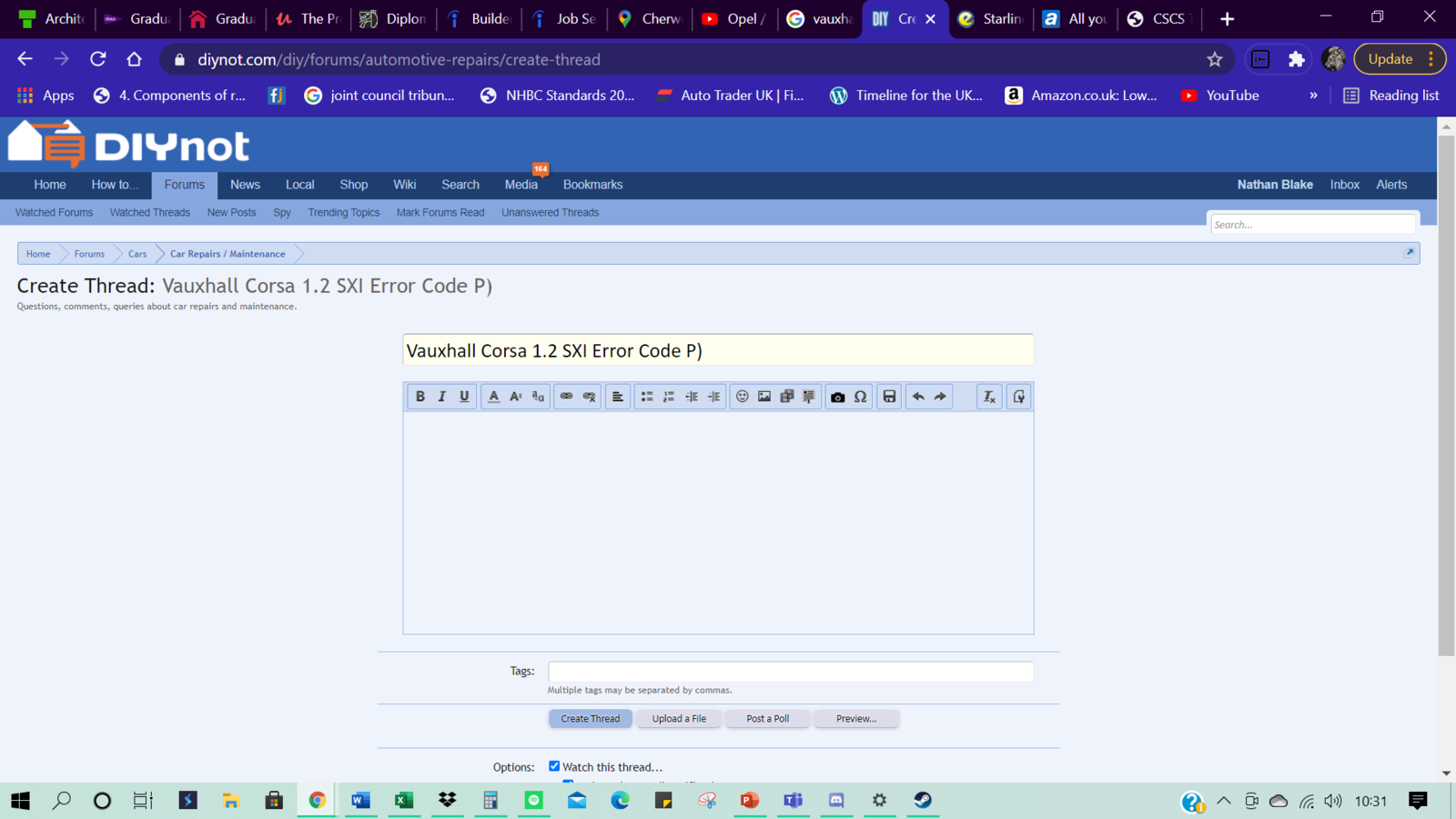

Hi there, I have been experiencing the same problem with my car for a couple of months now, with the check engine light coming and going intermittently, with it staying around longer, and coming back sooner after I clear the codes on my reader.
The problems I've been experiencing -
1) Excess fuel usage.
2) Car surging whilst idle (When stopping and starting in traffic car will stick to 2000 revs when out of gear for a few seconds)
3) Loss of power whilst accelerating.
I have read some solutions online with people recommending to replace the Purge control valve and the Lambda sensors, but I would like to receive some further guidance to pinpoint the issue further to make sure I get it right.
Any replies will be appreciated!
