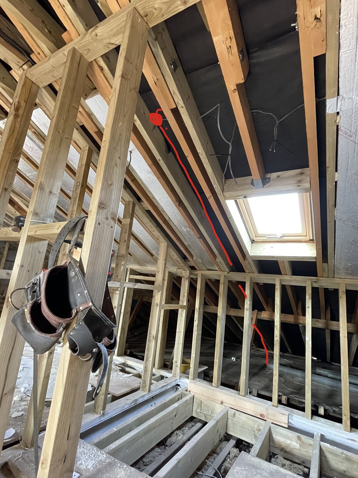

My bathroom in my loft conversion needs an extractor fan. I will be using a remote inline fan.
See below. the red dot would be where the ventilation grill is. the red line is the 100mm ducting.
However, this can only go between the rafters where the PIR insulation board will be fit..... so do I cut a 100mm tunnel into the back of the insulated board, and use insulated ducting?
thought the higher it is, the better?

Yes it is. It’s my bathroom up in my loft conversion. It will be situated above the bathtub. On the UK regs, it says that vent fans must be 2.10m from floor standing .
So I didn’t know I was allowed to put it lower towards the end side of the bath tub as that side is sloppier than the top hence the lower the fan is. I just don’t want the building officer to say it’s wrong and that I have to remove it and relocate it…

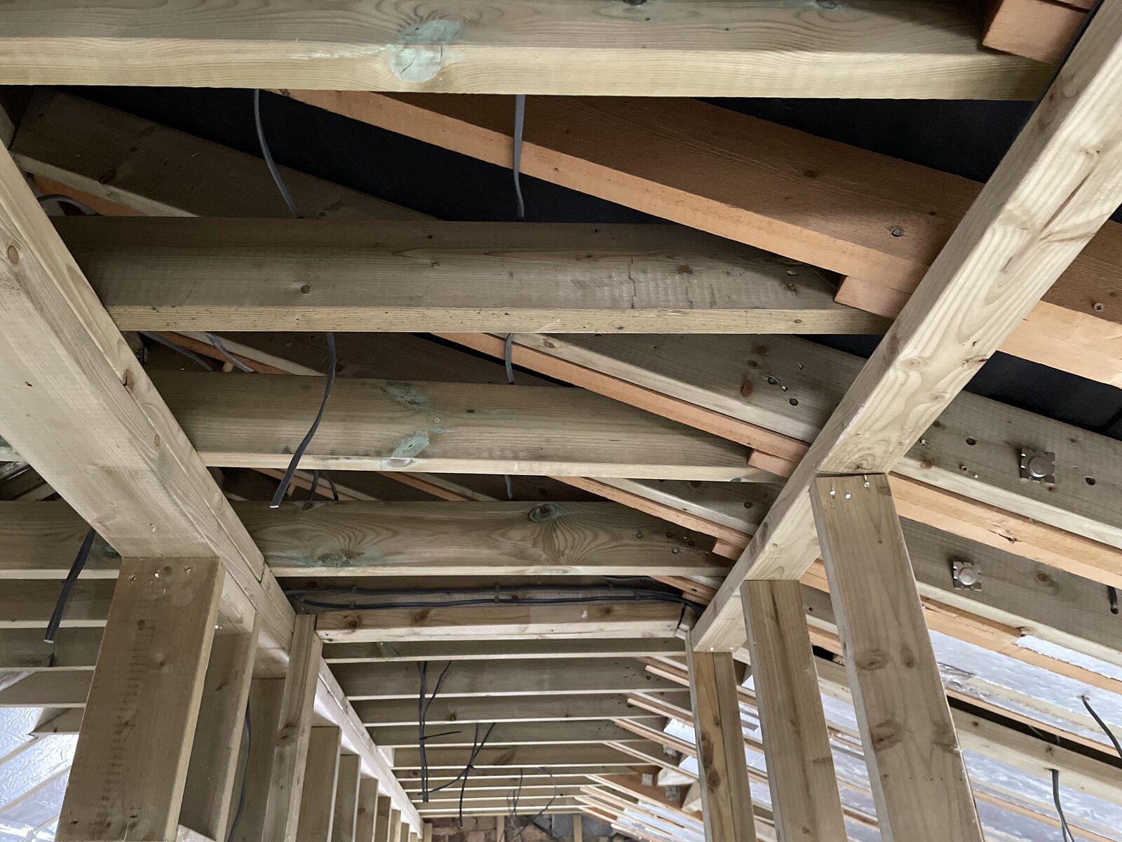

I would use flat channel ducting with a thinner layer of insulation.
That should be enough.
The grille should be directly above the shower for best performance, then your fan somewhere near an access hatch and the vent popping out the side of the roof.

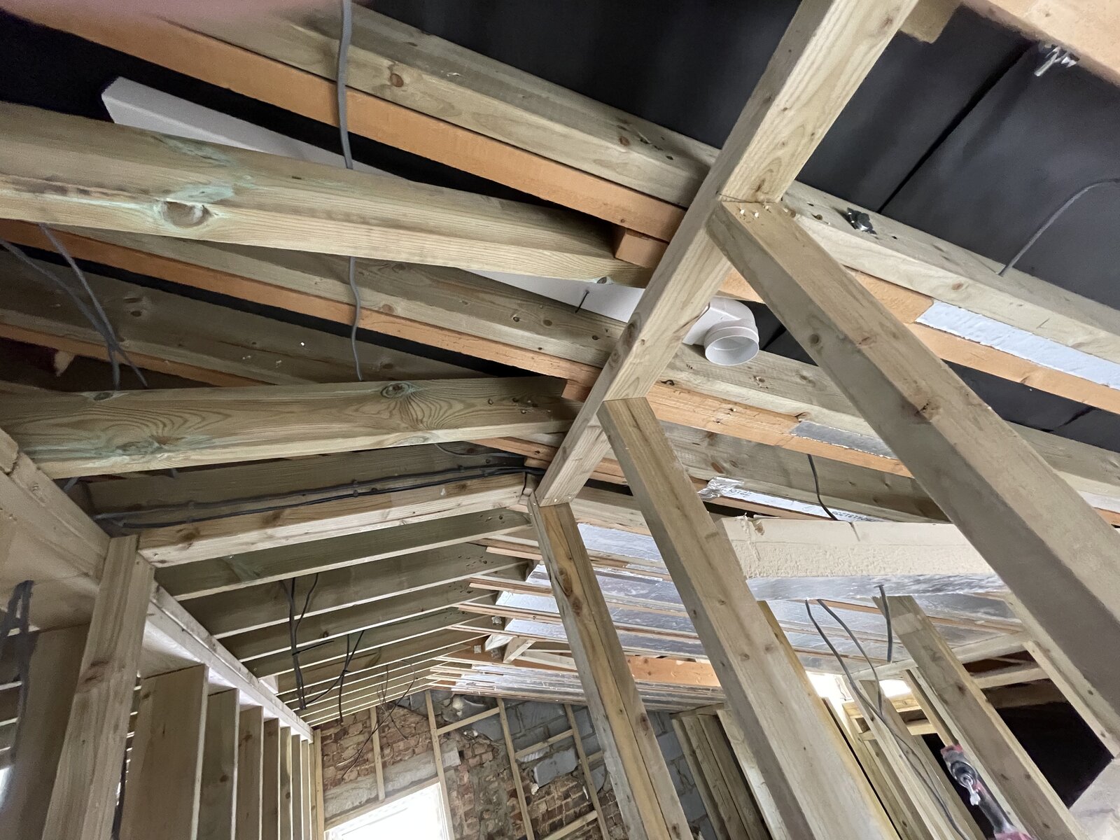

like this:
I will use a IP rated zone 1 extractor instead of inline. Then connect the other end to the roof vent
