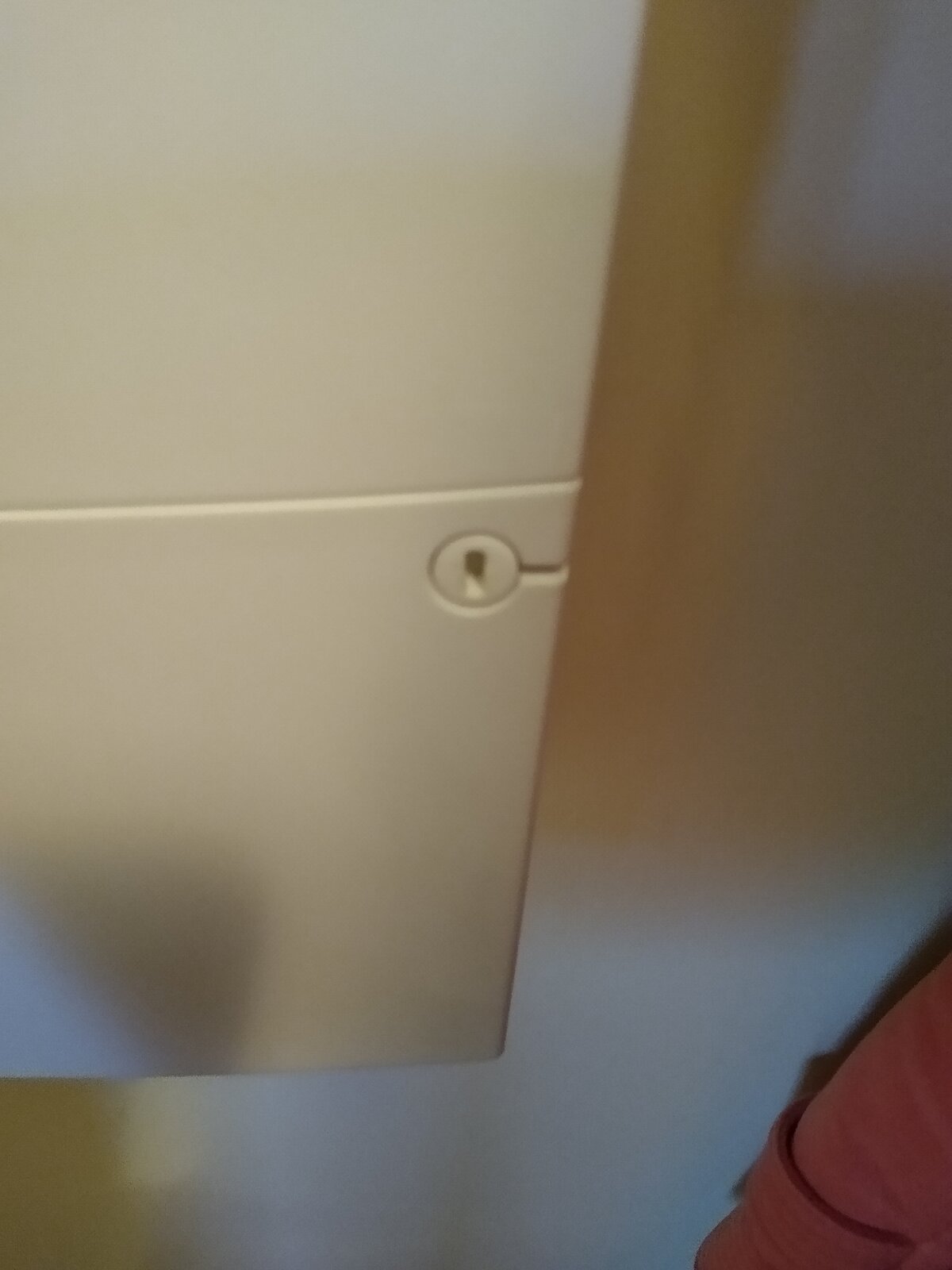

Hi folks hoping someone can help with this quandary...
I Moved into a house with an old Veritas alarm which seems to need a new battery, but I cant get the alarm box front panel off.
It has two white plastic lug type fittings with a flat head slot. These just turn to 4 positions but none of these seem to release to cover.. The only videos I can find show the panel cover fixed by two traditional screws
I don't want to force it and bust anything any ideas?
Turn 90 deg with screwdriver and pull forward. This will expose a pozi head screw,unscrew the screw completely on each side.Lid will then lift off forward.
Dur that seems so obvious now thanks so much.. they came off real easy.... (y) job done and replaced the battery... the old one was 16 yrs old :rolleyes:.
