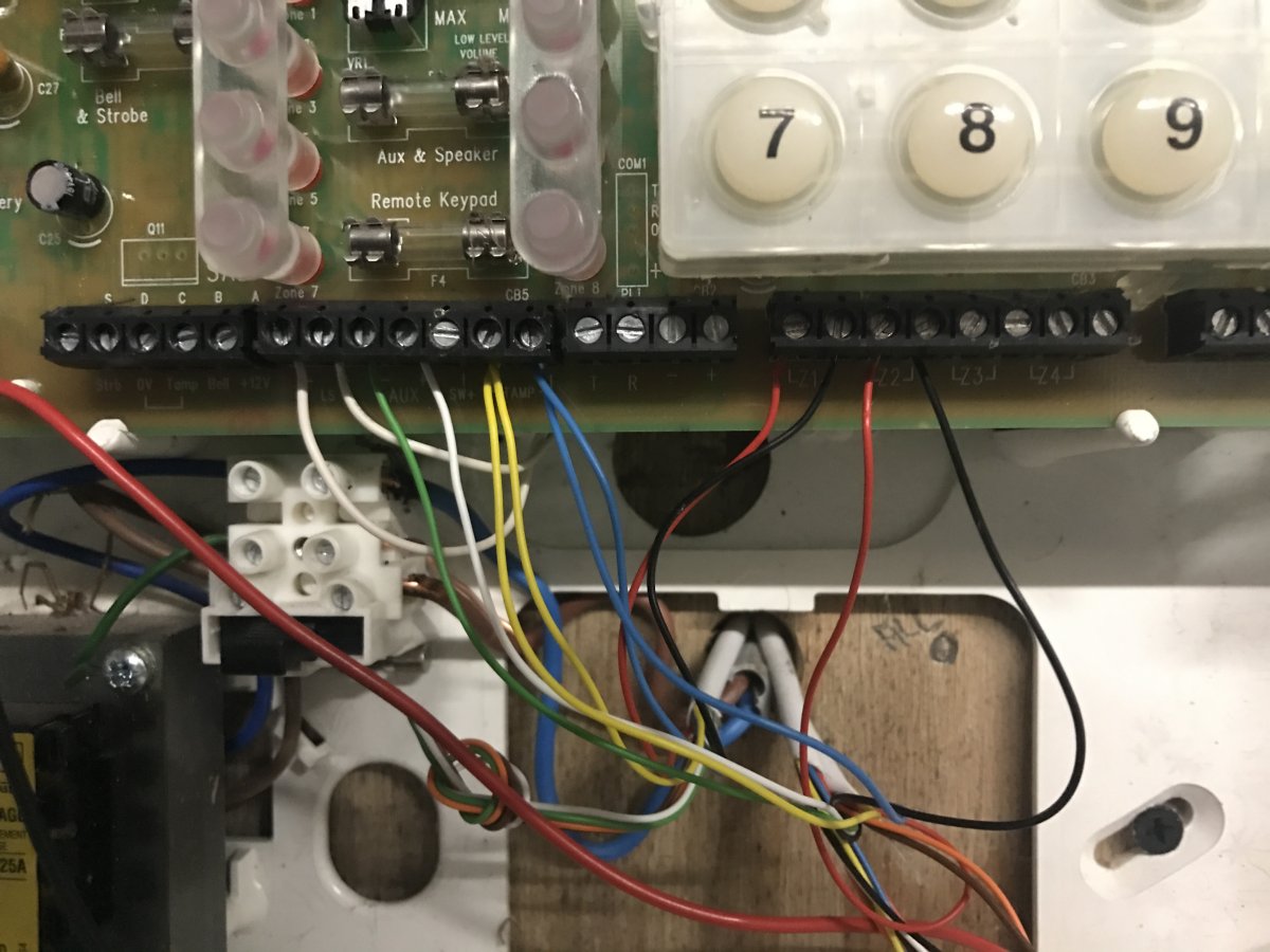

Thanks for your reply, i have sorted most of it out and the tamper light is still on, i have managed to get the pir lighting up, when i do the walk test 06 no zone light comes on only the tamper, unset and power light, i dont have a battery in would that make a difference.
Mick

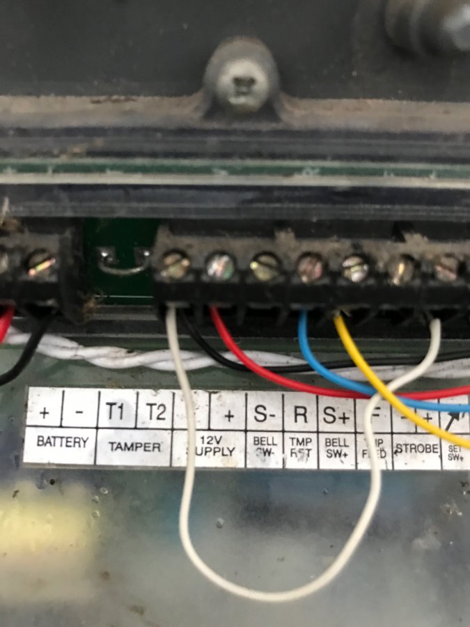

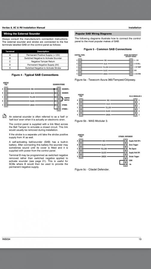

Thanks i have got to wire the bell up yet thats one i am struggling with i have got the wiring diagram for the bell into the alarm but not sure where they go into the bell box.
Mick
Heres the diagram and how i wired it which i know is wrong thats what i am here for.
Mick
Two things .... That's a crappy old guard tec bellbox ....you have it wired to bell trip + , not bell trip - as 99.9% of all uk panels are - bell trip , and the bell feed is not in the correct terminal it's in the strobe -
I would have looped the 0v and tamp in control panel first and close lid to check the tamp lights go out or have you sorted that

Mick,
think its best to do this in stages and confirm the stages working.
When you did the walk test did you press Omit, did any zone lights light up, they should have done but your panel is second hand so could be before that feature was enabled. so lets not worry about it.
You got no zone lights on a walk test with zones 3 upwards not even wired in?
As its a Vertias 8 and theres no extra keypads, you would only get tampers from.
1. power fault
2. bell tamper (link out 0v and tamp)
3. panel lid tamper (close the lid and screw it down, should here tamper click shut)
4. global aux tamp, lablled as Tamp on the panel put a link across these two, at the moment you have two blue wires and two yellow wires in these terminals, they should be wired in series but you can do that later, to be honest you have spare zones, so I would link this out and wire into your spare zones and have the zone type as tamper.
Once you have done that we can look at the bell.
but want to know the sequence you went to do the walk test in as nothing showing suggests to me it wasn't taken into walk test.
Secure i am ,
Thanks i put in the engineers code pressed 06 as the book said and zone 1 and 2 lit up along with zone 3 but 1 and 2 lit up when i moved or opened the door 3 went off when i pushed the the tamper spring on the box
The blue and yellow are in the tamper because it says in the book to put them there. As you have figured out by now i no very little about these things, really appreciate your help.
Mick
bell wiring.
12V supply + Red Panel A
12V supply - Black Panel D
S- blue Panel B
R Tamp return yellow Panel C
Strobe - (what you got left?) Panel S
(if no more wires you can link the bell trigger in the bellbox, to the S- in the bell box)
Take a wire from the 12V+ and wire to strobe + in bell box
Tamper feed may need wiring to 0V
Theres two ways to look at it.
1. the global tamper and bell tamper show up as the same number in diagnostics if you have it available.
2. having the tampers on seperate zones in your case would help you identify the problem quicker, as you be looking at a different zone number for each device. aslo the diagnostics would mean the tamper that shows which could be bell or global would just be the bell.
