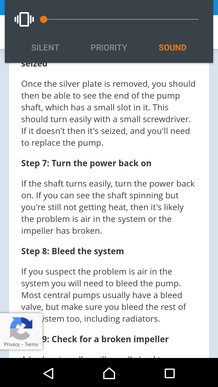

The pump seems to be moving the water, however Pump is getting very hot indeed, I've removed the small metal disk and it does spin freely and doesn't make a noise, please look at attached advice, is this suggesting that I turn boiler back on with the metal disc removed? Won't that throw scalding water at me??

It might run at 85 degrees depending on the settings...that's always going to feel boiling hot given bathing temp is 40-45 degrees.
Is it hotter than the pipes going into it?
your pump is meant to be hot it has very hot water passing through it
