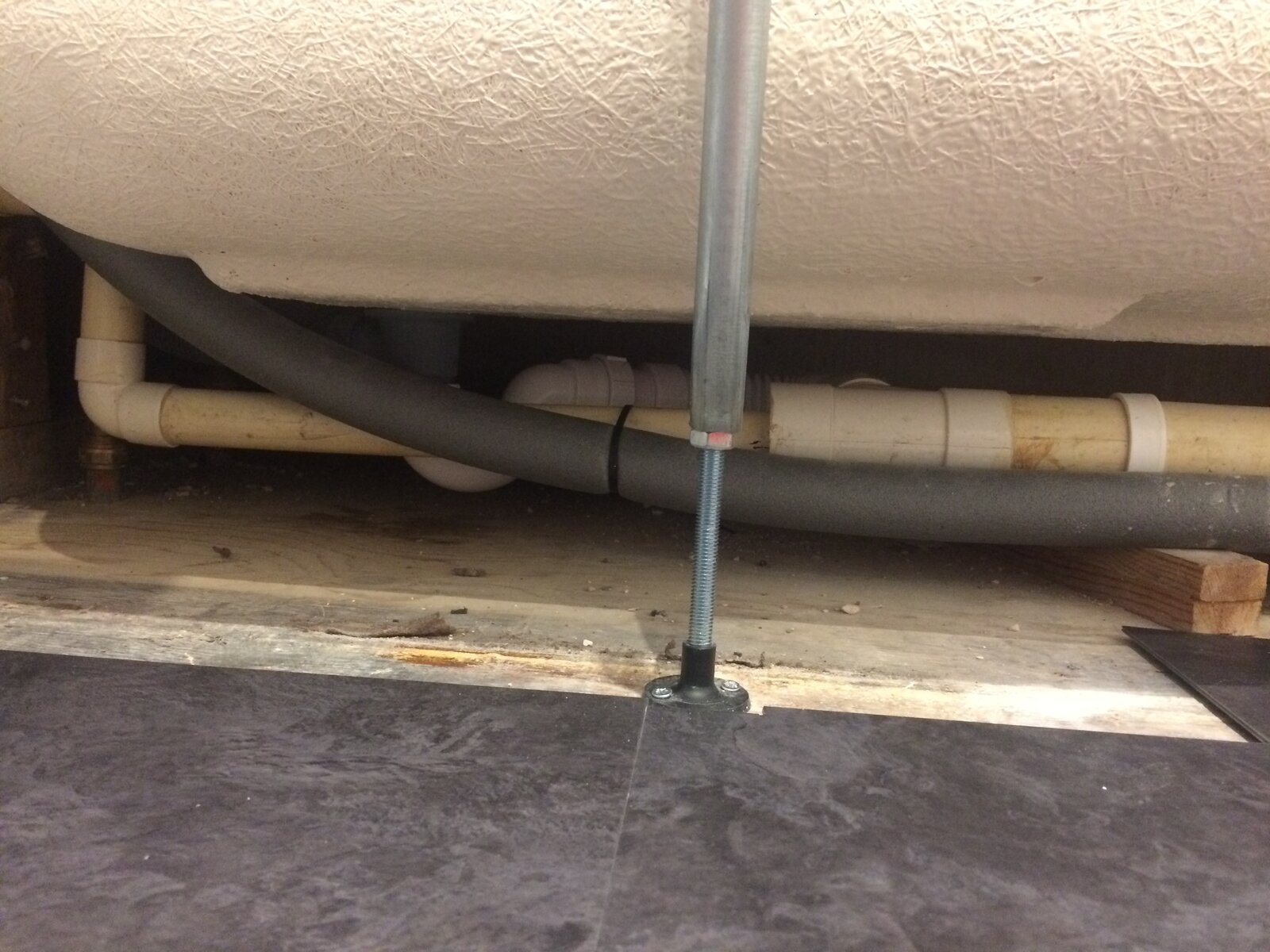

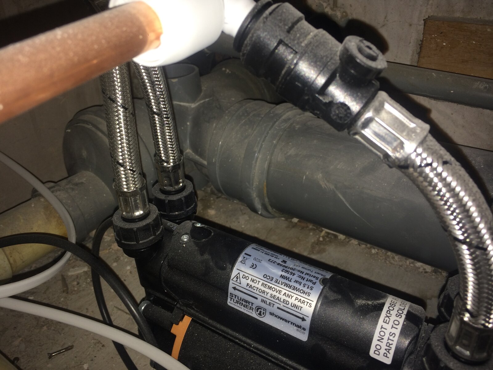

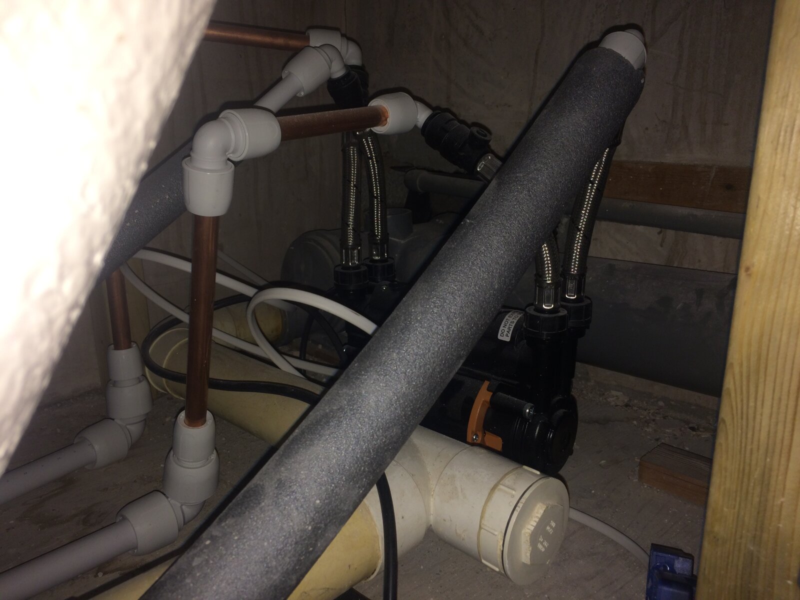

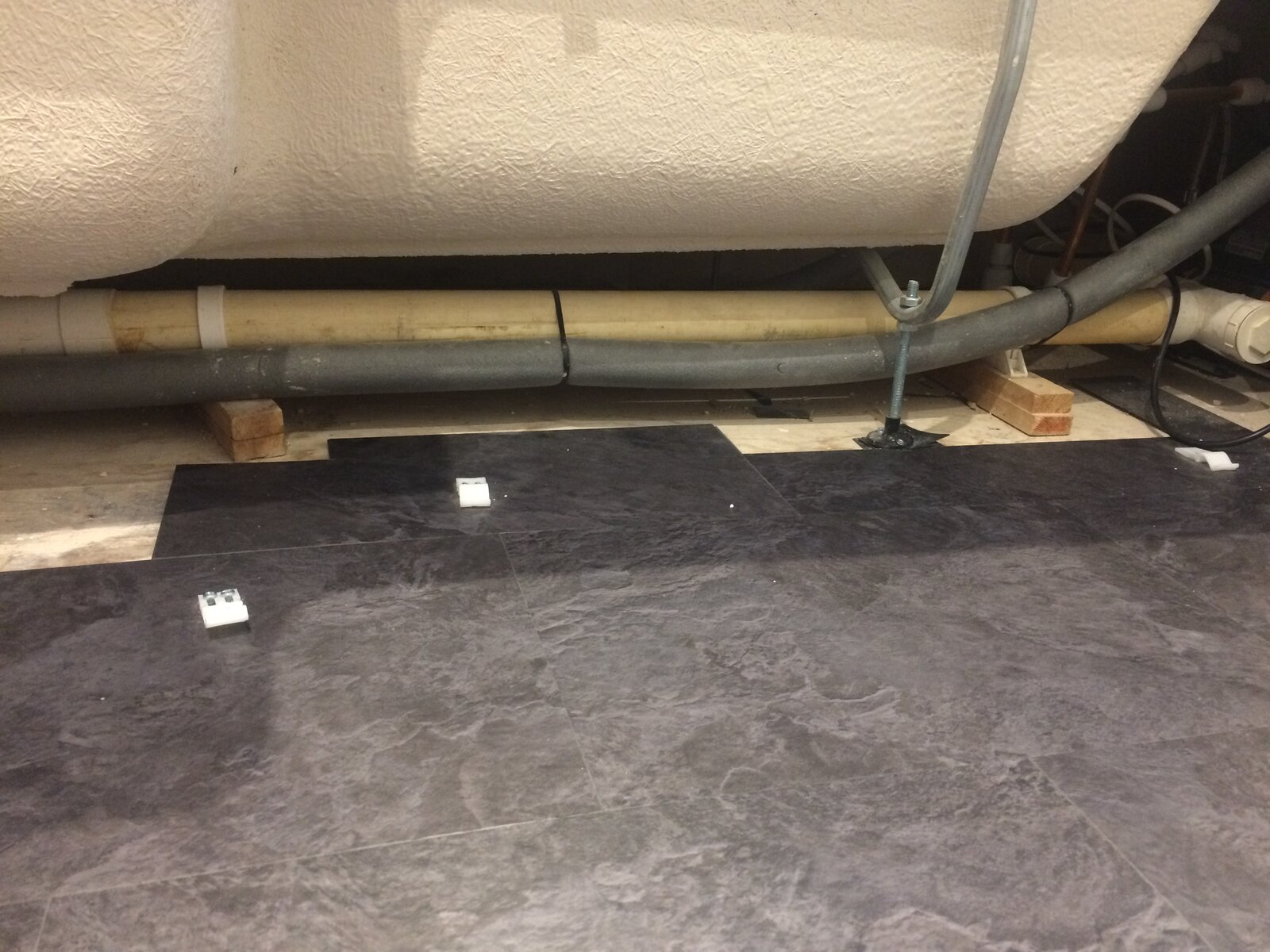

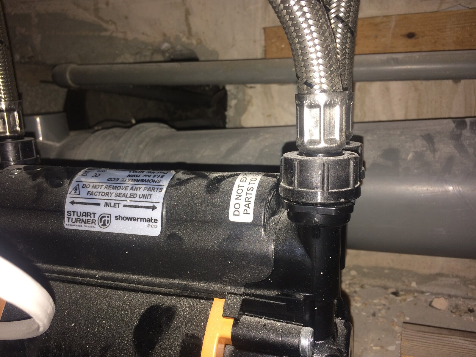

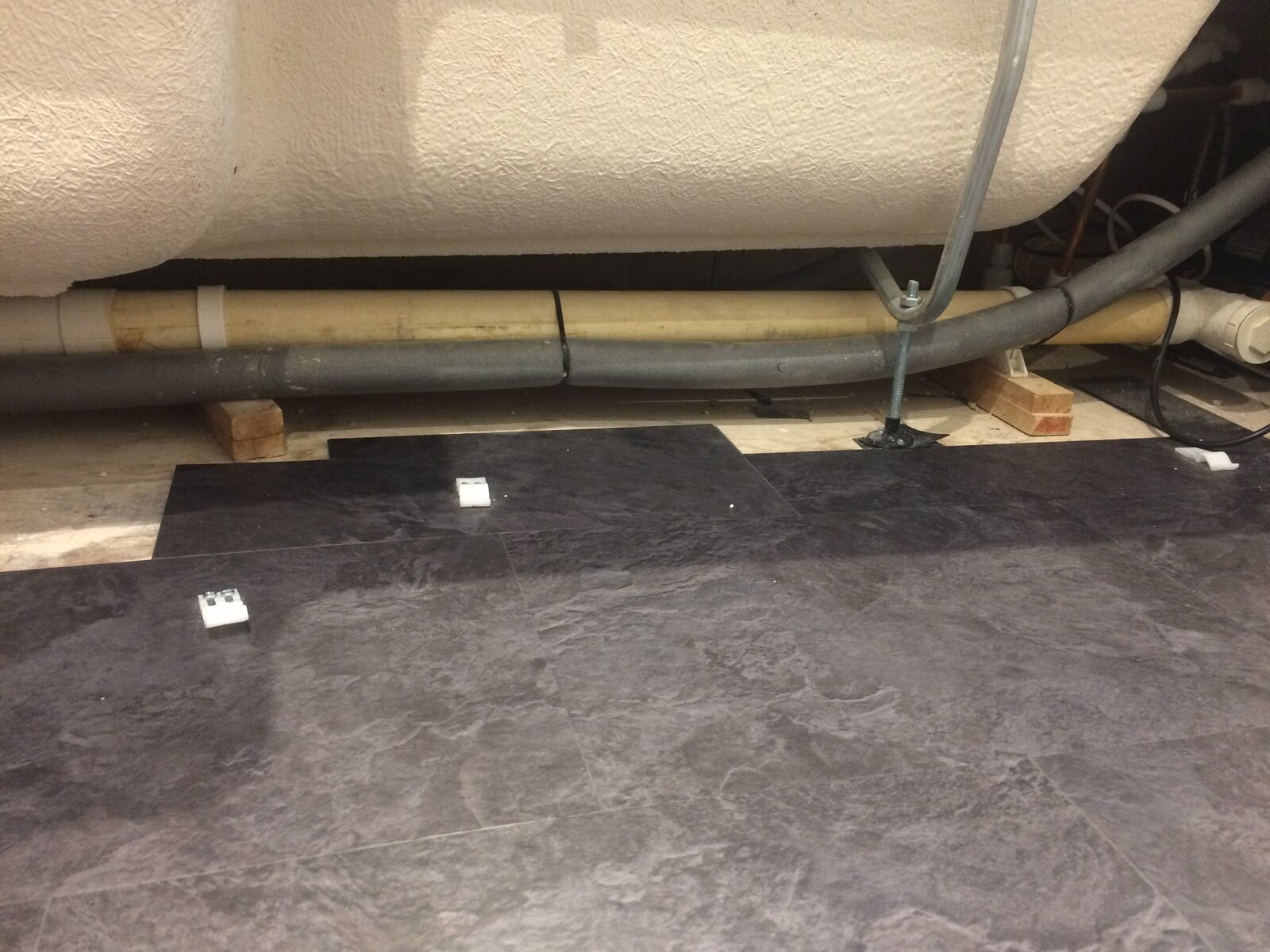

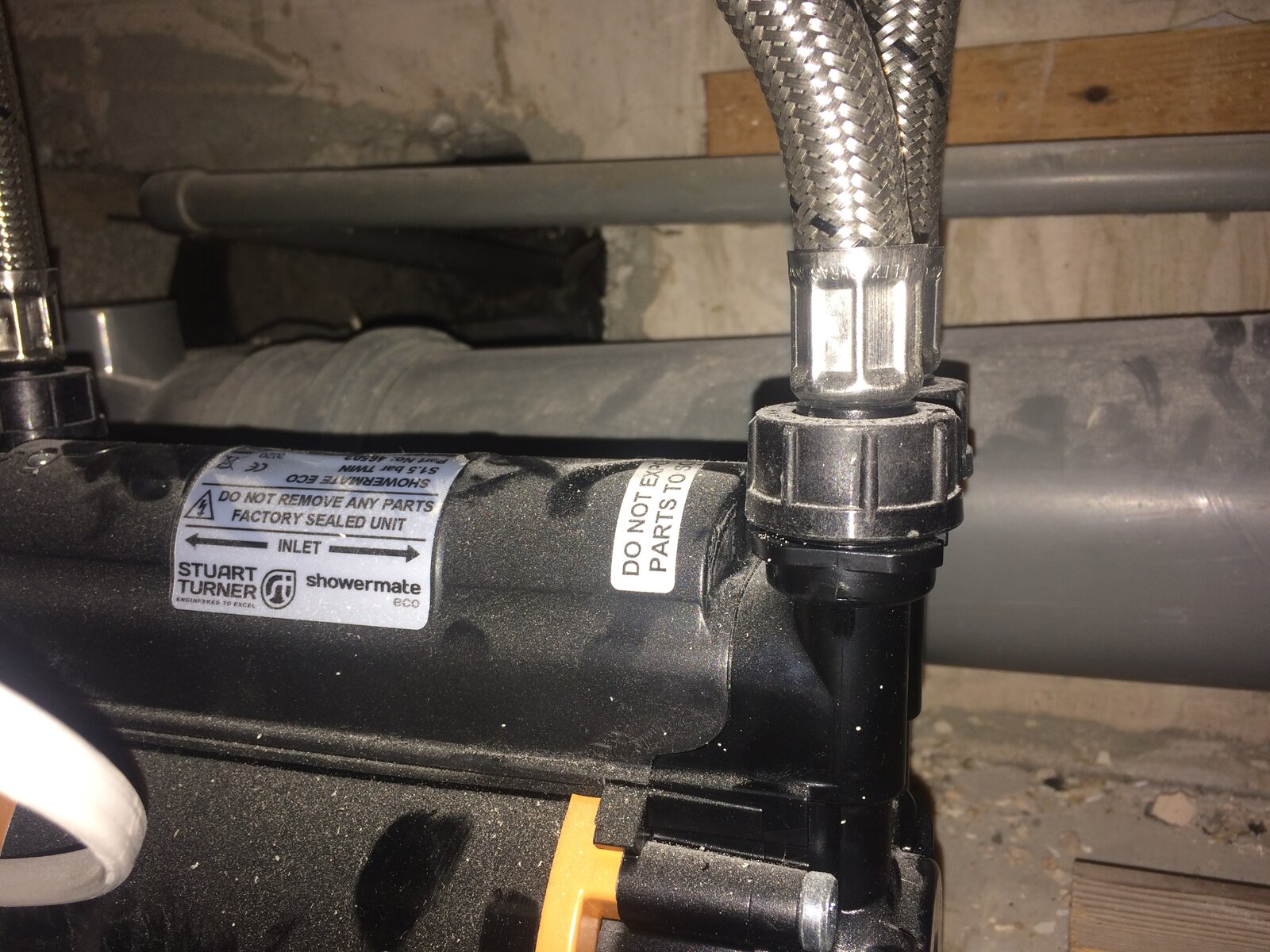

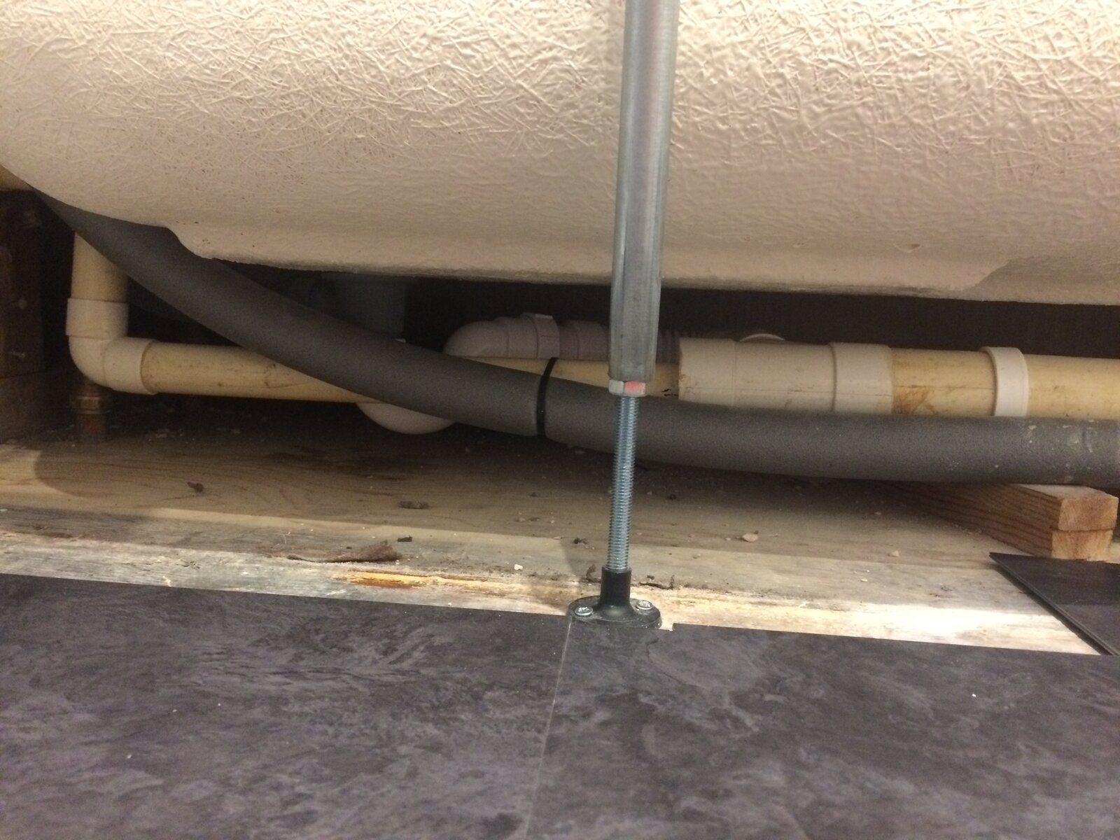

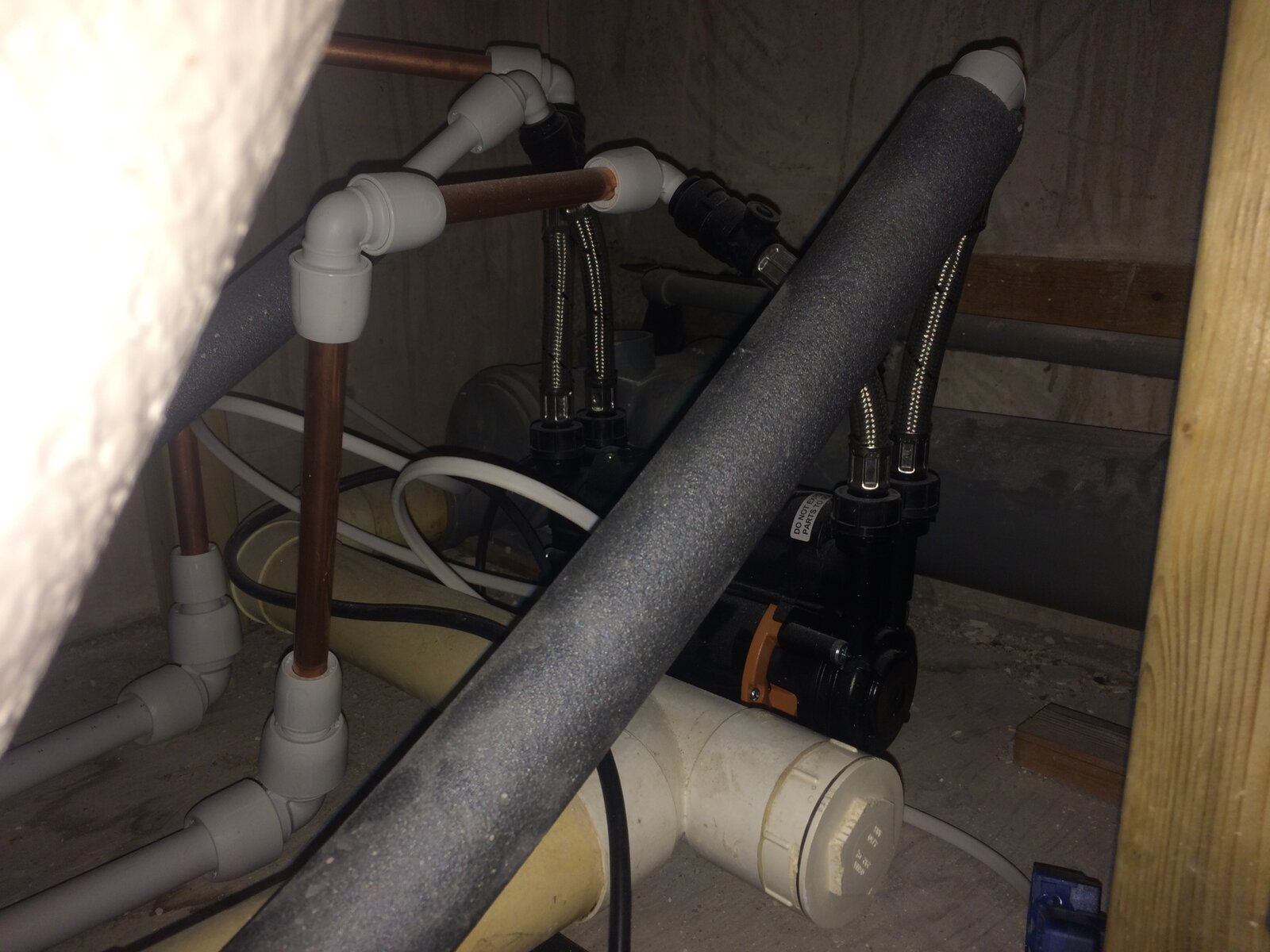

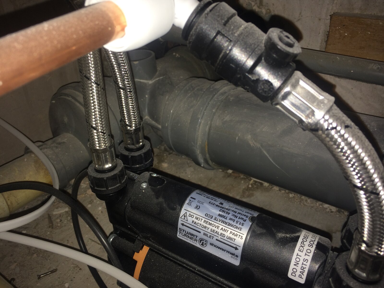

Uploading some images of the pipe work from bottom of the bath to waste pipe exit out the wall

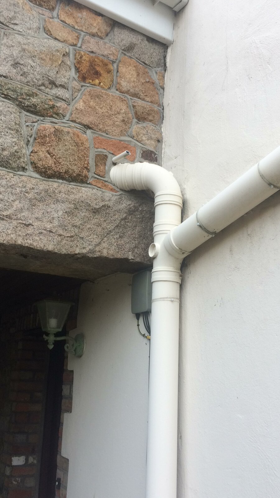

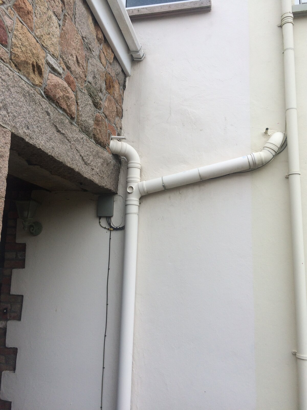

Not as far as I am aware, Looking outside its all clear at the bottom as part way down the pipe our neighbours waste connects in to it and they don't have any problem so assuming the blockage is at the top before it gets to the vertical drop ??

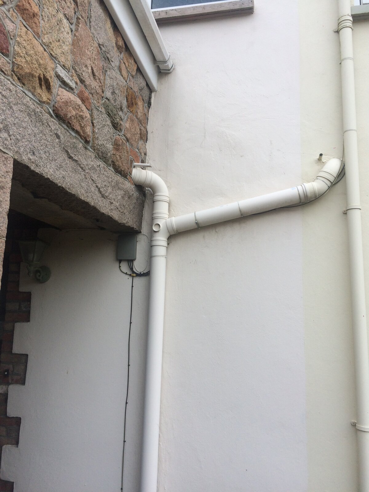

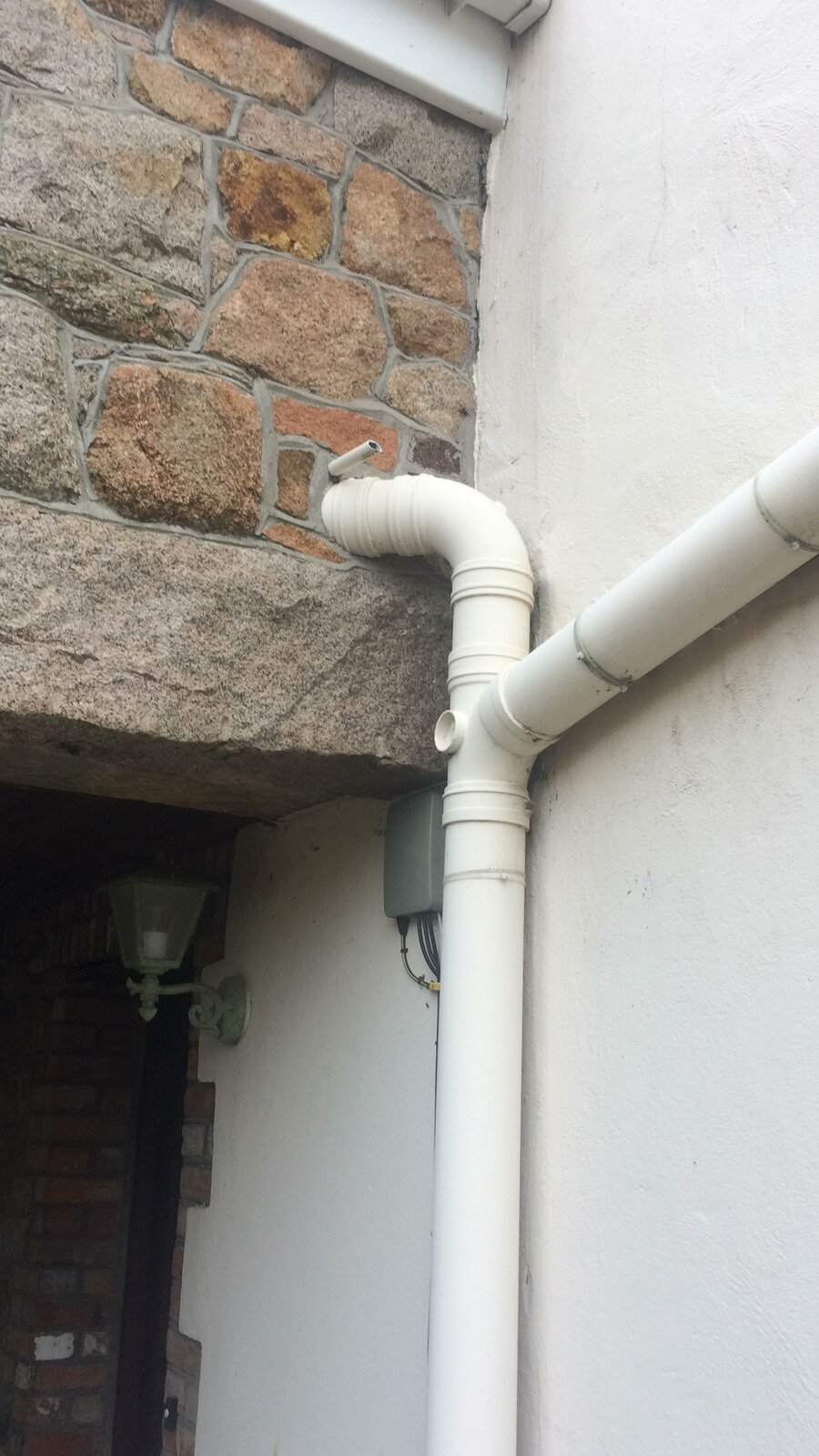

Attached a photo of the outside view of the pipe work (ours is the pipe exiting the granite wall)

Is there a vent pipe?
Andy
Not sure I can't see anything obvious, where would I find it other than near the pipes on the photos I have put in the thread ?
I only have the 1 bathroom upstairs no other bathrooms or toilets and then a kitchen with water supply downstairs
Is that the bath waste going into the bottom of a horizontal soil branch?
They appear to join at like a T junction and then they drop vertically outside the house see the photo further down the thread. This is how it has always been before and was never any issues
How long exactly is the section from where it exits the junction shown under the bath, to where it emerges from the external wall? Doesn't look to me to have too spectacular a fall on it, and possibly even a slight backfall. That would be enough for waste to collect and start to build up which may well be the cause of your issue.
Whole thing is a bit of a pigs ear to be honest, you've no way of getting into it to clear anything that is in there without cutting into the pipework....
Can you take another photo of the exterior pipework please, ideally from further back, interested to know what the pipe to the right of the stack is.
From the T junction it is only about 30-50cm to where it emerges from external wall
Yeah the plumber wants to cut the pipe towards the end of the bath and put a non return valve and hopefully rod down towards the main waste pipe at the same time.
I'll take another photo in morning but the pipes to right handside are for the neighbours house waste and drains not to do with are house, they havent reported any drainage issues.
Plumber's idea is a bodge, but without major reconfiguration, it's probably the easiest option to get you flowing again for now. Long term, the 110mm pipe needs to be checked for fall, and realigned if fall is insufficient. Wastes really need rerouting independently to outside the building and then connecting into the stack at a suitable point.
Stack also really needs some sort of ventilation on it, at the minimum an Air Admittance Valve, I am just wondering if the Neighbours pipework offers the drainage some ventilation, hence the question.

Thank you i'll take a photo tomorrow from further back to see if neighbours pipework does have some form of Ventilation.
