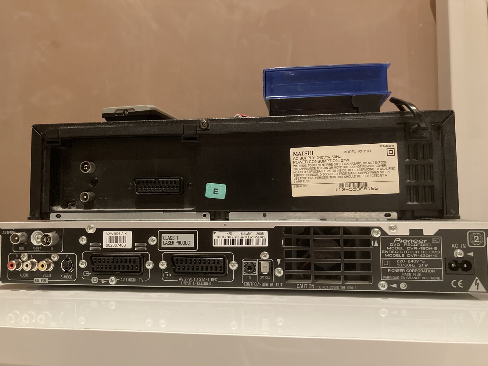

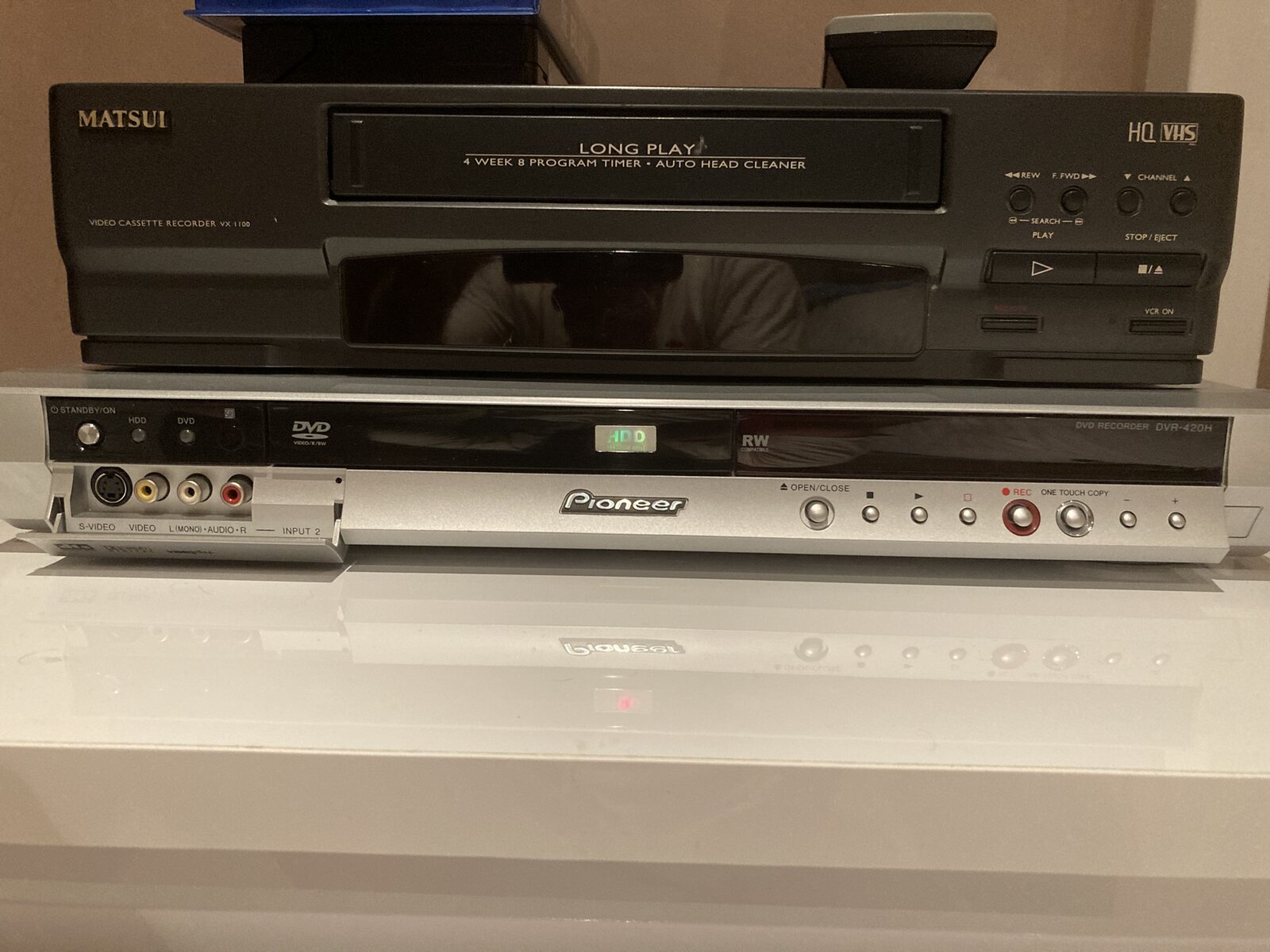

Hi there,
I'm looking to copy some family videos onto DVD for safety and prosperity for my dad.
I have an old Matsui VHS player and a Pioneer DVR-420H dvd recorder (it has an internal hard drive also), both in good working order
  1. Can anyone confirm how i hook them up please as the video recorder only has a single scart ?
  2. Do i need a scart to composite cable (red/white/yellow) ?
I have attached a photo showing the front and rear of both devices (see below)
thanks in advance
Great photos. Thanks for takig the time to do that.
Either a SCART to composite + audio cable as per your point 2, or a SCART to SCART lead going from the VCR to the DVR AV2 input socket. Either will do the same job.
VHS only uses composite video and stereo audio. SCART carries that in either of the cable forms above.
I forgot to ask Lucid…..I assume I can use AV1 scart and hook it up to a TV so I can see what’s playing, yes ?
Yes, AV1 is an Out-only SCART connection designed to be connected to a TV. The only thing to be aware of is that a SCART like this can carry composite and RGB versions of the signal for displaying on a TV. The selection is made by a software choice in the recorder's menus. In the days of CRT TVs and flatscreen TVs with SCART sockets then the TV could be changed to match the signal output, and so if you didn't get a picture on the TV screen then flipping over to the alternative choice between composite video and RGB would fix it.
Modern tellies don't have SCART sockets that much any more. That means they don't have a video RGB input, and so there's no easy way to display the RGB signal if the socket on the recorder is already set to RGB output. You might have to resort to using an older flatscreen portable with a SCART input in order to see the menus before making the recorder video output change to composite video.
