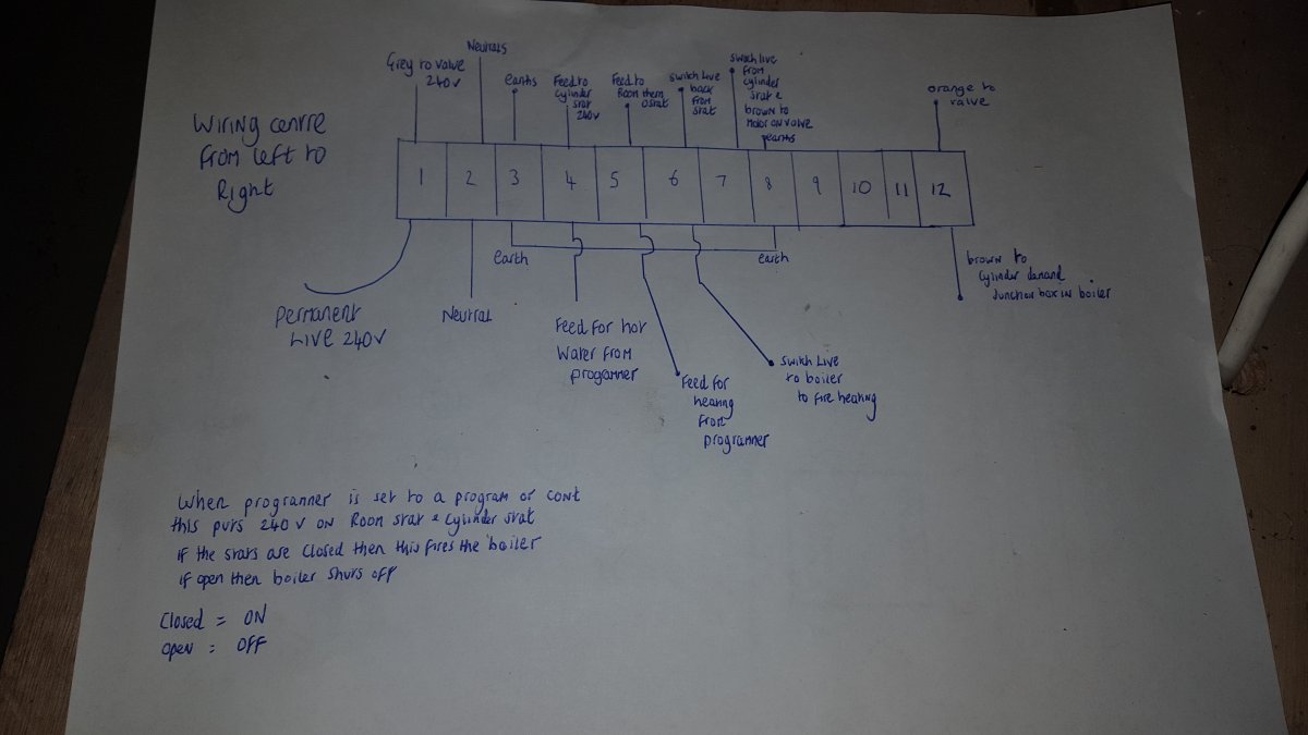

Has anyone here wired the above boiler with a cylinder stat and a room stat via a 2 channel programmer?

It's a combination boiler used on kind of a S plan
Valve for hot water only..
Cylinder stat set to 60 but boiler running continuously i.e cylinder stat not switching off ( water is red hot)
or incorrectly wired?

Did it ever work correctly? The heating works but when the cylinder stat is up to 60 degrees the boiler just shows the tap symbol so the heating doesn't get a look in
What temp is the boiler set to? It must be higher than the cyl stat. What actual temperature is the tapwater?
Boiler was set to 6 about 80 degrees
Who wired it?
I wired it
In that case drawing of how you have wired it and pictures of actual wiring terminations on valve and boiler would assist in crystal ball gazing
You have never answered the question about what temperature the boiler is set to provide.
While heating hot water, the boiler needs to be set to provide about 10 C above the set water thermostat.
The cylinder stats are not exactly precision devices and it is difficult to set them to a particular cylinder temperature based solely on their calibration without measuring the actual water temperature.
