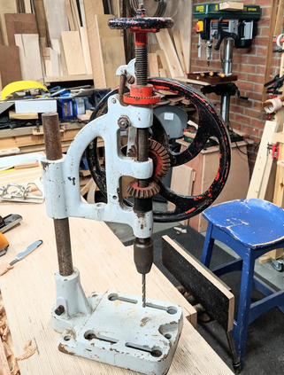

I have got a very old vintage bench pillar drill. It drills OK materials such as hard plastic and soft metal. It cuts clean holes as expected.
But when it is drilling wood, it always tears the holes making messy around the edges of the holes. It doesn't matter what type or size of drill bits used. If it is wood or MDF, then it will tear the edge of the holes.
What could be this problem?
It cannot drill hard metal / steels at all due to lack of power. (The rachet mechanism doesn't work)

The other drills - electric and battery powered drills cut clean holes with the same drill bits. So I was wondering if there is problem with the chuck of the hand cranked bench drill? Or would it be due to the fact that it is not clamped level on the work bench? But then when using the other hand cranked brace / chest drills, they are cutting clean holes no problems. It is only this vintage bench pillar drill which makes messy cutting on the drilled holes on the wood.
It seems same problem with the smaller drill bits as well. But it cuts beautifully clean holes on the knots of the wood, soft metal panels and plastics.
Drill bits are designed to rotate between a certain speed range (proportional to the drill size). Can you rotate the drill bit at the same speed in your hand cranked drill as you can in your electric drills?

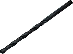

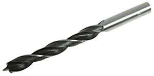

Firstly, I think you may be trying to use metal twist drills on wood, which as Harry says is not going to work all that well. When drilling wood the drill bit needs to have a "nicker" on the outside of the circle you are cutting to shear the fibres before they are lifted. You also need some type of centre point to keep the drill bit going in a straight line. The modern (i.e. post-WWII) tool to use is called a "brad point twist bit", also known as a "lip and spur bit" which is similar to a metal twist drill, but is modified at the tip:
Above: Lip and spur or brad point twist bit for woodwork
Below: Jobber twist drill for metal
The right type of drill bit is fortunately cheap - take a look at Tool Station's offerings, but they normally only go up from 3mm to 10 or 12mm

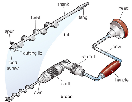

I think the type of bench drill you are using wasn't really designed for wood, either, or at least not in the way we think these days. Most of the old wood bits you'll come across have a 4-sided (square) tang at the end and are designed to be used in a brace:

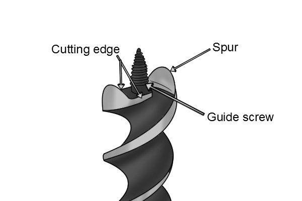

which generally require a 2-jaw chuck with a tapered receiver on the inside of the shell to hold and drive them. Unless you saw off the tang they won't work in a metalworking 3- or 4-jaw chuck. The other issue with woodworking centre and auger bits is that they invariably gave a threaded point, which is designed to pull the bit into the wood:
(Note the spur which slices the fibres of the timber).
Your drill is designed to self-advance as the handle is turned so any drill bit with a guide screw will be fighting the feed mechanism of the drill.

I used the Lip and spur or brad point twist bit for woodwork, you mentioned with the photo for drilling into MDF and also solid wood board using different sizes from small to medium and large too. They were consistently not clean cut.
I used the metal cutting drill bits for the wood, just for try, and it was a little better.
Yes, this is true. The chuck is keep going downwards as the drill handle turns all the time. It doesn't help cutting well, because the drill bit gets stuck in the wood while cutting due to the slow turning speed.
So perhaps it is just limitation of this old hand cranked bench drill?
The chuck has 3 jaws just like the ones of modern battery powered hand drills.
You didn't mention that to start with, but in that case the bits you are using aren't sharp enough for the rotation speed you are achieving - brad point bits were designed to be used in portable power drills, and they run at 1000 to 3000rpm, but I have been able to use them in the past with a dual pinnion "egg beater" drill by spinning the drive crank really quickly (for dowelling, but I decided life was just too short in the end)
I think it isn't a limitation at all, I think you may well be looking at the wrong materials to drill with the wrong type of bits.
More modern type of drill with auto feed (upper) of a style made by Flott, Metabo, etc from the 1930s to the 1950s, earlier type with multiple speeds and manual feed mechanism (lower)

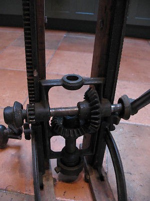

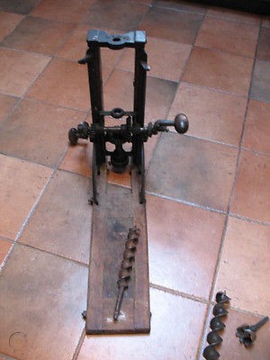

Its not a mortiser is it?, some pictures would be nice
Hand cranked mortisers like the Ajax below generally take square tang auger bits or large hex tang bits (secured with a thumb screw), are designed to sit on top of the timber beam (you then sit on the flat part to weight it down) and I don't think they self feed
There are still some timber framers using these despite none having been made for 70 or 80 years. If you think about it, mortises require a fair amount of power to chop and if the OP's tool can't drill small holes, what chance is there that it can chop a mortise.

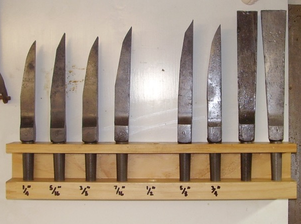

As it happens there is another type of hand mortiser which you will come across from time to time that looks like this:
which uses chisels like these:
As you can see they are not small tools. These disappeared from catalogues between the wars when electric powered mortisers came in in a big way but quite a few were converted to use an electric motor and carry a square chisel set. They were once universal in carpenter's shops and so common were they that they still surface from time to time. although generally sans chisels, which are now very hard to get hold of
