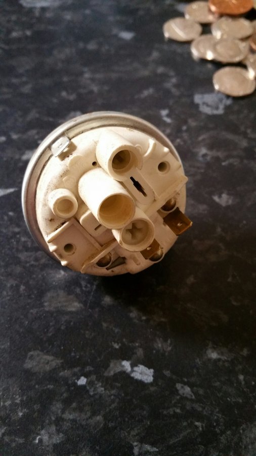

Sorry, was emptying boiler cupboard. An air pressure switch. The image below is of the switch that was replaced.

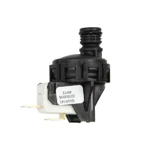

The image below is the new pressure switch.
No they are both LOW WATER CONTENTS SWITCHES and are interchangeable, it sounds like you have either really dirty system water which is blocking the very small orifice to the switch or you have a pump problem which might be sticking would be unusual to get two of these switches faulty a very easy test with a multi meter when the boiler faults

ianmcd thanks for that. Right now the guy thinks it's either the ignition switch or main board. He's off to see what he has in the van.

Doesnt have an ignition switch I think you mean Ignition control PCB if it is locking out intermittently then it is likely to be this, but by-passing the low water contents switch would have absolutely no effect on this , this is not hard boiler to fault find on
Intermittent fault. Sometimes power not being sent to the fan so the boiler won't fire up. Diagnosis is a fault with the main board. Many thanks to the guys that replied.
