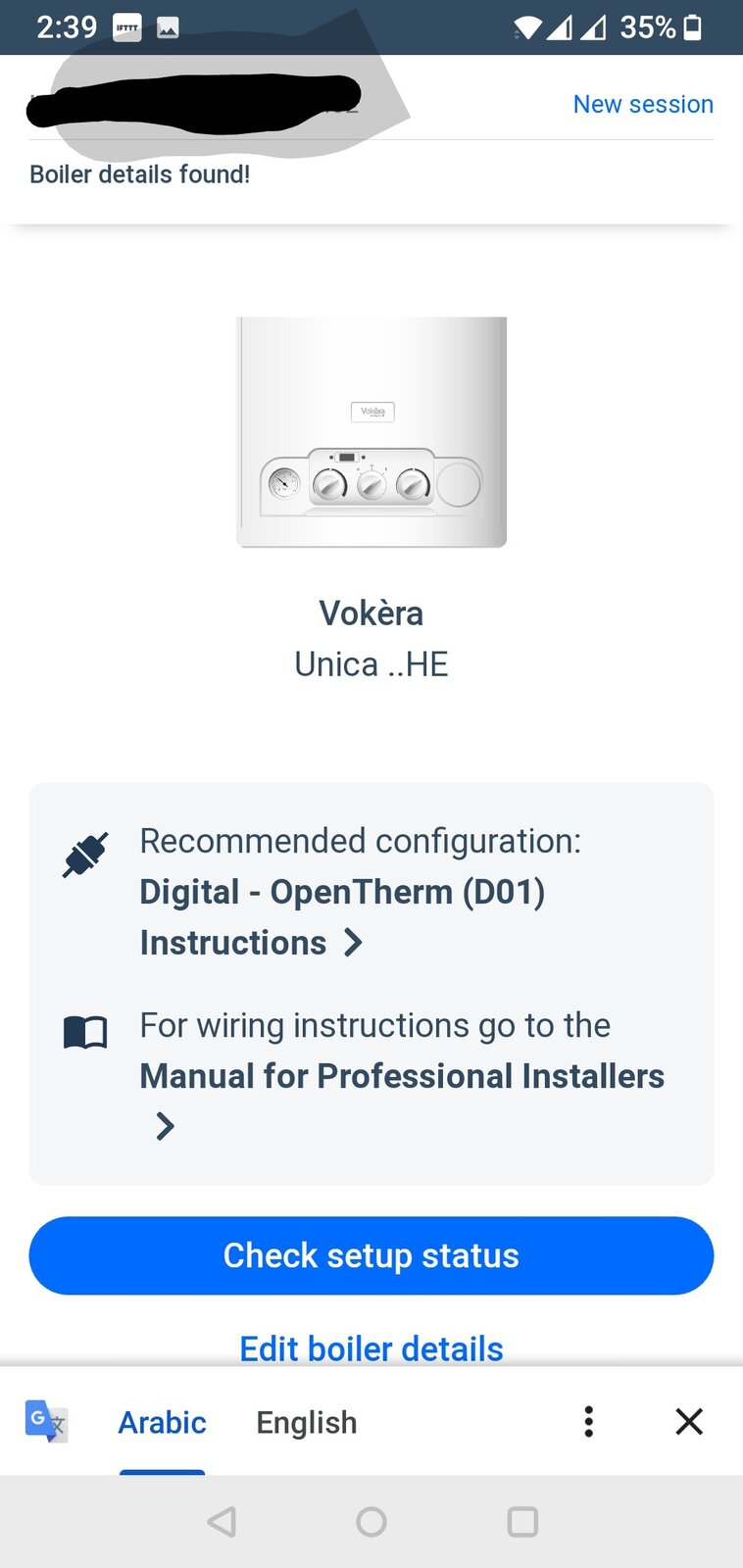

(Just to add, I had to add my boiler as the unica, my excel according to tado doesn't support opentherm so had to pick a boiler that tado thought did. Seems to work fine nonetheless)

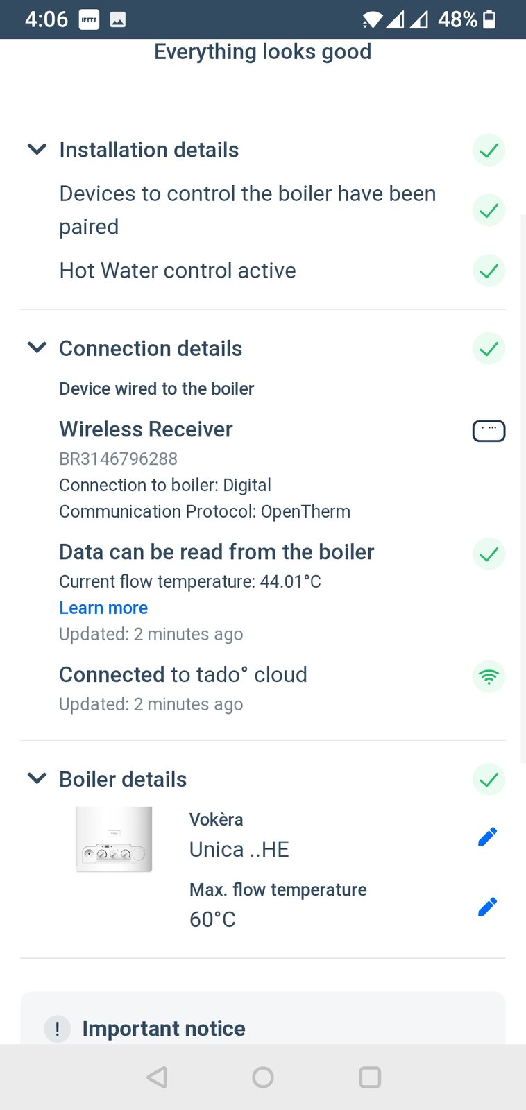

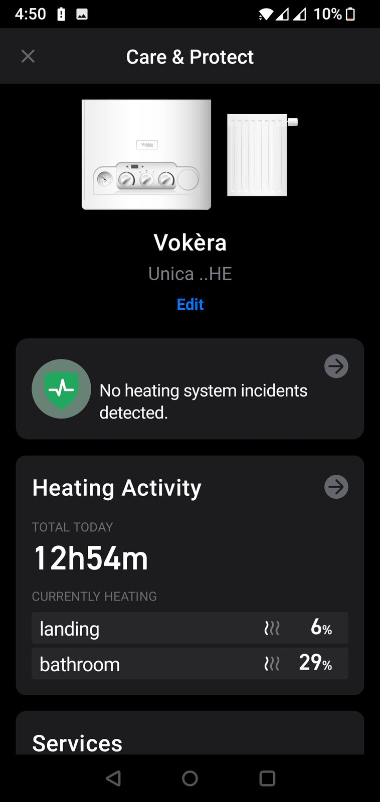

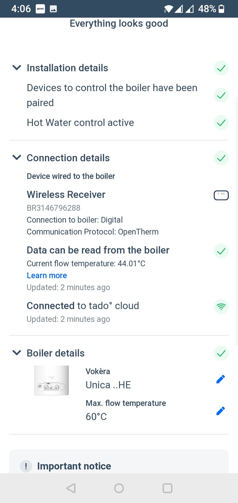

Main boiler model and setup page, all that is adjustable is the max flow temp.
Also it gives the current flow temp

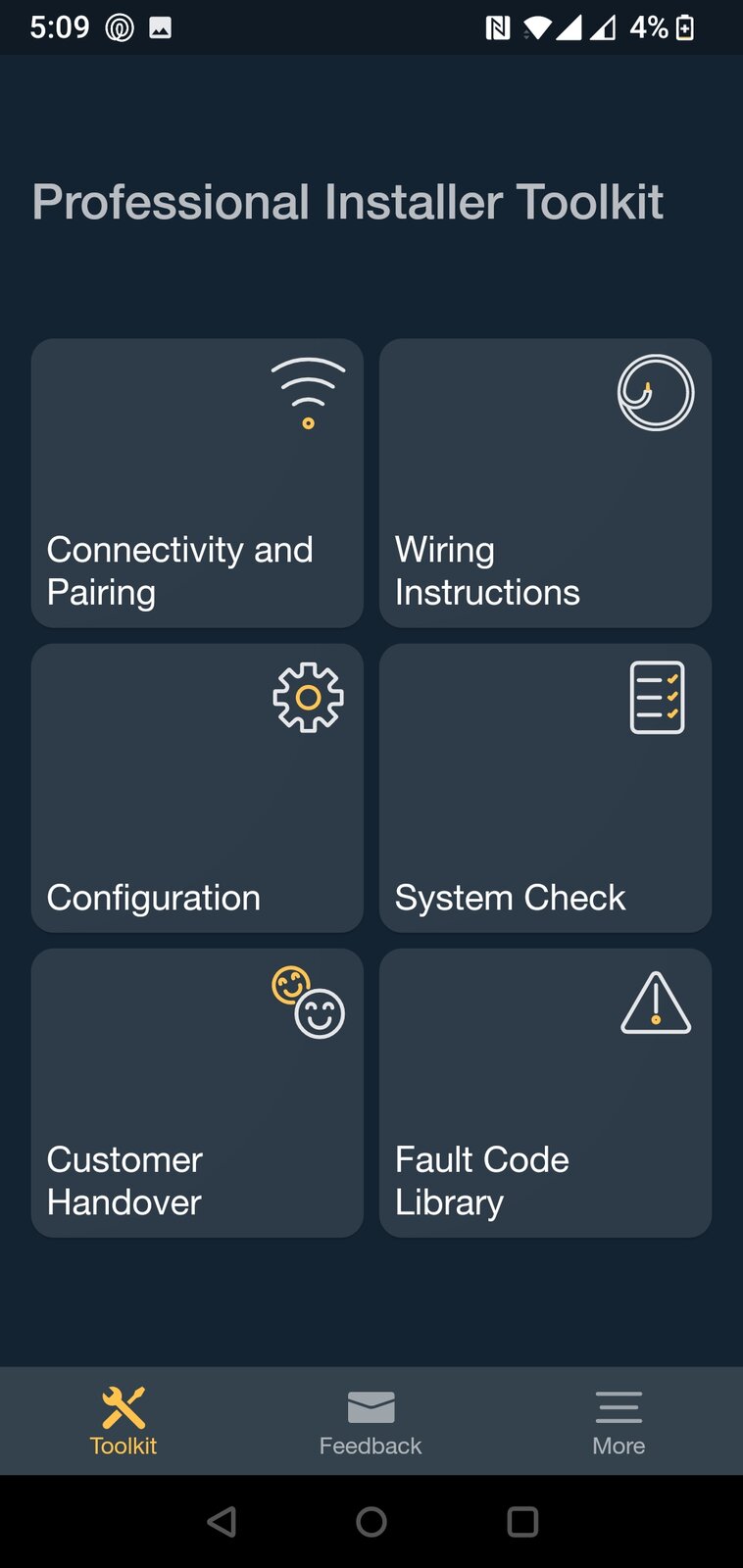

The setup info provided for the unica,this is all via the tado installers app, not the main app.

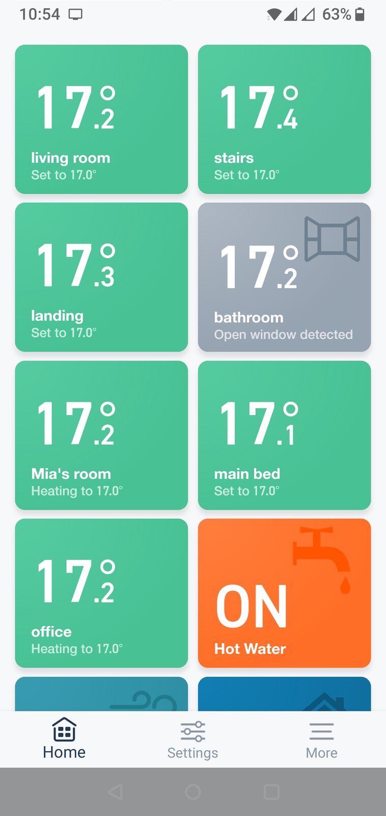

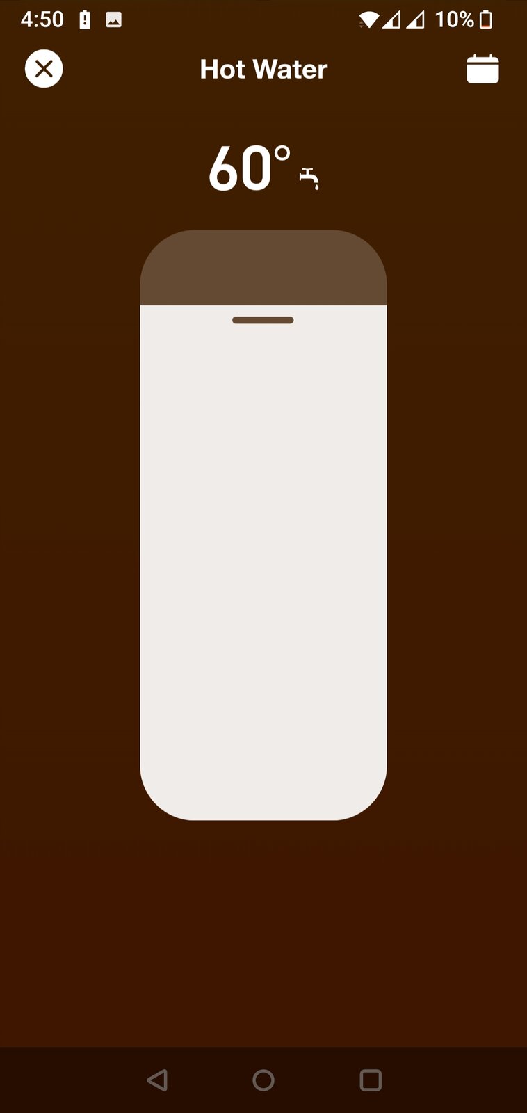

Hot water control temp is done via the main app, with a combi boiler you set the schedule to 24/7. There's some talk of the viessman boilers pre heat for hot water being on all the time, tado is unable to turn this to eco. Must be done via a viessman tech at boiler.

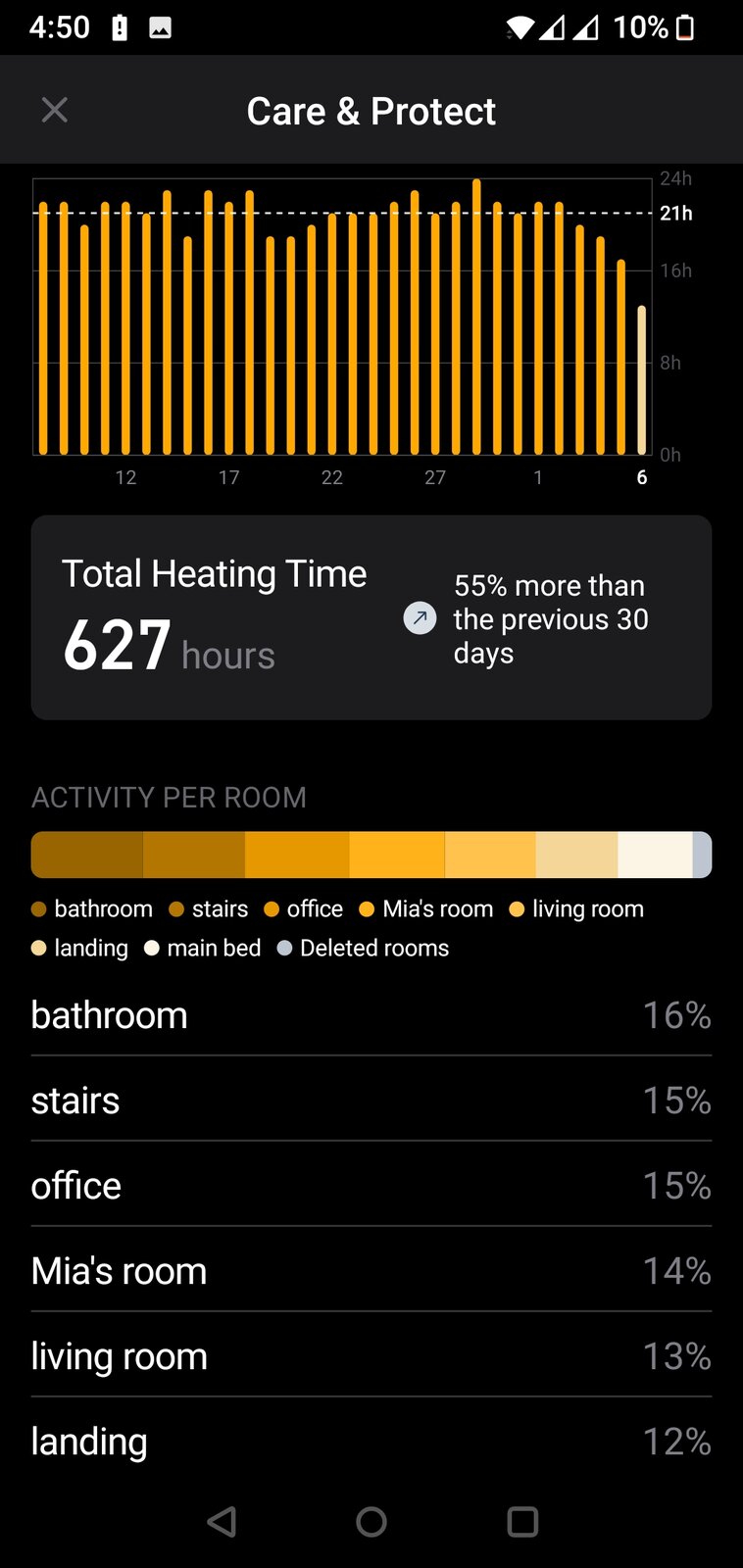

The only thing tado will show via opentherm is flow temperature, no modulation, no nothing from the boiler.
Heating time and load via the main app is " generic"

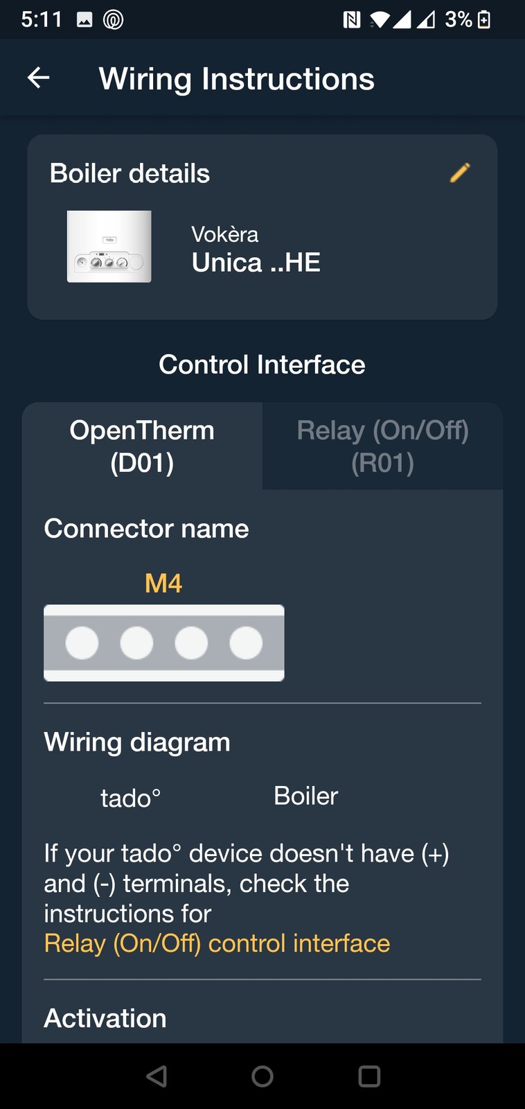

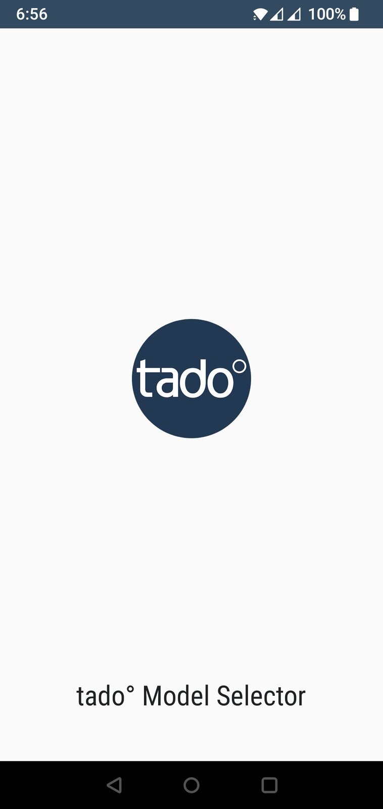

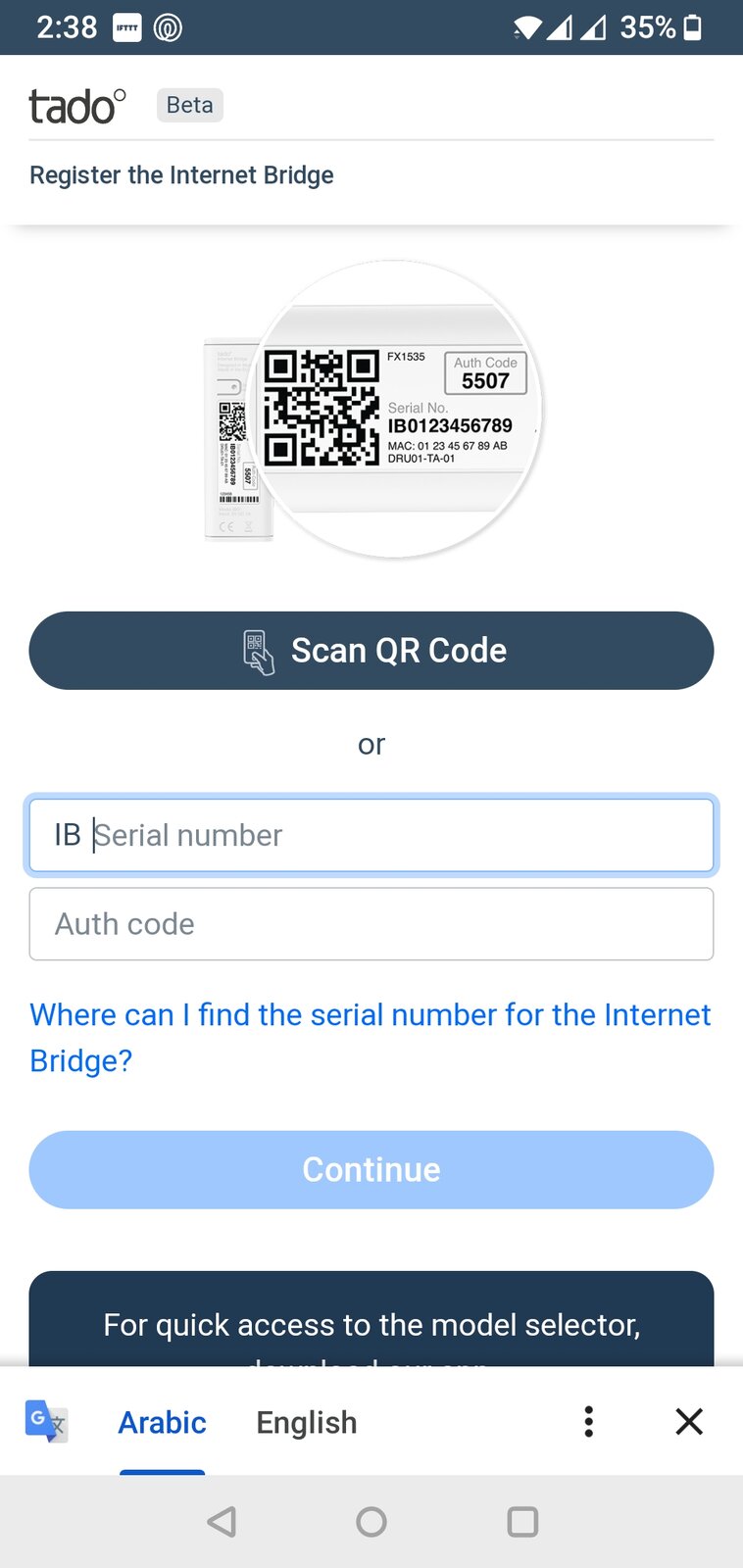

The actual setup is rather complicated, and spread across 3 apps, the main tado app, then for opentherm the installers app that then takes you to the "tado model selector" app.

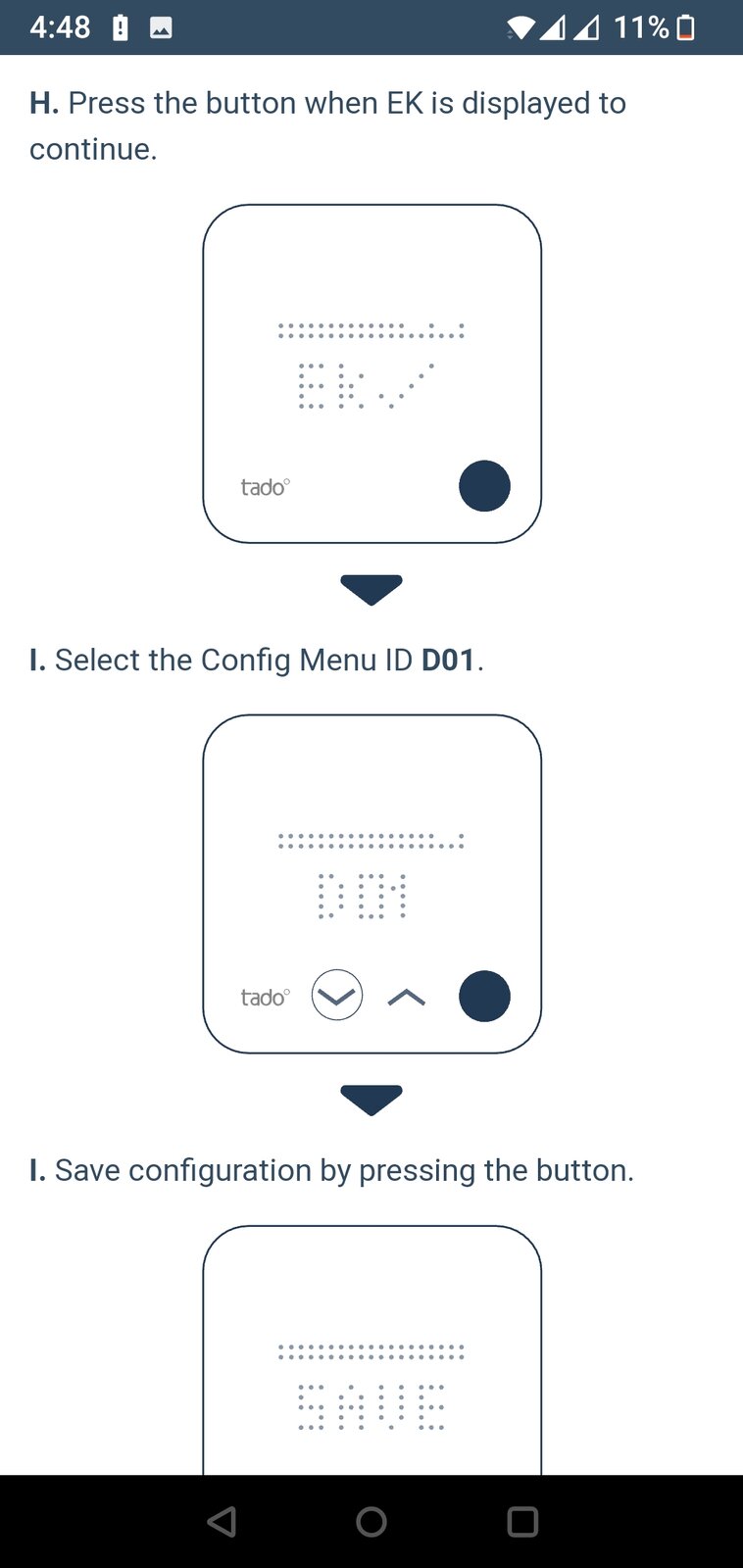

There's additional setup needed at the wireless thermostat, this can be found on the installers app.
