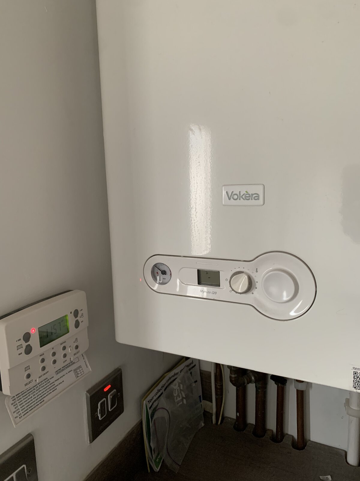

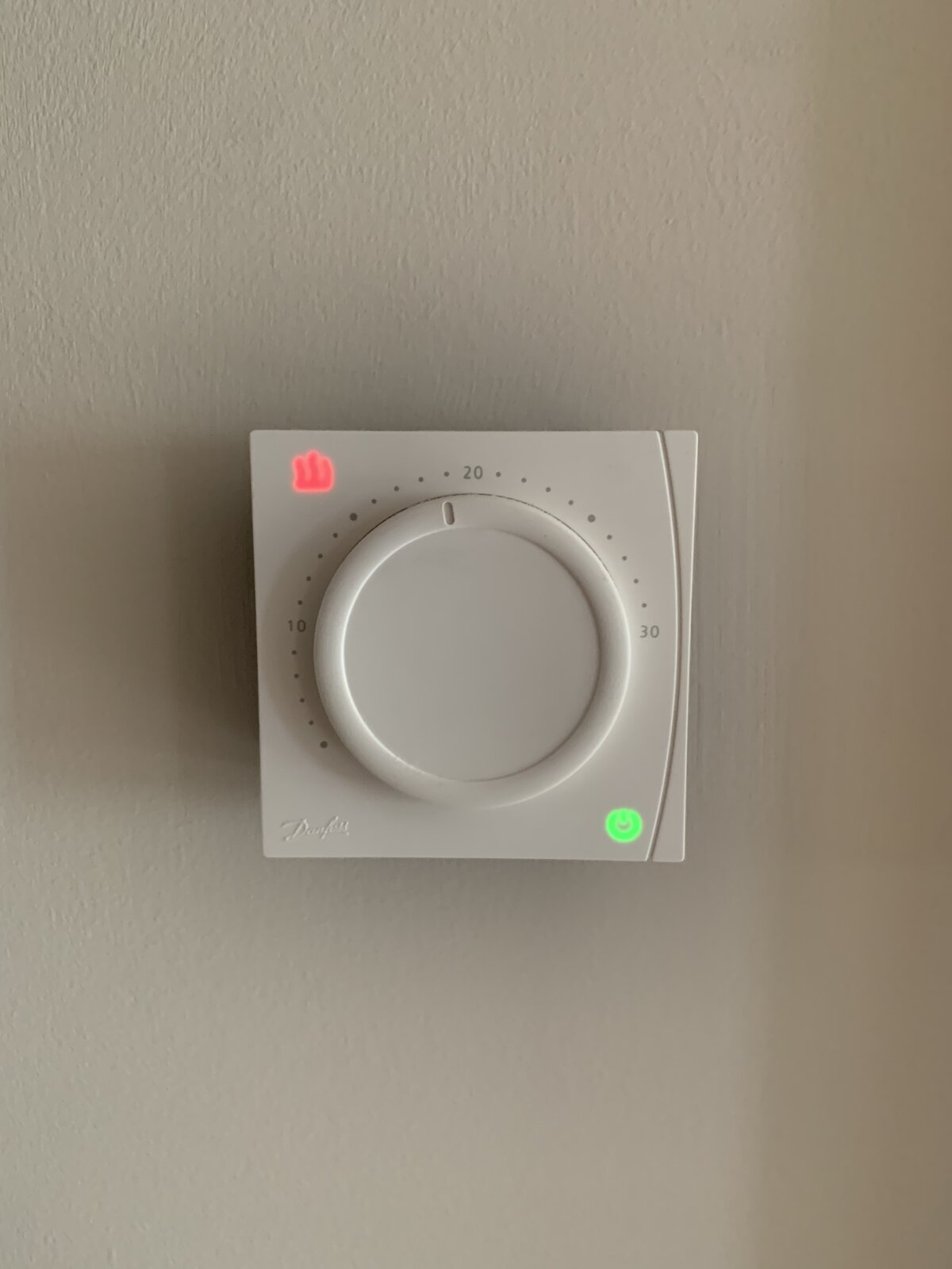

Hoping someone familiar with Vokera controls and boilers can help. I have a Vokera Mynute i20 gas boiler and recently noticed that some of the time the room thermostat is calling for heat but the boiler doesn't come on. It doesn't happen all the time just intermittently, any idea what the potential causes could be? At first I thought it was something to do with it being relatively warm earlier in the month and the outdoor temperature sensor stopping the boiler from coming on but it's now much colder outside and I'm still seeing the same behaviour.
thermostat asking for heat…

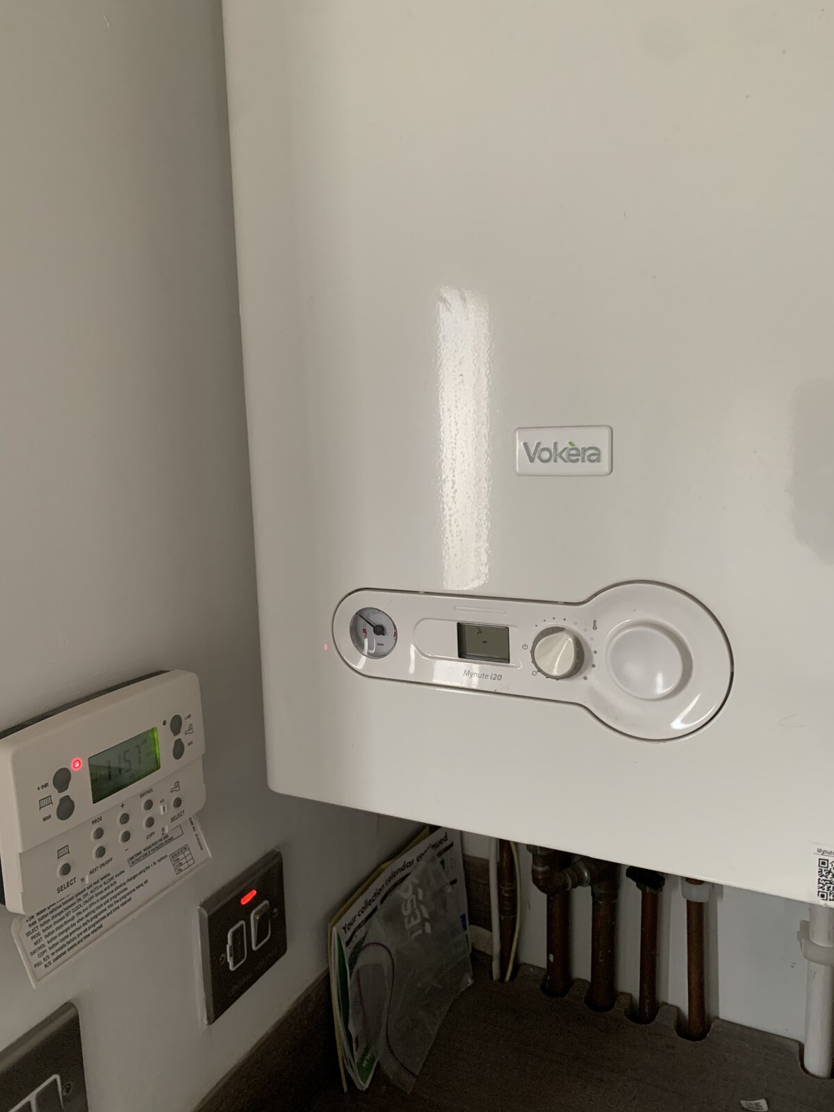

…but boiler stays off

Note that upstairs zone (controlled from a separate panel) is working fine.
So now it seems to come on when programmed some but not all of the time, switching it on and off a few times on the programmer usually works, programmer fault? Connectivity fault to thermostat?
If the boiler is working some of the time it sounds like a controls issue and if one zone brings it on and another doesn't I'd start looking at the motorised valve controlling the zone concerned.
It wil be that Danfoss thermostat, have changed many for that exact fault, you can actually buy the same thermostat and just un-clip the old one and clip the new one on , no wiring required , 2 min job, but make sure you turn the power off first

Thanks Ian, did exactly that and now it's working fine.
