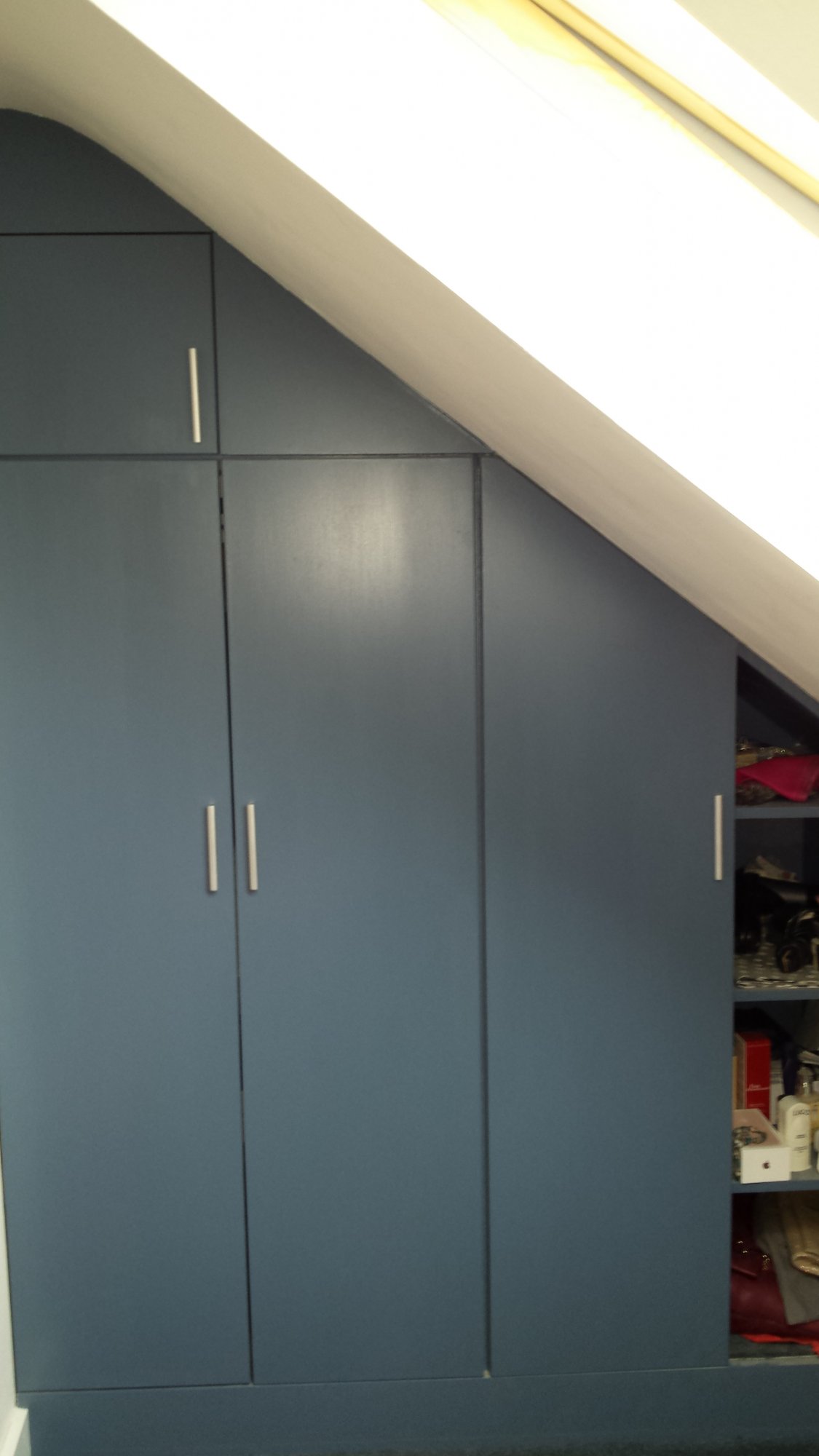

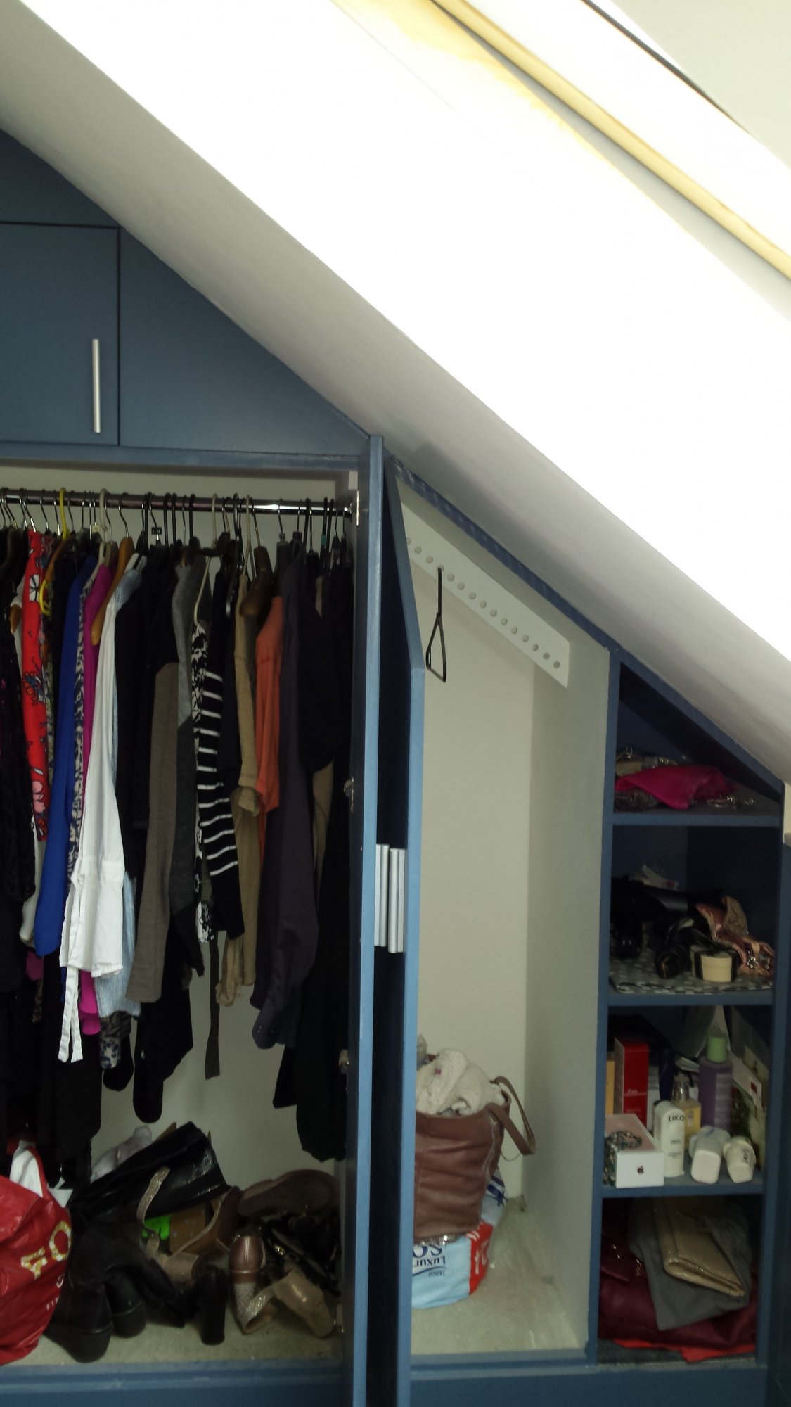

i just done some for a neighbour with melomine then vinyl wrapped them
ignore small door its a draw just waiting for runners to turn up
Nice job.

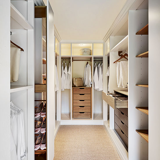

The one ive been asked to build is more like this:
so theres no doors, the screws that will be on show will be inside the units to fix each unit to the next and to fix to back wall.

if you have a plinth and a pelmit i would fix to floor and ceiling then use plinth pelmet to hide fixings as for joining i would use the joining bolts plastic ones as you can get them them in what ever colour you want

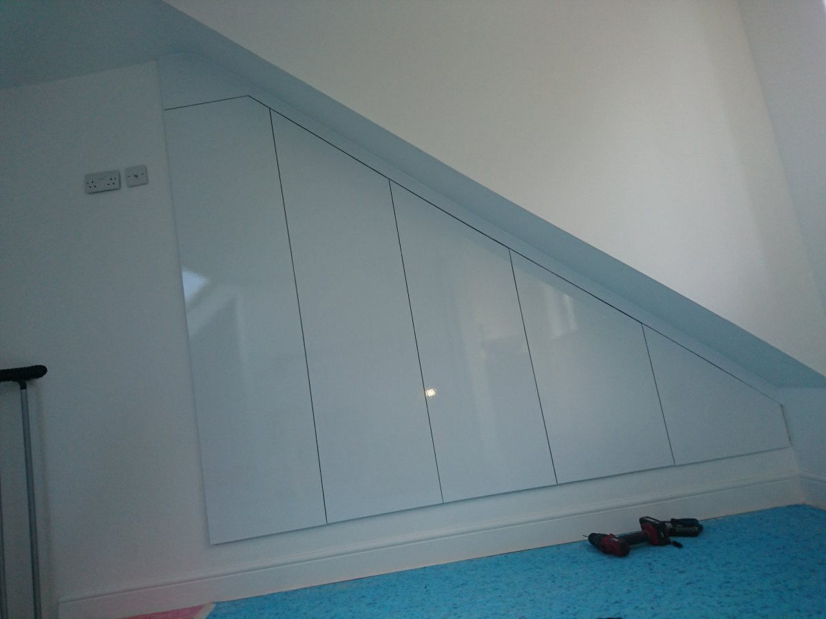

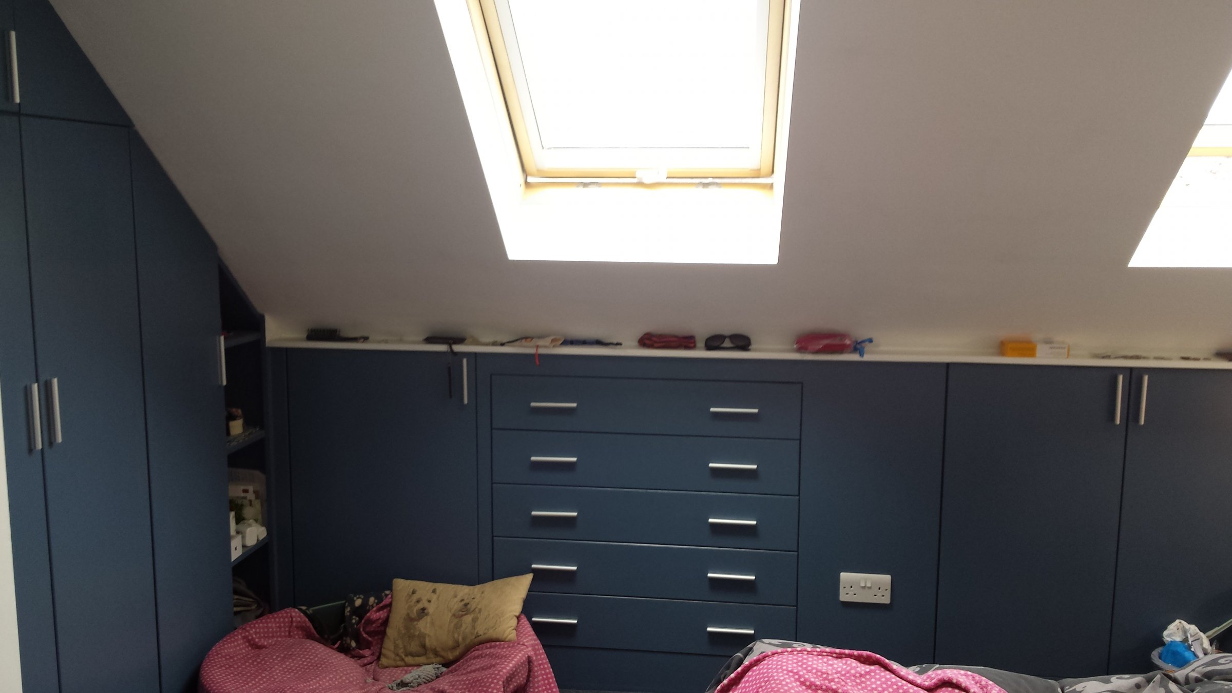

Not sure if you do much fitted furniture, but if you don't it's easy to underestimate how long it takes I reckon just this little lot took me the best part of a week and cost about £400 in materials I reckon I would have quoted a client £1500.
On the construction front I would avoid screwing into the edges of chipboard and consider something along the lines of cam bolts, which are far more substantial, you could use blocks if the client is OK with that, but they will be visible.

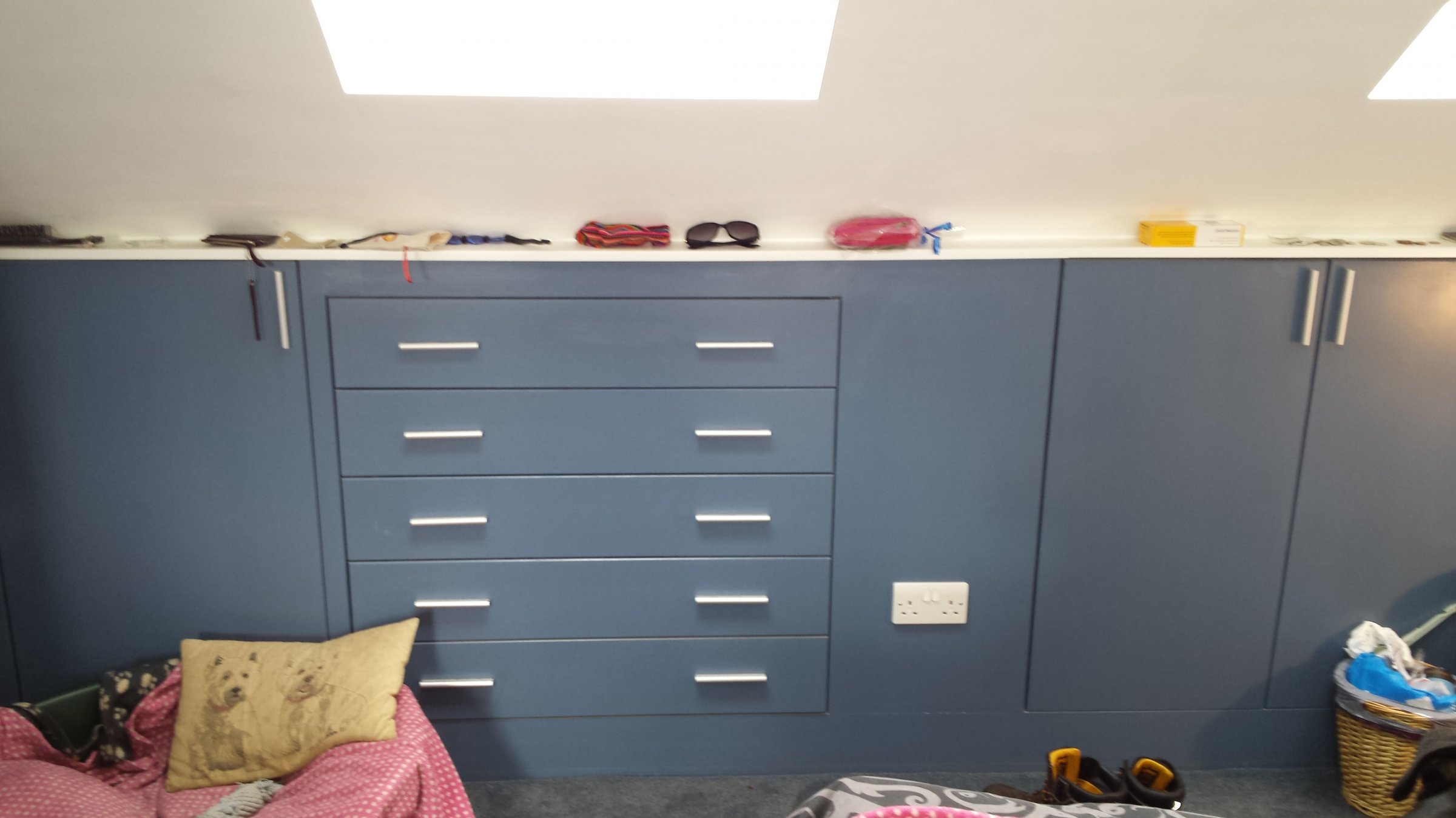

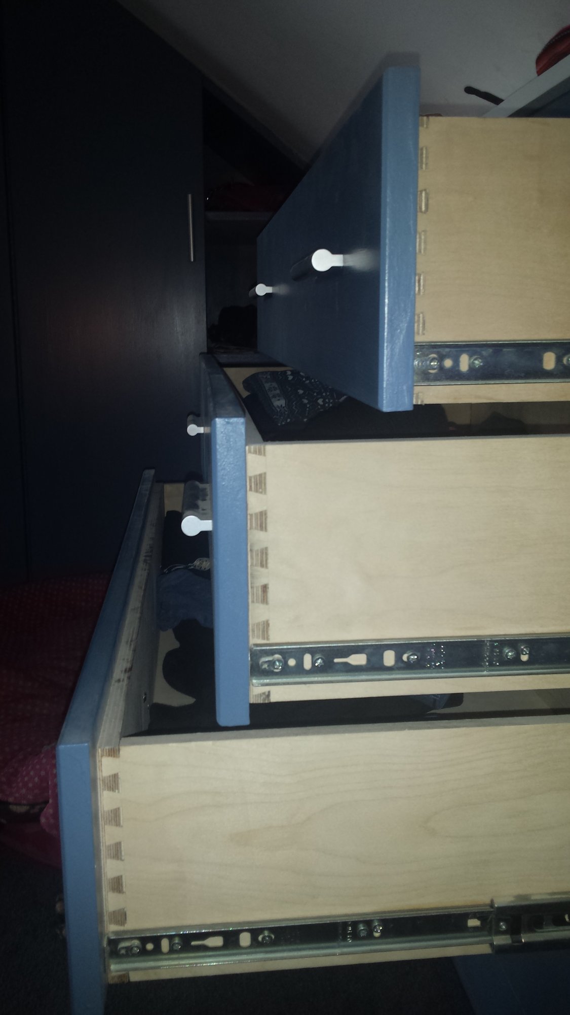

I prefer heavy duty double or treble extending runners to kitchen runners and like to make to dovetail draw boxes, makes them much stronger and adds a little something, kitchen draw packs are OK in kitchens, though you may be able to utilise drawer fronts.

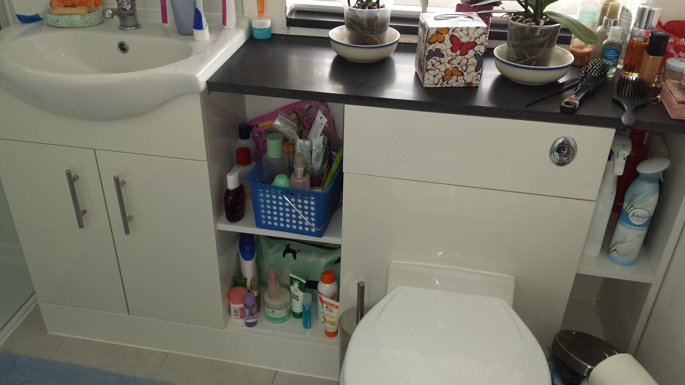

Not sure if sizes would work for you and it would add to costs, but could you utilise kitchen decorative panels, cupboard and drawer fronts etc as they will give a much better finish. the toilet unit and the shelves in the bathroom picture were built around the sink unit using decorative end panels and plinths from Howdens and cost about £80 all in against the £80 better bathrooms wanted for the toilet unit alone.
The real advantage is that all the panels and doors are foil wrapped, so no unsightly corners.
