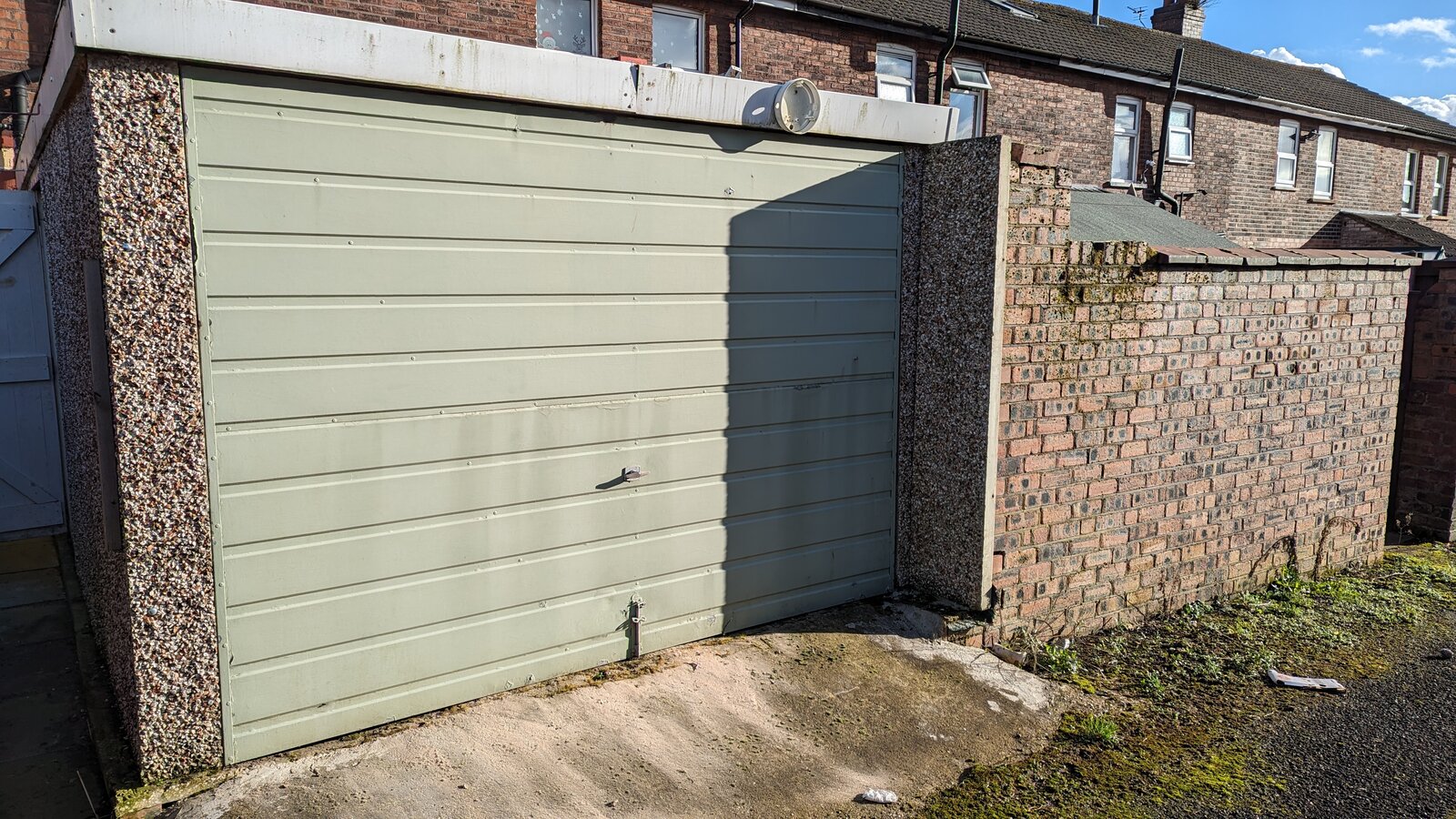

I've attached a photo as these things are easier to visualise then. Where the concrete ramp is I'm planning on removing that and the garage and building the wall up that was remaining under the ramp.

If you use English garden wall bond you don't need ties. The main reason for using Stretcher bond is that you get a good face both sides. As the length of stretchers can vary a bit, the back of the wall can look a bit rough. You can use an American bond, which is more like a header course every 7 or 9, and sort out the headers for these courses to improve the looks.
The wall next door is Flemish stretcher bond, which is a course of Flemish every 3,5, or7. Cutting down on the headers usually makes the back neater.
If the neighbour's original walls aren't all cracking and falling over then it should be fine.
Your neighbour's looks like Common Bond Flemish. You could match that. You won't need ties with this.
Although you'd probably need imperial sized bricks to align the courses. You'd need to measure the others to check.
Put an expansion joint in where they meet rather than toothing into it. Use a wall starter kit with debonding sleeves, so it stays aligned but is allowed to move longitudinally.
Ok thanks. I was thinking if i built mine into their wall it would act as an anchor point, I'm guessing that's not the case then?
Oh ok, so tieing my wall to there's with a starter kit is more for allowing movement as mine settles/dries rather than toothing in which I assume could cause trouble in future?
It probably was all one single wall originally. But this was when lime was used. Cement mortar is stronger but more brittle, you'll often see the result on old long walls - cracks in random places. The idea is to put a big neat crack in from day one. Your new wall will be built wet, the first thing it will want to do is shrink, and pull away from your neighbour's. You can't stop it, so allow it to.
A wall starter ties a new wall to an old one...
Debonding sleeves will lock the walls together but allow longitudinal movement...
Just random examples, check compatibility before ordering.
The idea is that the wall won't be able to move sideways (i.e. fall over), or up and down (i.e. sink), but will be able to pull away along its length if it wants to.
Fill the gap with a recessed foam strip, cover the foam with sealant.
