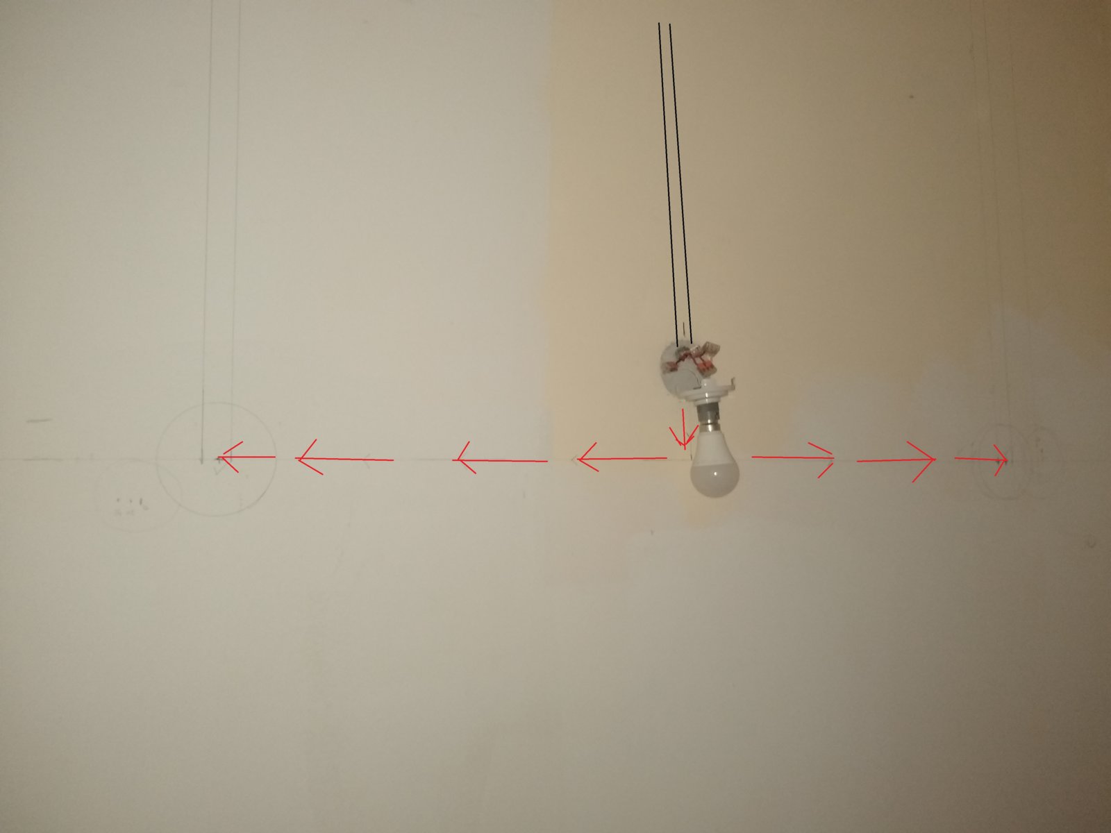

My wall currently has one light, however I would like two light fitting (i.e. one on either side of the wall)
I have concluded that the easiest method will be to chase down slightly below the existing light fitting
Then making a horizontal chase on both the left and right hand side of the masonry wall
I will drop the new wire in the exisiting vertical conduit before continuing in the areas i have chased
As the cable will go at 90 degree angles what conduit will i have to buy
For ease, I have attached a pic and markings (in red) where i would like to chase/feed the wire. The marking in black represents the location of the existing wire/conduit

@Taylortwocities apologies, i forgot to upload the image i was referring to in my original post
Yes there will be a light fitting at the ends of the horizonal chase. So there will be one light fitting on the left hand side and one on the right hand side of the wall
Yes, i will use oval pvc capping from toolstation
https://www.toolstation.com/pvc-oval-conduit/p31472?store=LH&utm
so when i go from the wire being in the vertical to horizontal position, I can just use the oval capping? If so, I assume that some of the wire will be outside of the oval capping i.e. encased in gypsum plaster?

As said the vertical wire will no longer be in a safe zone so you cannot do what you want.
The issue is that if you get rid of the existing fitting completely then the vertical drop will no longer be in a safe zone.
If the existing conduit is metal and properly earthed, then you could continue to the branch point with more correctly-fitted metal conduit, since cables in earthed metal conduit do not need to be in the safe zones.
If the existing conduit is plastic, or if it is some old ratty metal that can't be properly earthed then you will probablly need to either retain some sort of electical fitting in line with the vertical drop or run your cables by a different route.
Why not just fit a twin-arm wall light and some more appropriate bulbs ('lamps', whatever) in place of this slightly poor effort currently fitted? More light & no need to mess about chasing cables into non-safe zones.

Is mini trunking on the surface of the wall out of the question? Solves all of your problems with zones, chasing and plastering.
The wall on the left left hand side is a stud wall
Is it safe to feed the wire down the plasterboard (from the loft)
Then chase the wall horizontally for the oval conduit/wire?
Yes if the the left hand light is being mounted on the stud wall where you intend to drop the cable.

The chances of dropping a cable down a stud wall are 50/50. If there are horizontal noggins between the uprights then the answer is no.
If there are no noggins then I would be wondering why.
